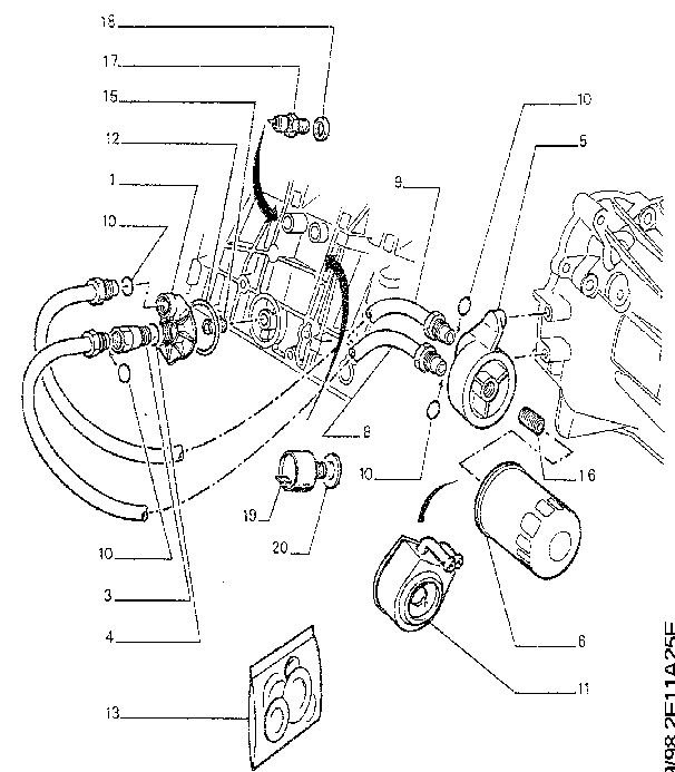

All standard. There are two types of 205 heat exchanger. Early type has a barb facing each way. Later type has the barbs facing the same way. Because the oil hoses are so old now, they burst and need replacing. I recently bought a new top radiator hose from here:

SRDT
The 205 is the only one with it, on the 309/405/BX it's not remote as there is more room in front.

Thanks Peter. Great help as always.
Would you know Where to buy the relocation kit and the exchanger? Here in Denmark I’m stuck with the normal air/oil cooler.
Put an add on AussieFrogs. There’s still plenty around.
