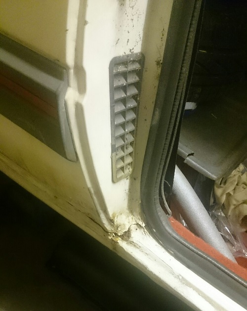

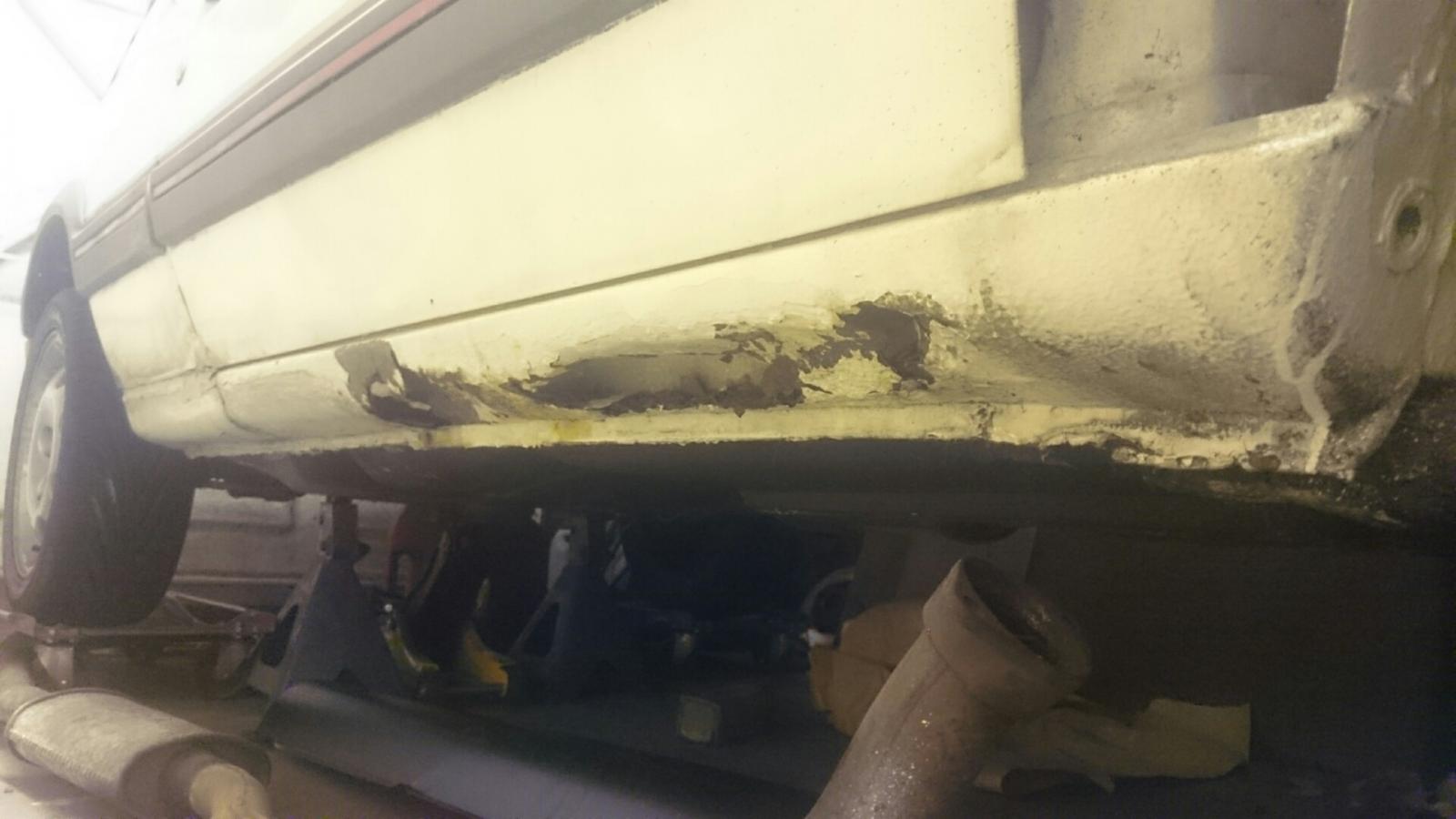

ak35 1 Posted April 13, 2016 (edited) I'm just about to replace the offside sill on my '89 gti and wondered if someone could give me a good close up photo of where the sill meets the B post at the lower rear corner of the door opening as mine has been bodged beyond recognition and I need to know what it looks like. (The other side is not much better. Thanks Edited April 13, 2016 by ak35 Share this post Link to post Share on other sites
Telf 222 2 Cars Posted April 13, 2016 (edited) hi there, Have you considered just repairing it- tbh I've seen worse - might be easier to repair it? Is it rotten behind the rear passenger trim? take it out and have a look . Edited April 13, 2016 by Telf Share this post Link to post Share on other sites
ak35 1 Posted April 13, 2016 (edited) Thanks, the sill is being replaced because I can put my arm through it. The rear panel will be repaired, I just want to know how they join together, is the join blended smooth or is there an overlap or visible joint inside the door shut? Edited April 13, 2016 by ak35 Share this post Link to post Share on other sites
welshpug 1,619 Posted April 13, 2016 its just sat on top, spot welded. 1 Share this post Link to post Share on other sites

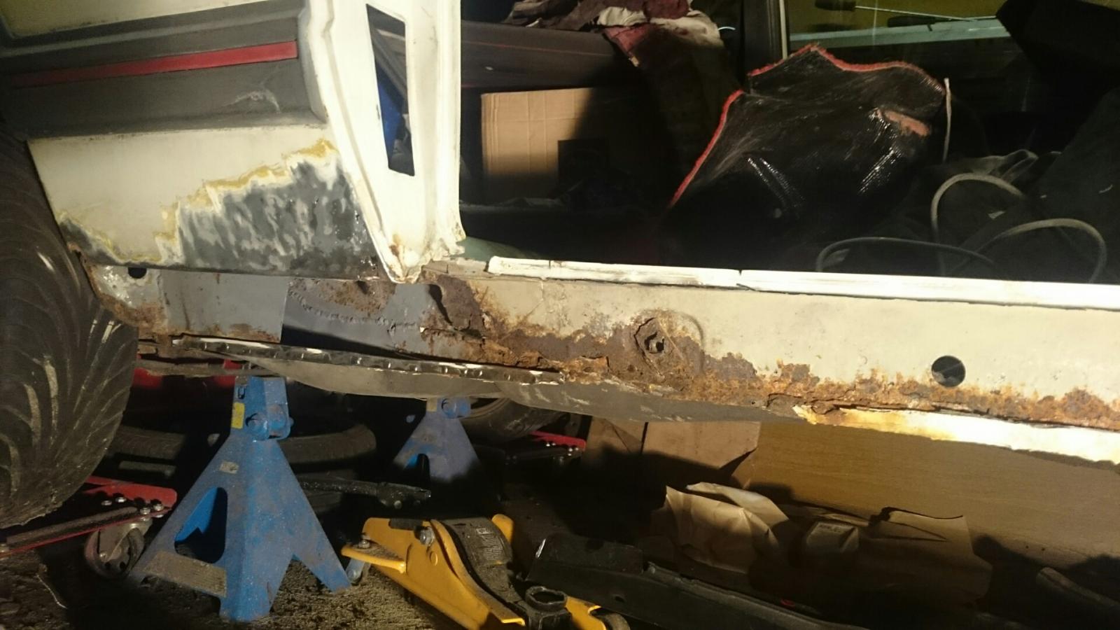

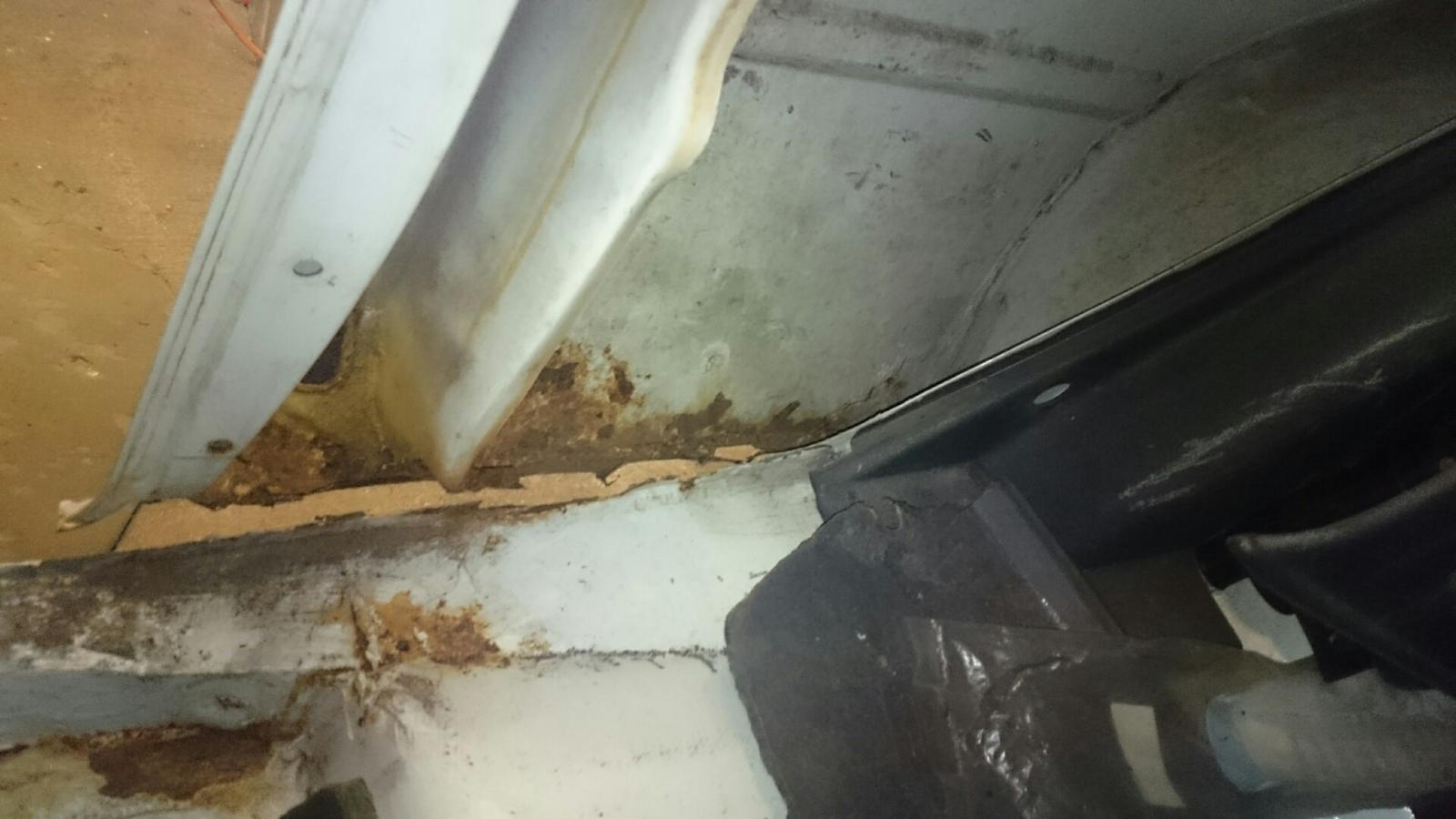

Miles 331 1 Cars Posted April 14, 2016 With the sill that bad I'd be temped to look behind the fuel tank as well and the middle inner sill section below the rear qtr panel, But the sills are dead easy to replace, just get cutting Share this post Link to post Share on other sites

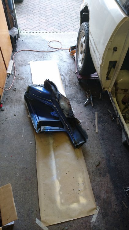

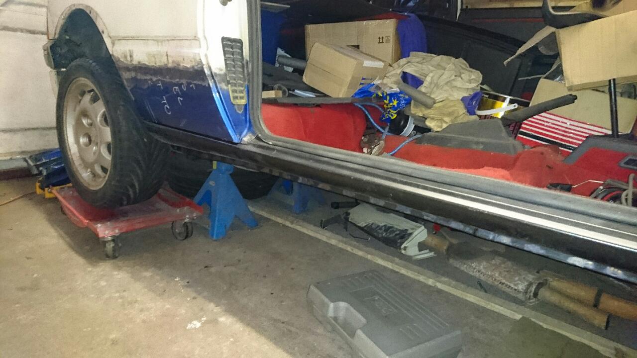

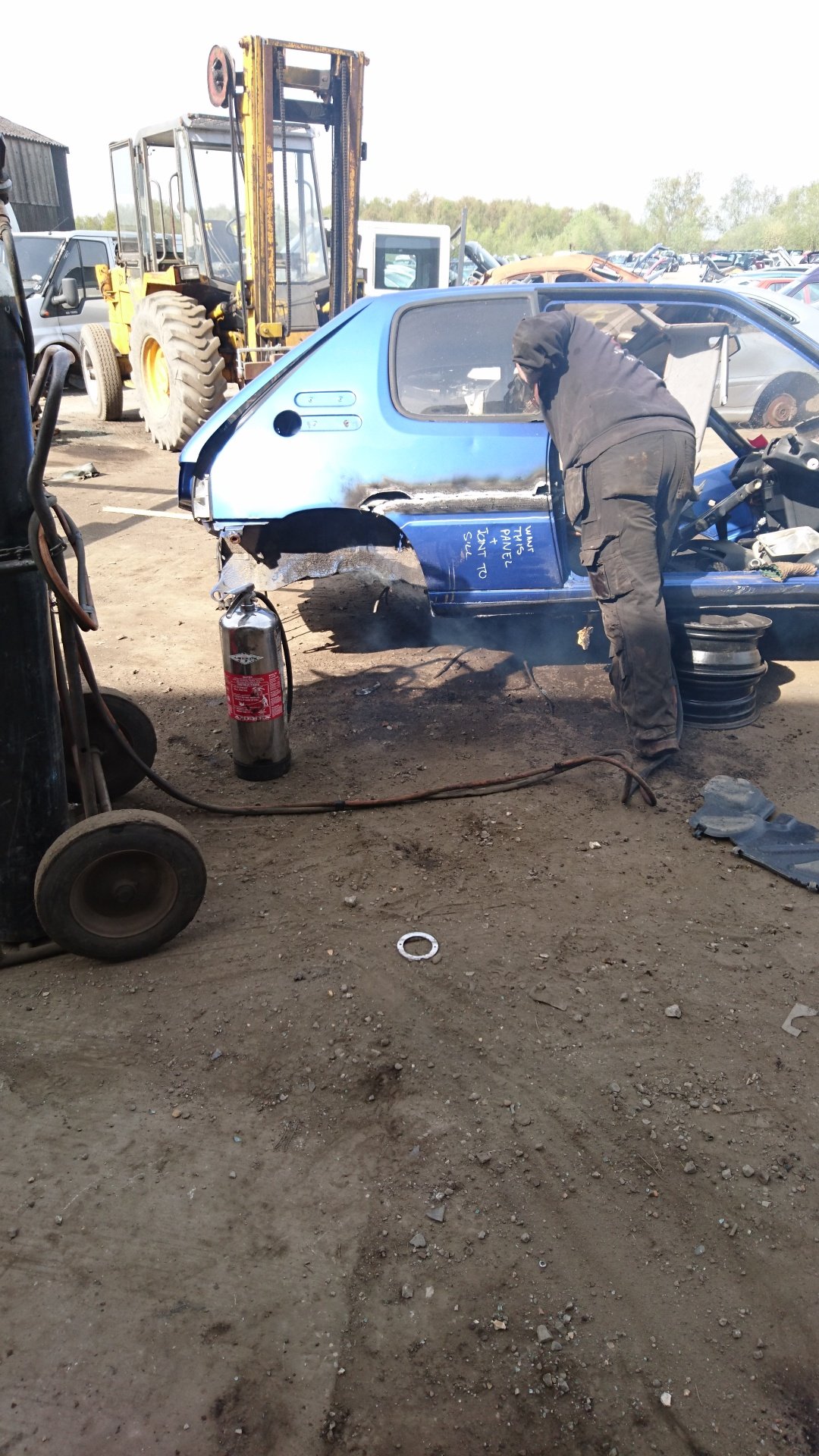

ak35 1 Posted May 24, 2016 Do you mean like this Miles? Unfortunately I'm not the first person in there. Share this post Link to post Share on other sites

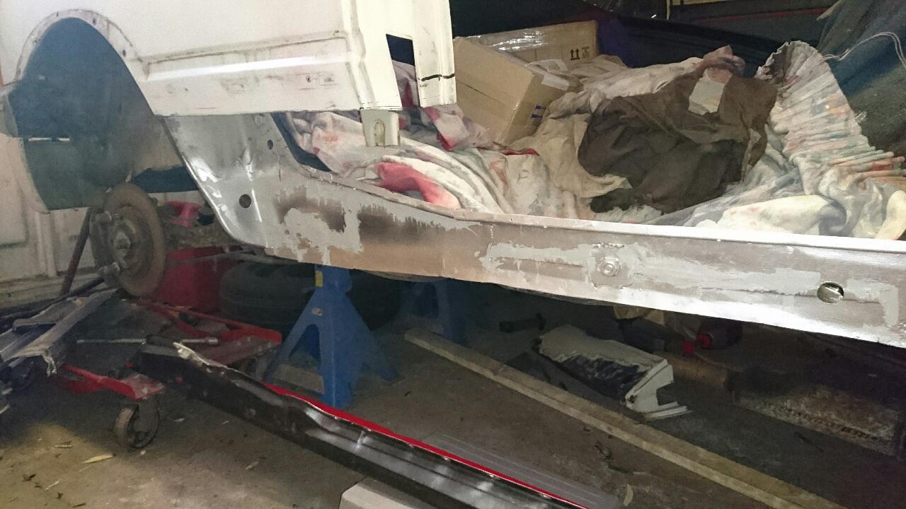

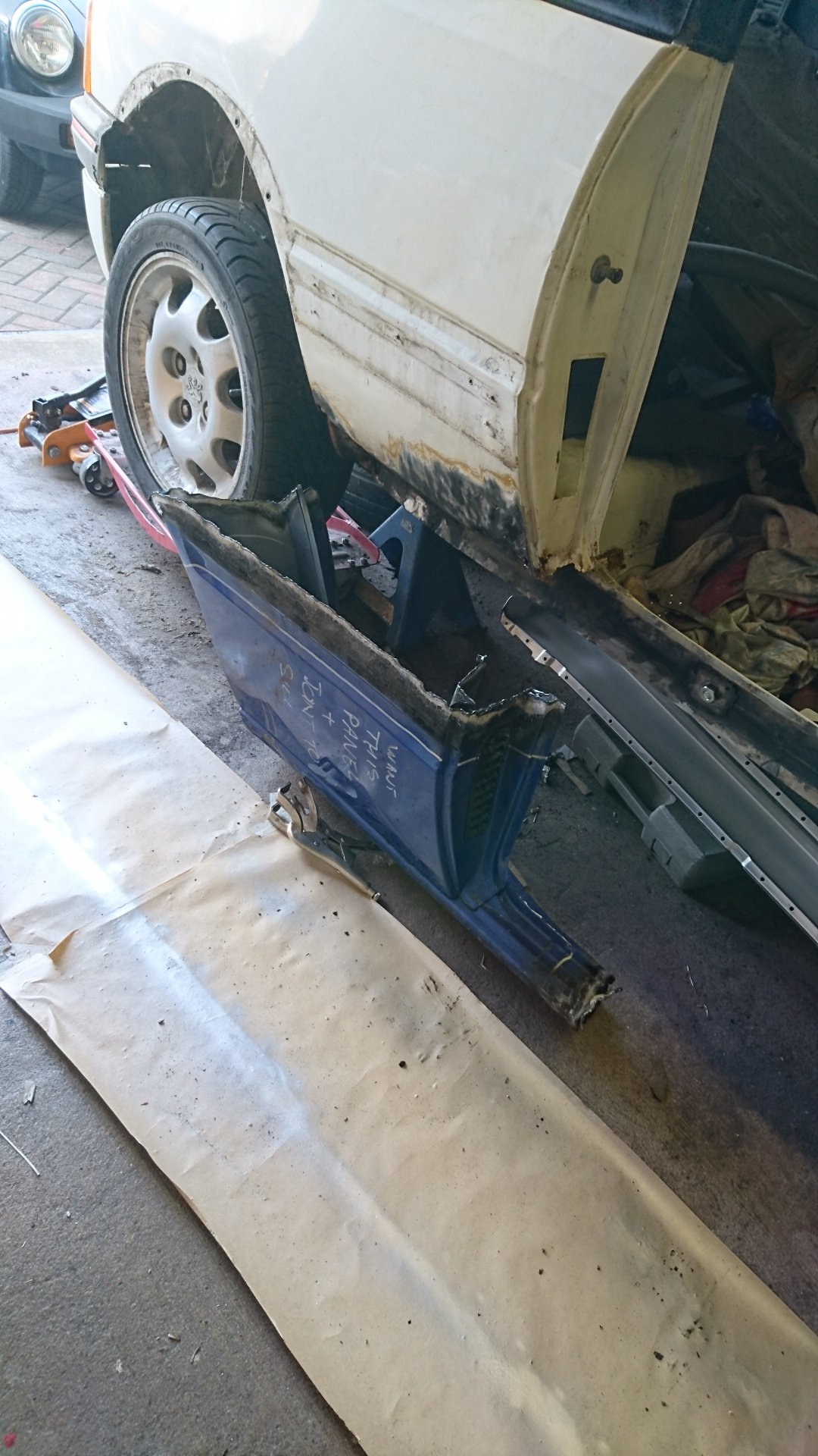

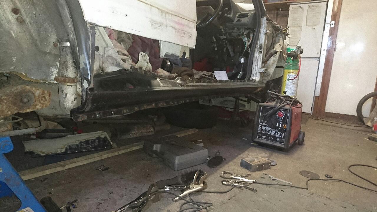

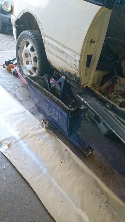

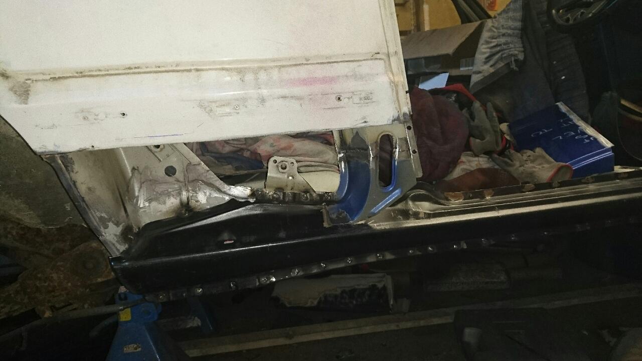

ak35 1 Posted May 24, 2016 All sorted now, needs sealer, filler and paint. (And then do the other side), Share this post Link to post Share on other sites
Philpooma 30 Posted September 25, 2018 Nice job, thanks for the extra images Andrew Share this post Link to post Share on other sites
