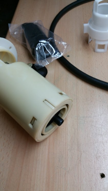

Problem 1: The first picture shows the housing. In order to take the old fuel pump out, there are some thick strong plastic taps on the sides, 4 in total. But I only have two hands and some screwdrivers. How I am supposed to depress all 4 tabs and slide the pump holder out with the pump inside of it?

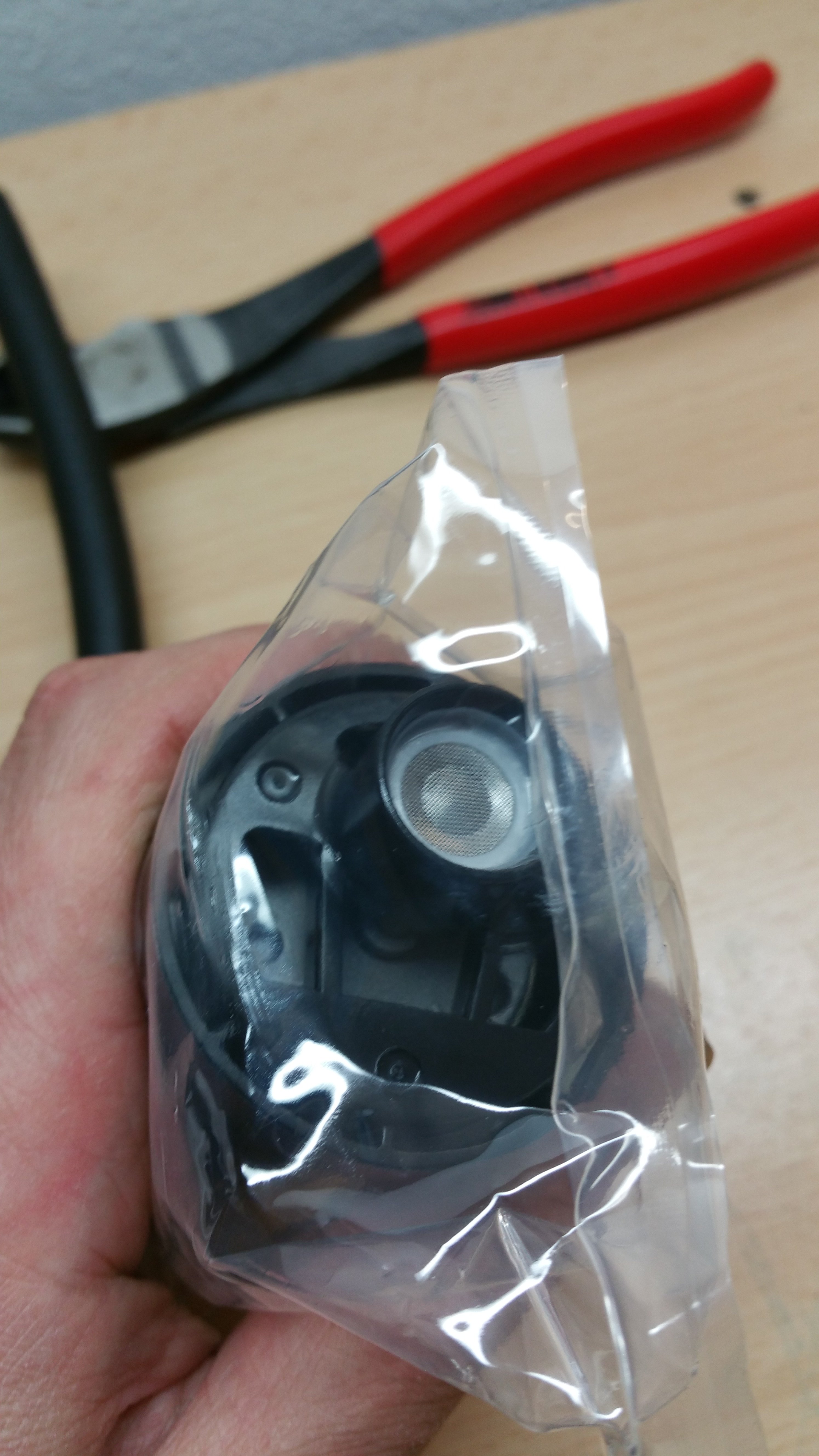

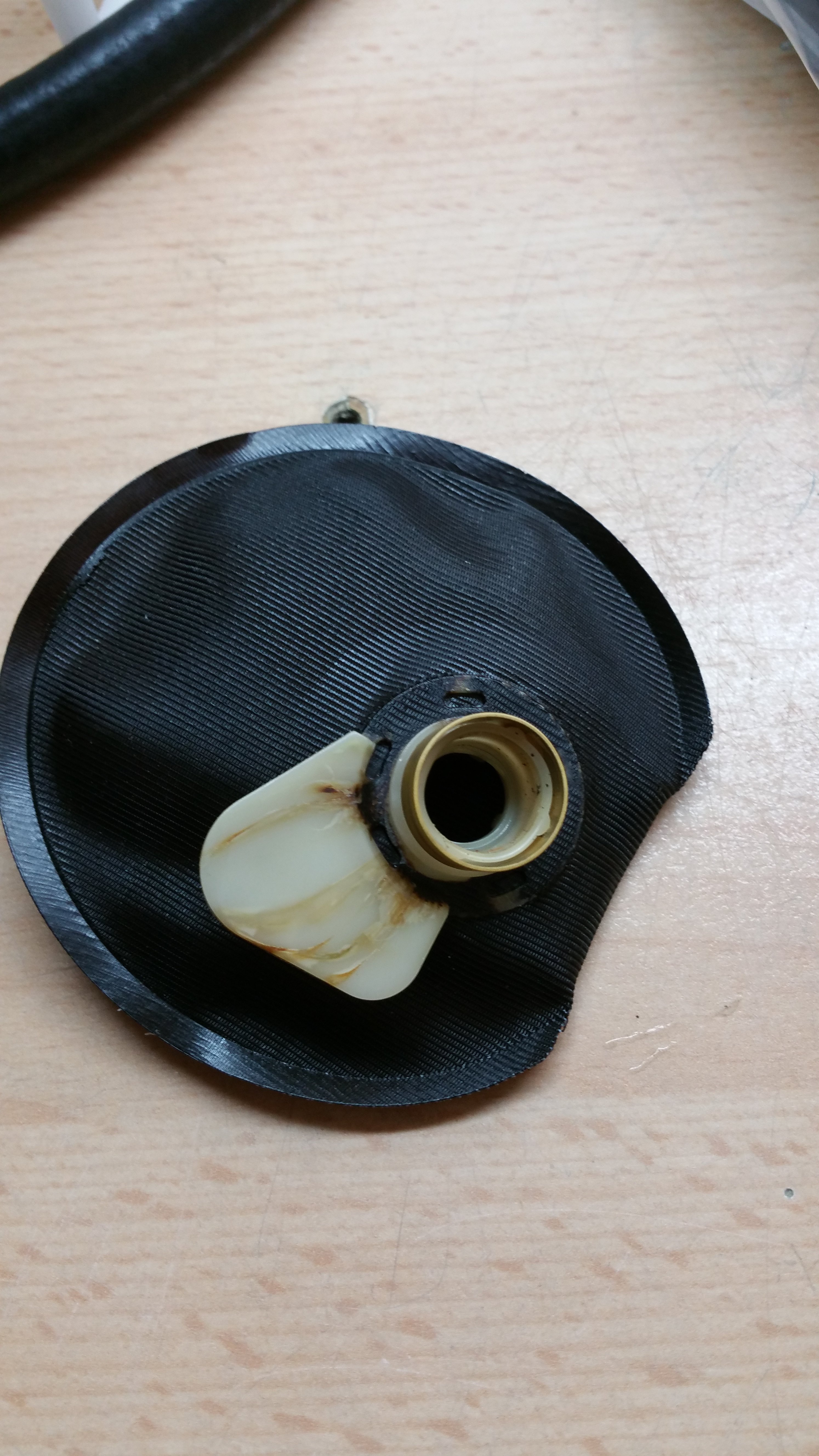

Problem 2: See pictures 2 and 3. I already figured out the filtering sock wouldn't fit the new fuel pump. The new fuel pump fuel intake has a larger diameter. My Peugeot dealer was not able to offer me this filtering sock. I can see it would directly attaches to the Bosch fuel pump 0 580 314 165. So there must be some alternative Peugeot car or maybe even an other manufacturer that has a part number for this sock that will attach to the fuel pump I currently have. I hope I can get some help on this, Really.
