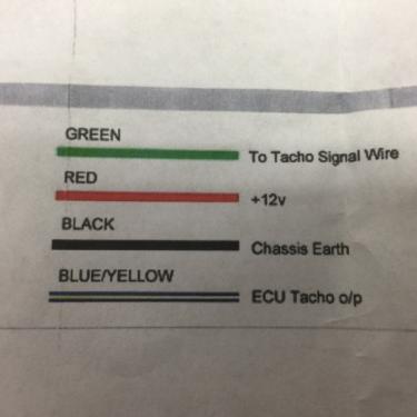

I've got Spoox tachometer driver part # MG031 for GTI6 engine that I swapped to my 405 Wagon but installation diagram is not too clear to me.
Can anyone clarify this for me?
Does green wire go to tachometer white wire?
Does Blue/Yellow wire go to output tachometer wire from ECU? Sounds like output wire needs to be cut and Blue/Yellow wire goes ECU output wire and other end of it to Green?
Edited by my3AWDgst
I would take that to mean that the blue/yellow wires goes to the ECU and the green wire goes to the tacho itself (so connect it to the original wire that went to the coil negative originally)

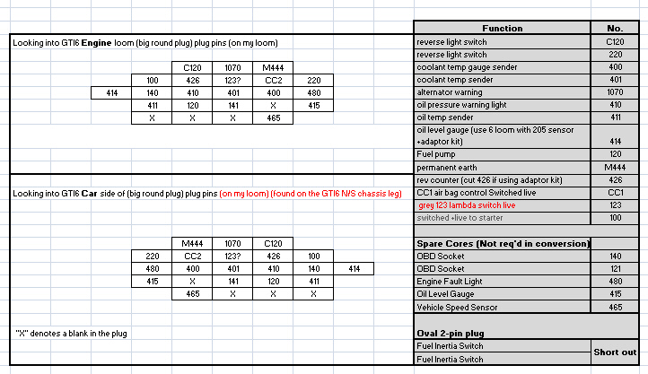

I got it finished and it works great I used wire 426 at 19pin multi plug to Blue/Yellow and Green to Green tachometer wire at MC3 connector pin A6.
I used used 12+ from CC2-123 and black ground to M444.
