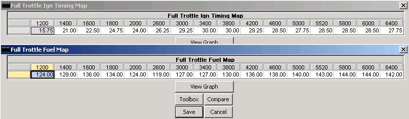

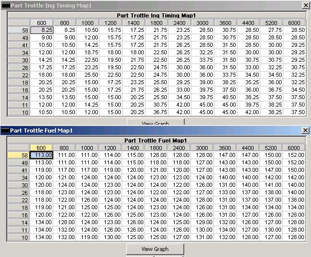

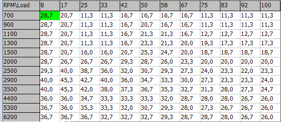

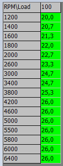

Timings are for 95 octane min.
3 separate tables.WOT,MOT - 0261200139 ML4.1.Iddle - motronic m1.3 0261200161.
Scales are - iddle - 0%(1X8),middle - 10-58%(12X12), wot - 100%(1X16).
Linear interpolation is your best friend.
Use on your own risk.

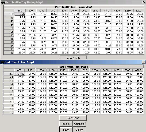

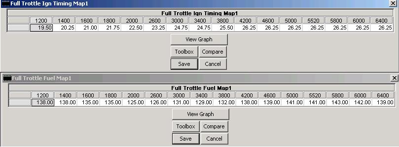

Are these tables reverse engineered or measured?
I must admit they're a little different to my data. The 161 has to be different to the 139, as the CR is 9.7:1 compared to 10.4:1.
