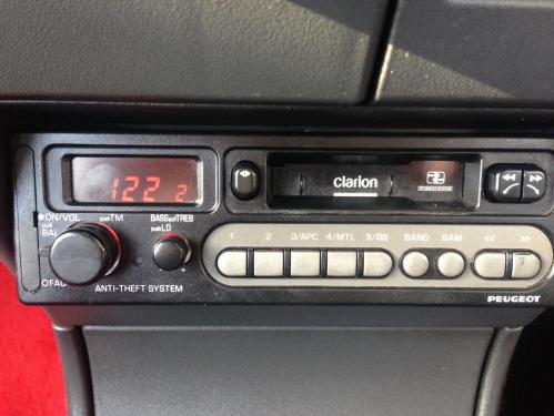

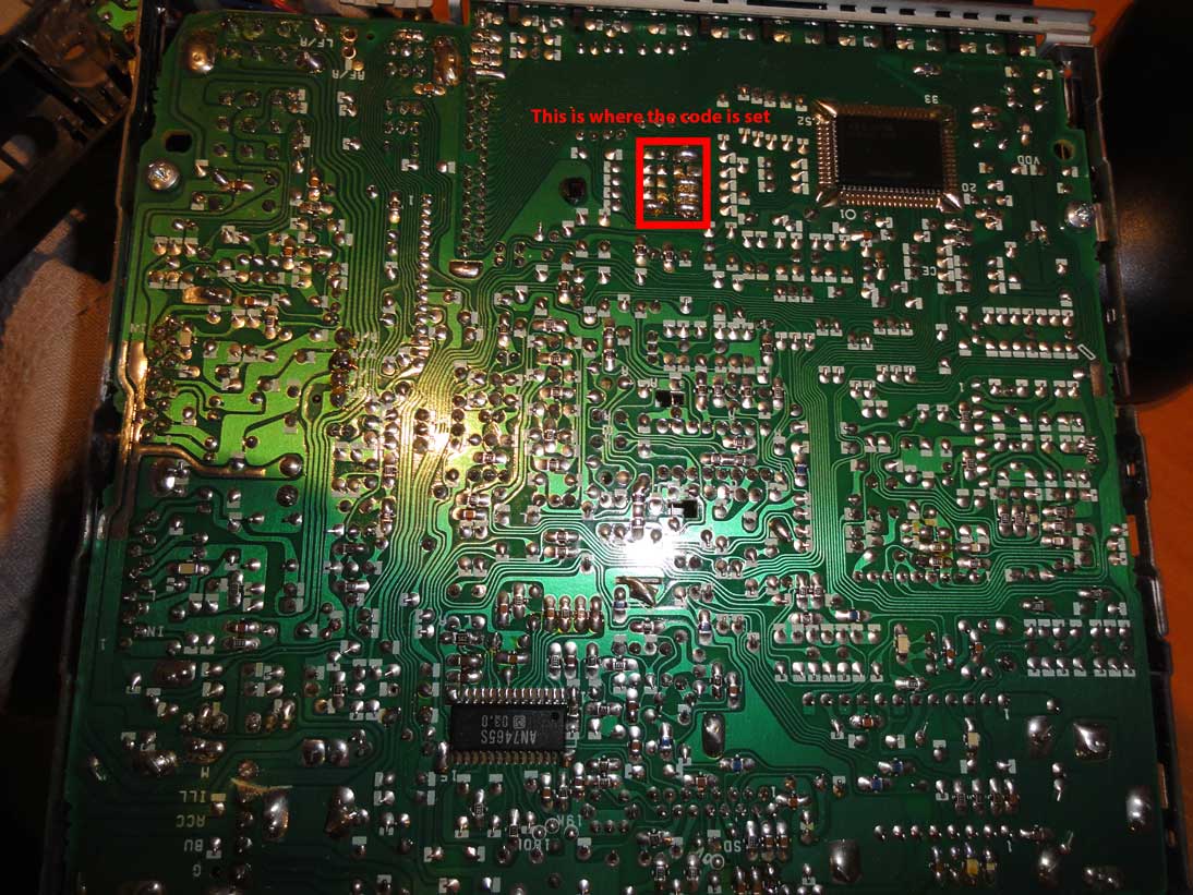

Telf 222 2 Cars Posted September 4, 2015 Hi all, I managed to get an old clarion for my 205 GR project from a 309 being scrapped. I don't have the code but I seem to remember it can be worked out from the soldering on the main PCB board- can anybody help me out or advise? Thanks Paul Share this post Link to post Share on other sites
Telf 222 2 Cars Posted September 4, 2015 (edited) its this type of radio! a 9700 Edited September 4, 2015 by Telf Share this post Link to post Share on other sites
Pugleyrich 37 1 Cars Posted September 4, 2015 http://forum.205gtidrivers.com/index.php?showtopic=163928 This should help - take a look at the link on that thread for more info Share this post Link to post Share on other sites
mrfirepro 127 1 Cars Posted September 4, 2015 I've looked at 5 or 6 since that thread but still can't figure out reading the solder joints. I re-coded all the solder link route and they all worked. good luck and remember to take some photos and post them up for future reference. 1 Share this post Link to post Share on other sites
Telf 222 2 Cars Posted September 5, 2015 Thanks guys. I've decided to go for the old try every combination - theres 625.... So it shouldn't take THAT long I got it for free so a couple of hours work sat with a brew seems fair pay off Cheers Paul Share this post Link to post Share on other sites
Telf 222 2 Cars Posted September 5, 2015 223 codes entered and it now works! only took an hour or so, about 1/3 of the way through the 14 sheets of codes I had! 1 Share this post Link to post Share on other sites

rhysmoore 0 Posted May 17, 2018 Hi Guys, my clarion recently stopped working and displayed this code. How do I go about trying these codes? Is there a particular way to input them? Share this post Link to post Share on other sites
Telf 222 2 Cars Posted May 17, 2018 I think you have to press the 'Band' button for up to 5 seconds after entering the code. Share this post Link to post Share on other sites
