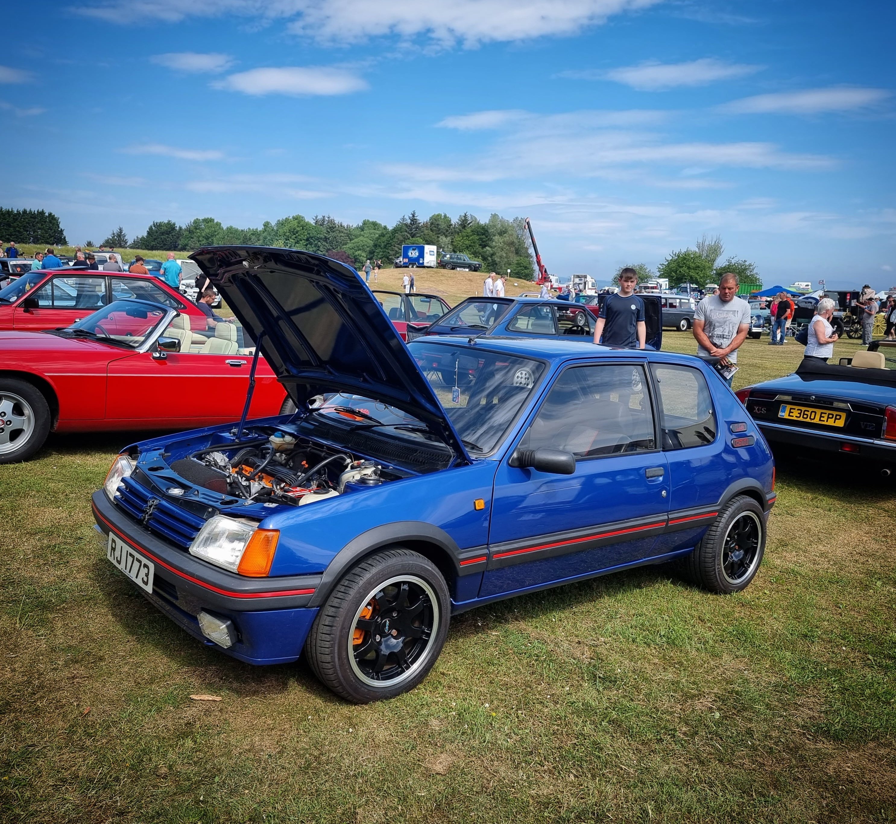

The project car is still going strong, I haven't used it much to be honest. Been on the work commute a few times and made its first car show earlier in the year
