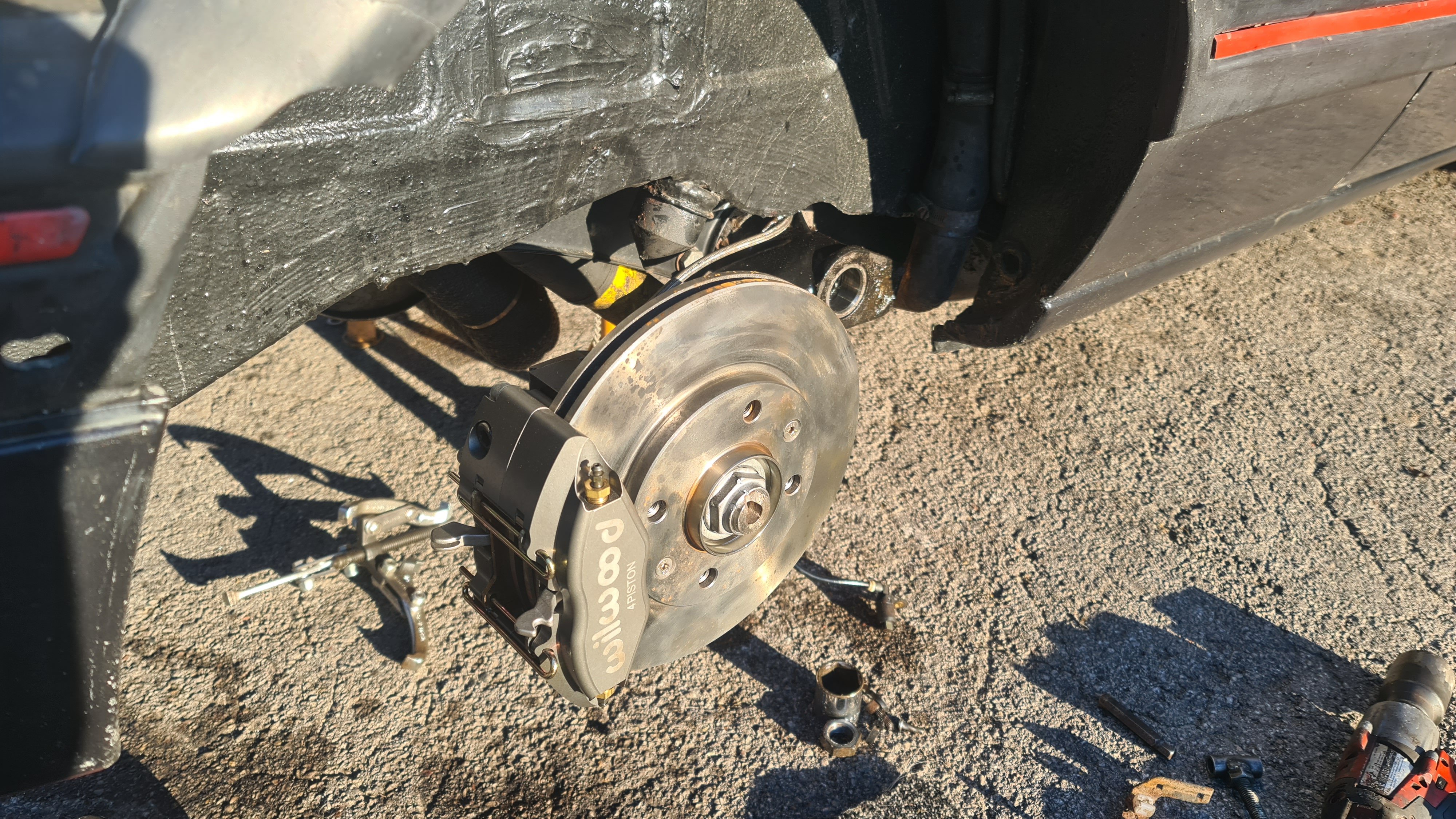

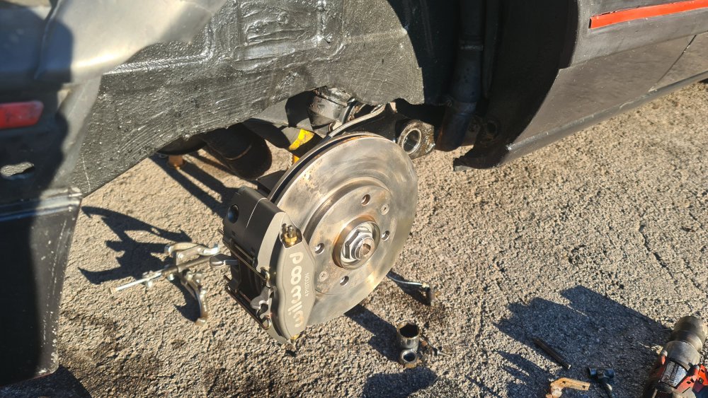

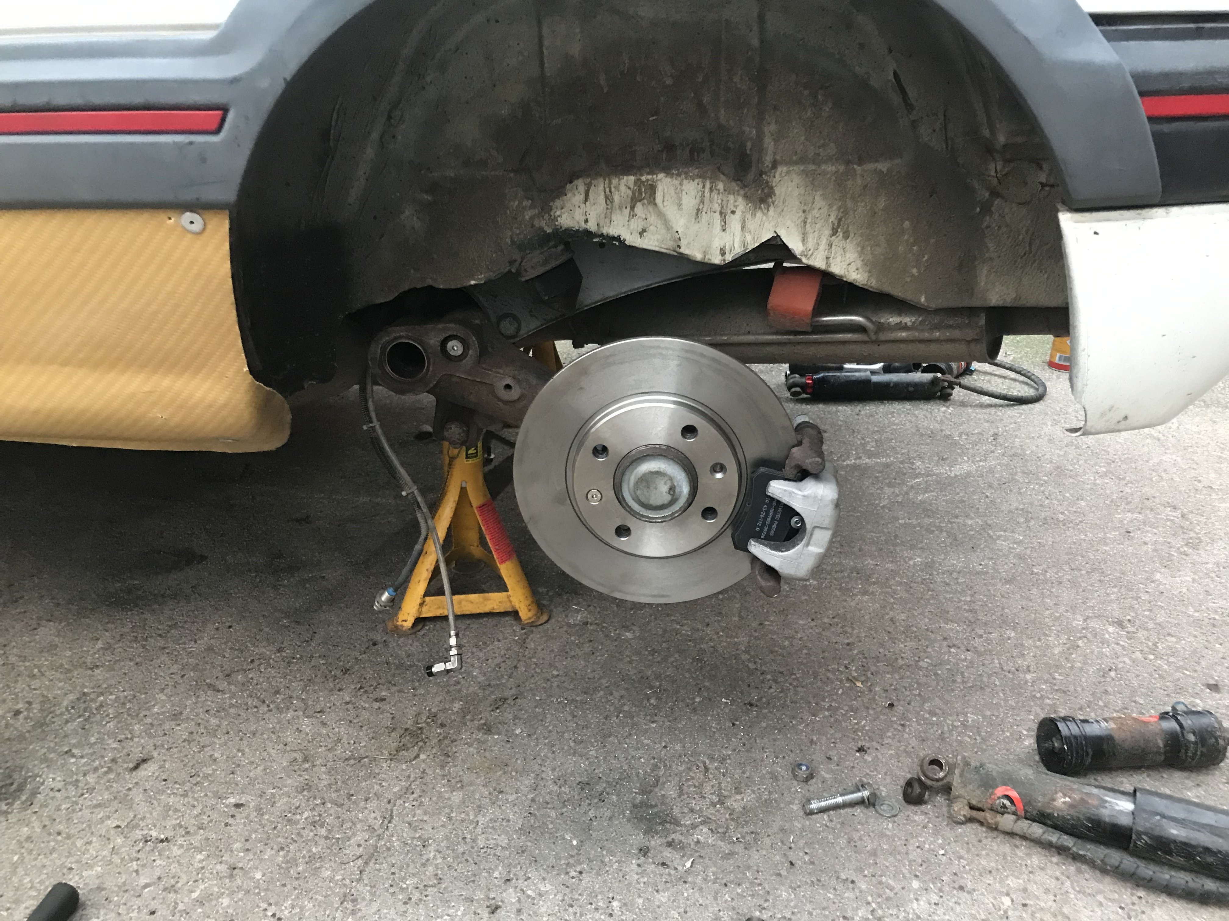

My brake hoses fit, 1.9 handbrake cables with a washer added fit!
Inner arch required a bit cutting out for clearance
But otherwise so far so good with the C4 rear caliper conversion.

To try and make the hydraulic handbrake work properly is the aim. Road rallying is a bit of an odd one in that we often run a gravel tyre which when hot are very sticky. On a dry night you just can’t get the bloody things to break loose to skid the rear of the car round, sometimes on tight triangles you are knackered without.
When I built this car I left it on drums as they seem more grabby as standard. My green road car will handbrake turn lovely! But the rally car wouldn’t entertain it, even with a hydraulic cylinder added inside the car.
Allan also had the same issues with the standard 1900 calipers when he was road rallying and no matter what he tried he couldn’t get to the bottom of it either on the standard calipers.
The other thing that lead me
here is that even with my in car bias valve fully open I can’t lock the drum
rears with the foot pedal either. My conclusion that the rear drums just aren’t powerful enough when up against a big sticky rally tyre.
Road rally regs mean I’ve got to have a facility for cables, and I’m not allowed an upright lever like I guess you have got.
As an aside I think PTS also struggled with this back in the day as they used an AP 2 pot on the rear, I’m assuming for similar reasons.
You can buy a similar modern 2 pot AP and they even do a very trick looking mech handbrake linkage for it but at £600 EACH the Yorkshire war cry ARRRR MUUUUUCCCHHHH! applies so as usual had a look to see what I could come up with.
So off to eBay etc I went and spent literally hours looking through at various different rear calipers at everything from a BMW MINI to a Merc ML. The late Citroen Peugeot caliper are used on loads of stuff and the same thing also
on lots of VAG stuff. But best of all Calvin donated a pair off Sarah’s scrap C4 with the intention of mocking up with, but to be honest with a clean and check they are plenty good enough to try out in anger so are now on the car and im
just finishing off the odds and ends so I can try them.
Piston size is 36mm so only 6mm bigger, but in area terms works out at something like 40% bigger than the 1.9 calipers. So i’m yet to test, but I’m hoping these will do the trick nicely. And so far it’s cost me the price of having the brackets laser cut and the cheapest set of pads I could find just to test the theory. They do this shape pad in 1144 so I’ll probably get some of those if im happy with it.
EDIT- piston size is actually 38mm not 36mm. Equates to approx. 50% bigger piston area than the standard 205 1.9 rear caliper with its 30mm piston.

Well to anyone following. They are on bled and briefly tested. Initial signs are promising. New discs and pads so by no means bedded in yet. With the bias valve fully open a good stamp on the pedal now will lock the rears, something it would never do before. So I will gradually tune the rear bias down to stop the locking which should be easy enough.
The handbrake so far isn’t what it needs to be, perhaps needs bleeding some more but I also think the 0.500” cylinder I previously fitted to try isn’t the ticket any more. So I’ll refit the 0.625” and then try it again. The cables are on but no adjusted up, I had considered adjusting them up as a trial to see how keen the calipers are just using the mechanism. Certainly my wife’s MINI Cooper S which I may have done (won) a few scatters in, will handbrake round a treat on totally standard and a bit tired looking discs and cable actuated calipers.
  • Like 2
Well in case anyone is still interested
Brake conversion is complete and was tried in anger on a rally on Saturday night/Sunday morning. 14th overall and 1st in class as well.
Its a massive success to be honest. With the bias valve right the way out, it will just about lock the rears only if you stamp on the foot pedal like an elephant. In normal use fine.
With the 0.625" handbrake cylinder fitted the handbrake is everything I'd always wanted it to be. I now need to recalibrate how hard I pull it, as after 3 years of trying to wrench the lever off its mountings every time in an effort to lock the rear wheels, I now am pulling just as hard but don't need to, leading to a couple of times handbraking a bit further round than I really intended.
All this with the £8 cheapest of the cheap pads I bought just to mock up with, but to be honest it seems they are in fact perfectly adequate and so rather than replacing with c£90 Mintex 1144, I may instead carry on using a standard pad, albeit a better quality standard material e.g. a Ferodo/Mintex etc.

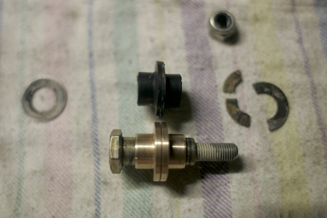

new bronze gearstick bushes (BakerBM) arrived today
after getting the various plastic bits out of the way for access
the condition of the gearstick and bushes/boots was all pretty good considering, just one of the washers had disintegrated
doesn't look like been touched from factory and it'd had a pretty good track flogging under one of the previous owners
none of that for me but the new bushes give it a snug fit, (with the thicker bronze sleeves didn't seem to need any washers either side)
two simple cheap bits but its a big improvement and haven't even fitted the new gearlinks or the pivot bushes yet
