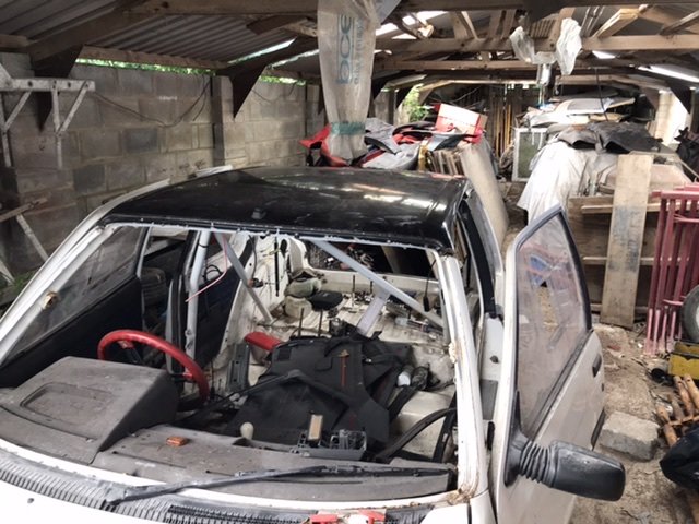

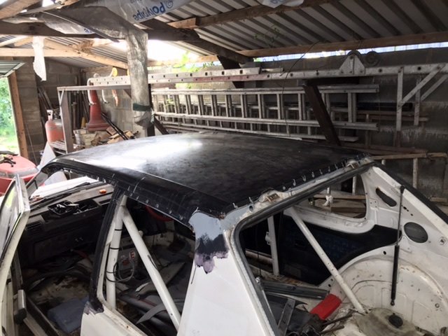

Rally car sine 1988 so it will have a mis match of all sorts on it, car is a C reg 1985 so should be phase one but has the dials and not the sliders in the dash

Mines 85-er also. Mine is also an 205, 307, C2 vts, 106, 306, kawasaki zx12,vems Frankenstein. I even have the steering wheel left, but somehow that is original. Dunno what happened there :P

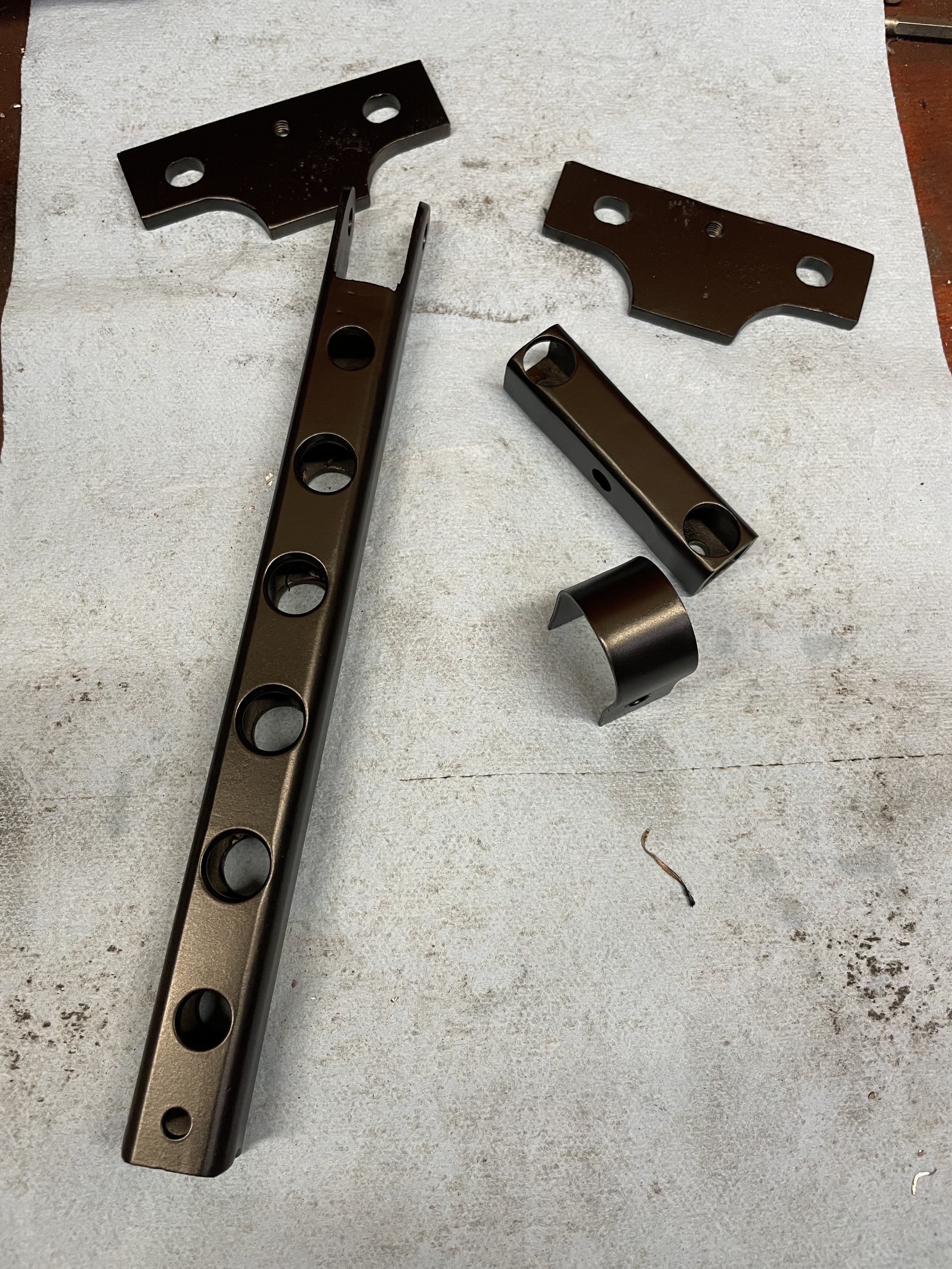

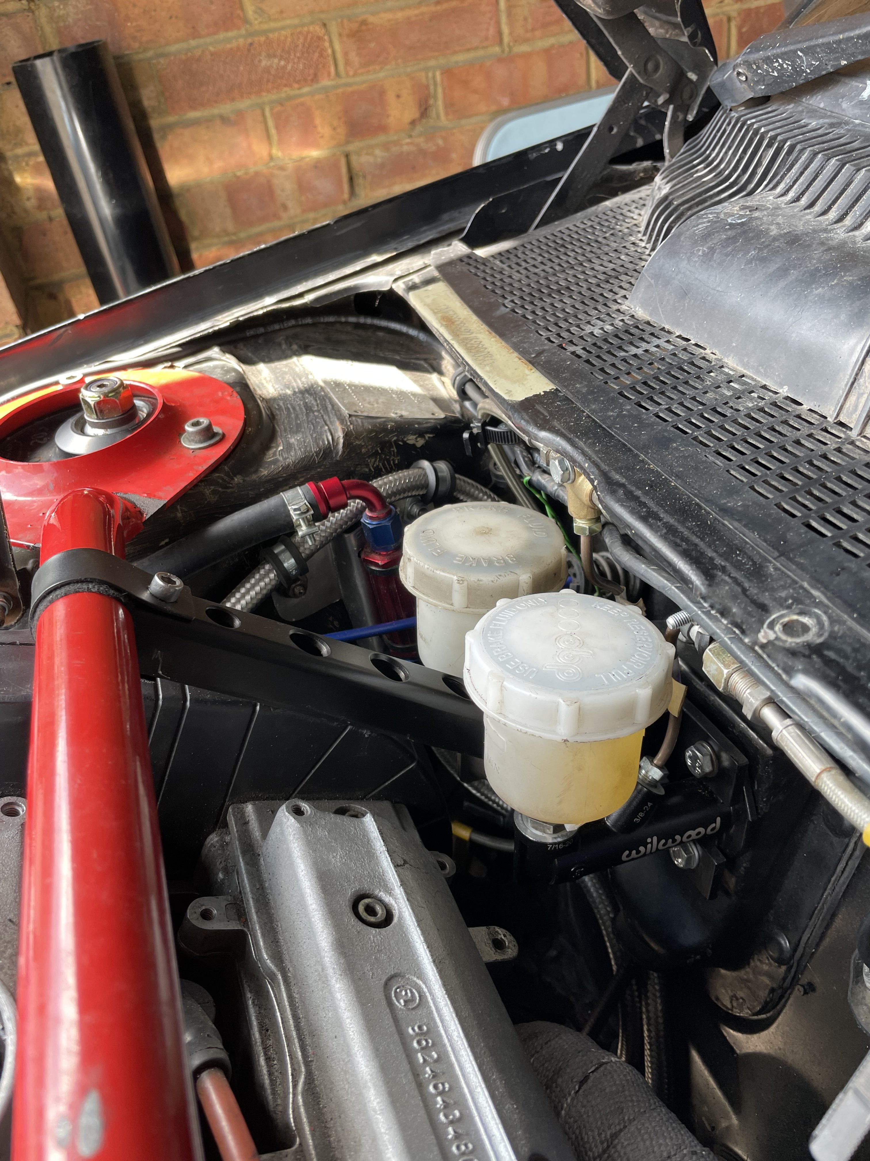

Fitted a home made brace to stiffen up the bulk head.
Goes from the master cylinders to the strut brace.
have never been convinced with the conventional wisdom to weld a ‘stiffening’ plate in, as the plate is still welded to a flimsy bulkhead!
works well - doesn’t eliminate all flex as the brace still gives with a lot of pressure on the brakes, but it’s a huge improvement over nothing at all.

Master cylinder brace is a great idea, nice one. Have you tried the brakes in anger yet?

I live in London so to get anywhere where I can drive it in anger takes a while! But have just filled it up with fuel and found a spot where I could give the brakes a few heavy stops and it’s a big improvement, pedal feel much better:)

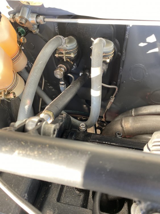

I too added a brace a few years ago after the fire wall was trashed. I made a turnbuckle from rod ends and chromemoly tube.

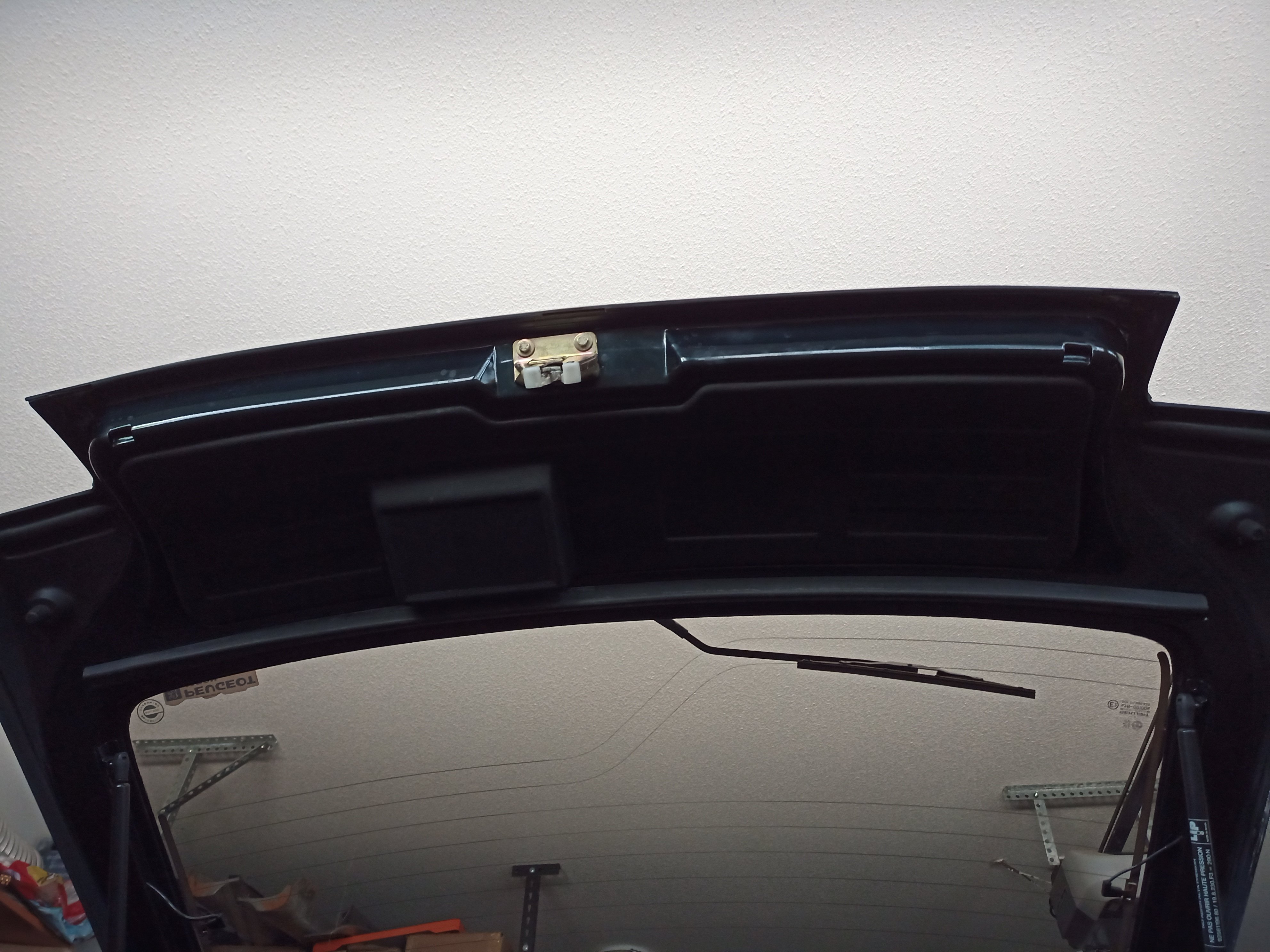

1.9 1993 gti. I tried looking everywhere also using search on this forum, and cannot figure out how to remove the plastic cover over the rear wiper motor. I can see some white clips in the corners and I do not want to pry further and break some unobtainium stuff.
My rear wiper motor is very noisy and I wanted to open all up and clean/grease the arms and all. See photo of the cover.

Nice - looks like that brace will be lighter weight than my effort and adjustable too. I must learn how to weld!
TIG is good.

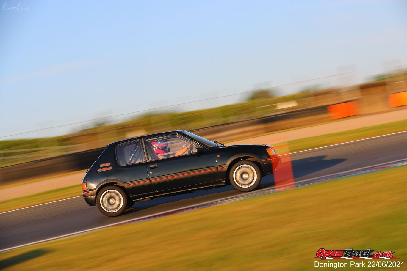

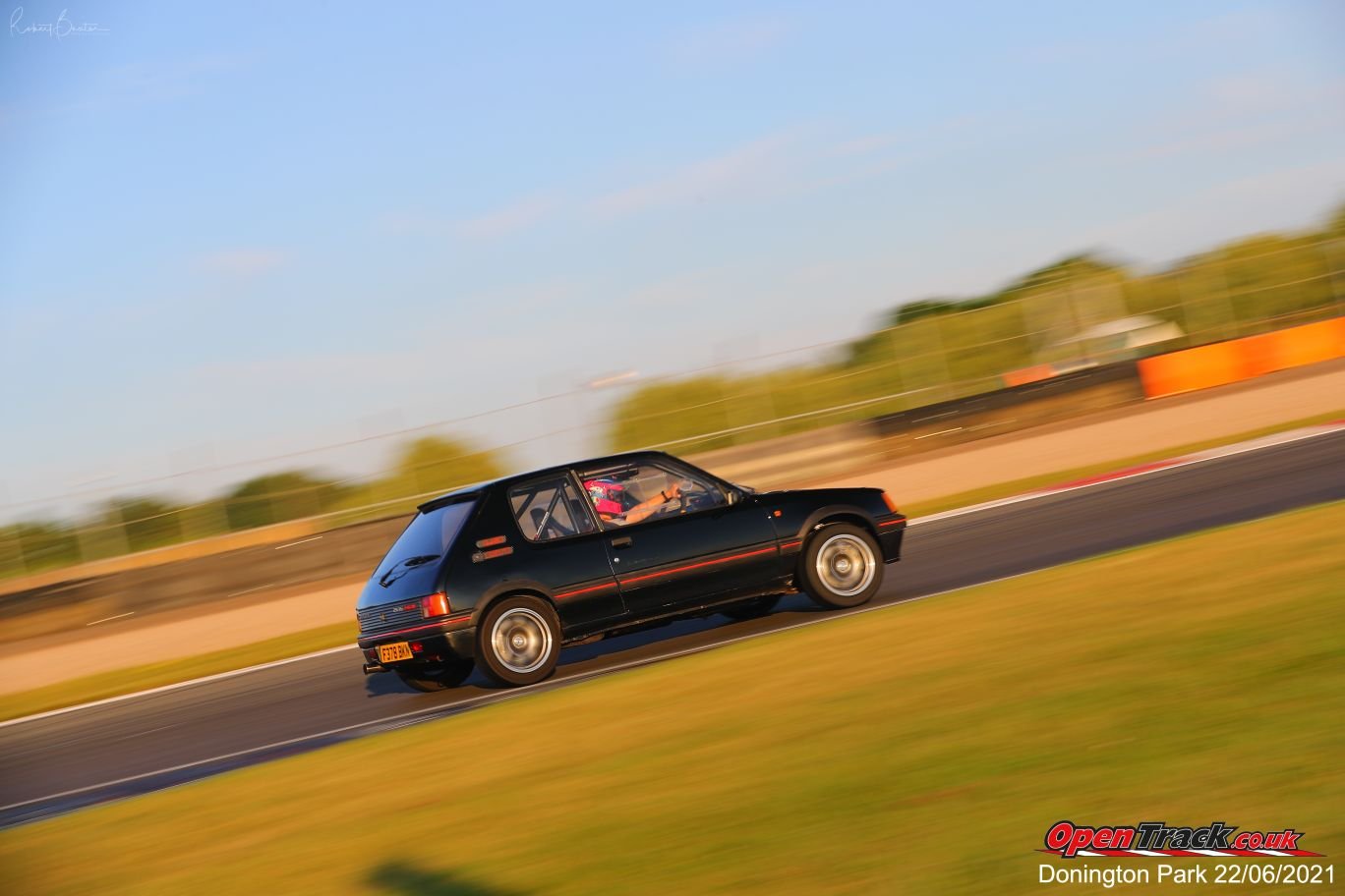

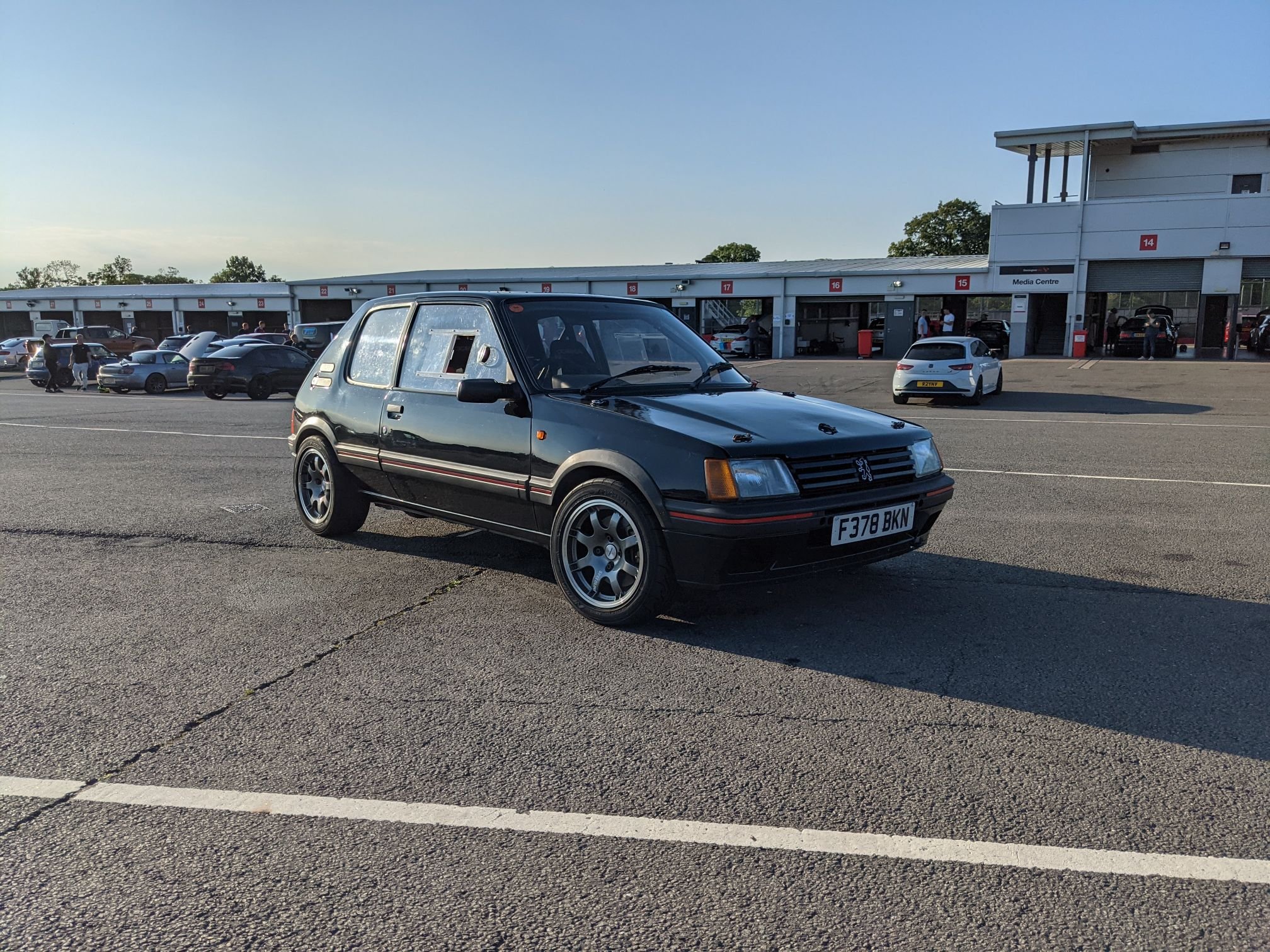

Took it to Donington Park! First time on track there for me and found it brilliant. There has been a lot of work gone into this car to get it where it is now, but the feeling after a few quick laps makes it all worthwhile!
