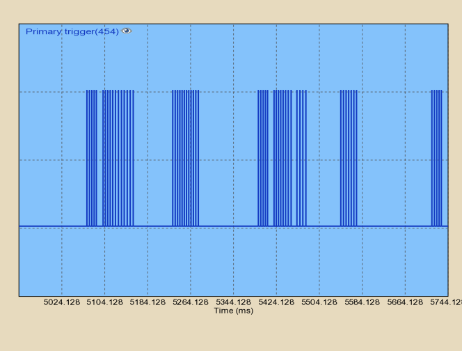

Had some trouble with the trigger but then I've switched the polarity and now it seems a that I get a nice signal.
(Doesn't display any faults like it used to)
However I still can't get it to start...
Is there anyone here with experience in Vemstune that could take a look at my log and config and tell me what I'm doing wrong?

standard crank sensor in the standard position?
Rowan
Standard old type TU5J4 Bosch sensor. Mounted on standard bracket.
unariciflocos
Two years have passed since I got my car running on VEMS, so my knowledge of it now is close to non existant. However that crank signal doesn't look all that good, after all it is a 60-2 wheel isn't it?
What I remember having a LOT of issues with was setting up the angle between the trigger tooth and TDC. Do your best to measure TDC and mark it on the flywheel and count the teeth to the missing tooth. I did the same and after i started I fine tuned using a strobe.
Second problem I had was with wasted spark firing order. After a bit of messing about I just reversed the two channels of the coil and the engine fired straight away. Write me a PM if you have any more questions. Don't drop by this place so ofthen now that my car is temporary in storage.

The sensor was fubar and hall filter was enabled, so swapped the sensor and disabled the filter.
Started right away!
