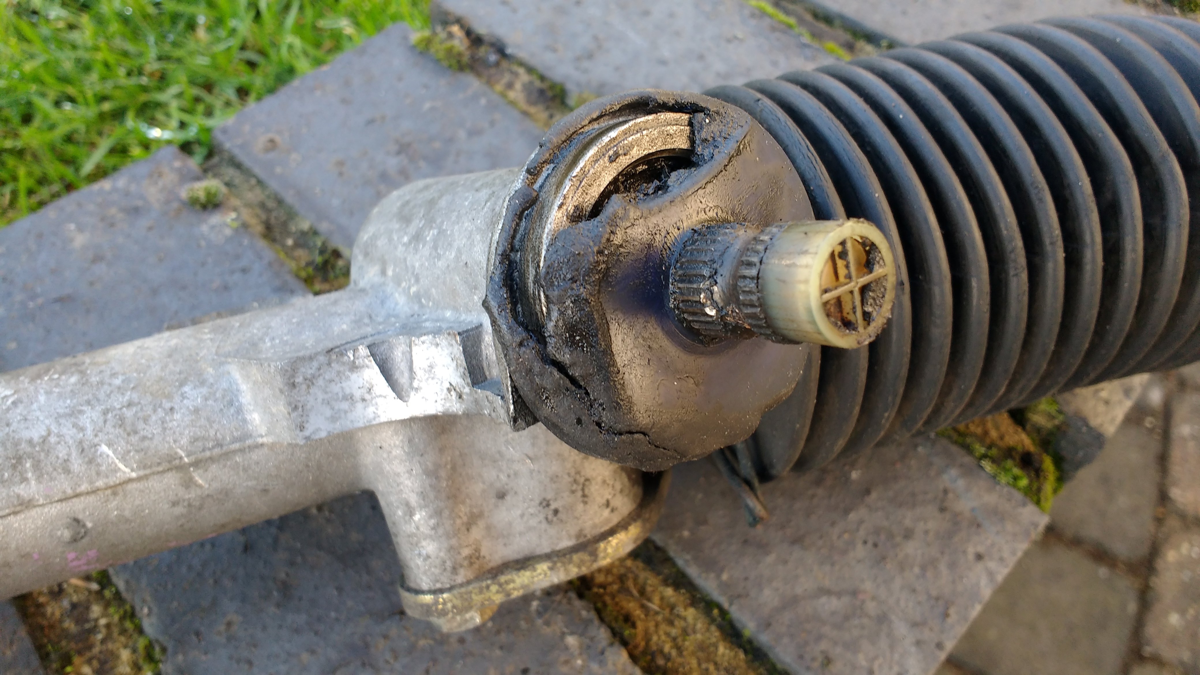

My son and I are in a similar position of trying to find some play in his rack - so the previous advice is very useful.  Regarding the plastic cap: it has a big chunk missing.  I have seen other photos on this forum of similarly damaged caps.  Exhaust heat?  Is it there to keep water out?  Should it have grease packed underneath?  Are replacements available?
ArthurH
Also, what is the function of the plastic bush closest to the camera in the above photo?
hoodygoodwood
Plastic close to the exhaust can crack like that , its just a protective cap to stop water getting into the mechanism - replace it if you can find another one . The plastic piece on the end of the pinion I have always assumed is just a guide to aid assembly of rack and steering joint plus it fills the hole in the U/J and stops a build up of dirt etc .
