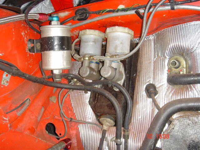

Room is a good thing that what I need all you guys with them can you upload a few Pics.

I have found that fitting AP racing master cylinders make a marked difference to the brakes over say Girling cylinders. Additionally AP make short cylinders which helps with clearence issues when a 16 valve engine is fitted.
engine killer
yes, AP master cylinders do give better clearance. and the smallest and second to smallest valve size cylinders give a lighter pedal feel (less effort).
