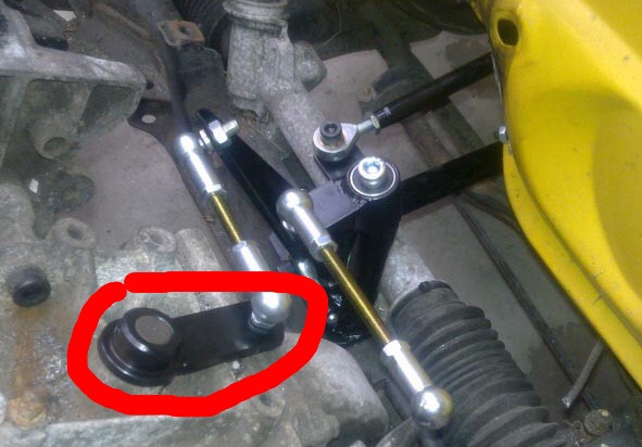

Does the 205 kit come with this selector arm ?
dcc
doubtful, thats a be gear shift arm usually found on the gearbox itself. specific to 205's iirc
if it needs it, yes it does, seeing as that is a pic of a 205 kit, it needs it.
306 kit comes with that arm.
tcr
Thanks ???? the arm on my diesel box is is different to the standard 205 which does work fine but I want to upgrade to the satchshift kit
yes it does
