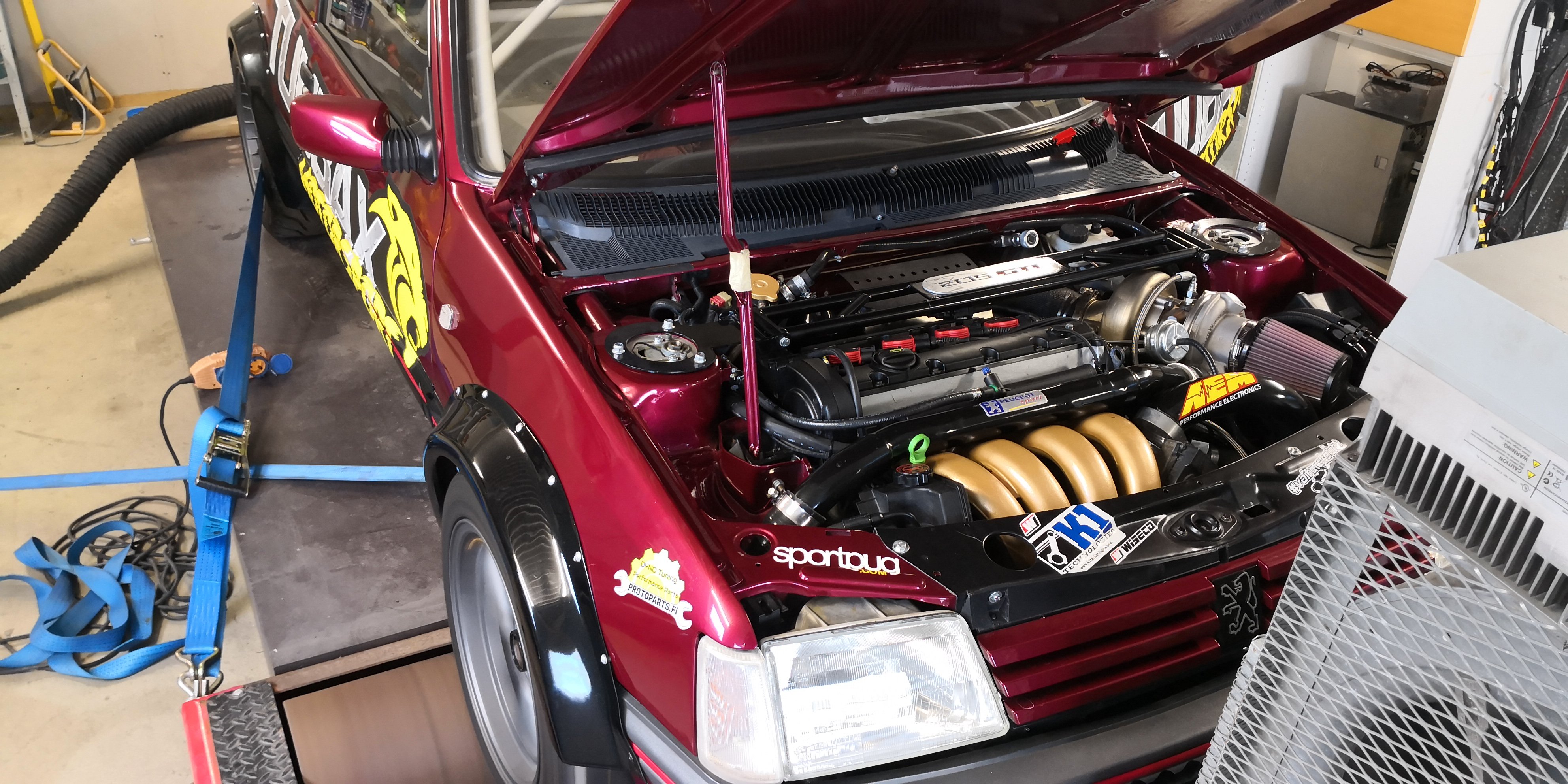

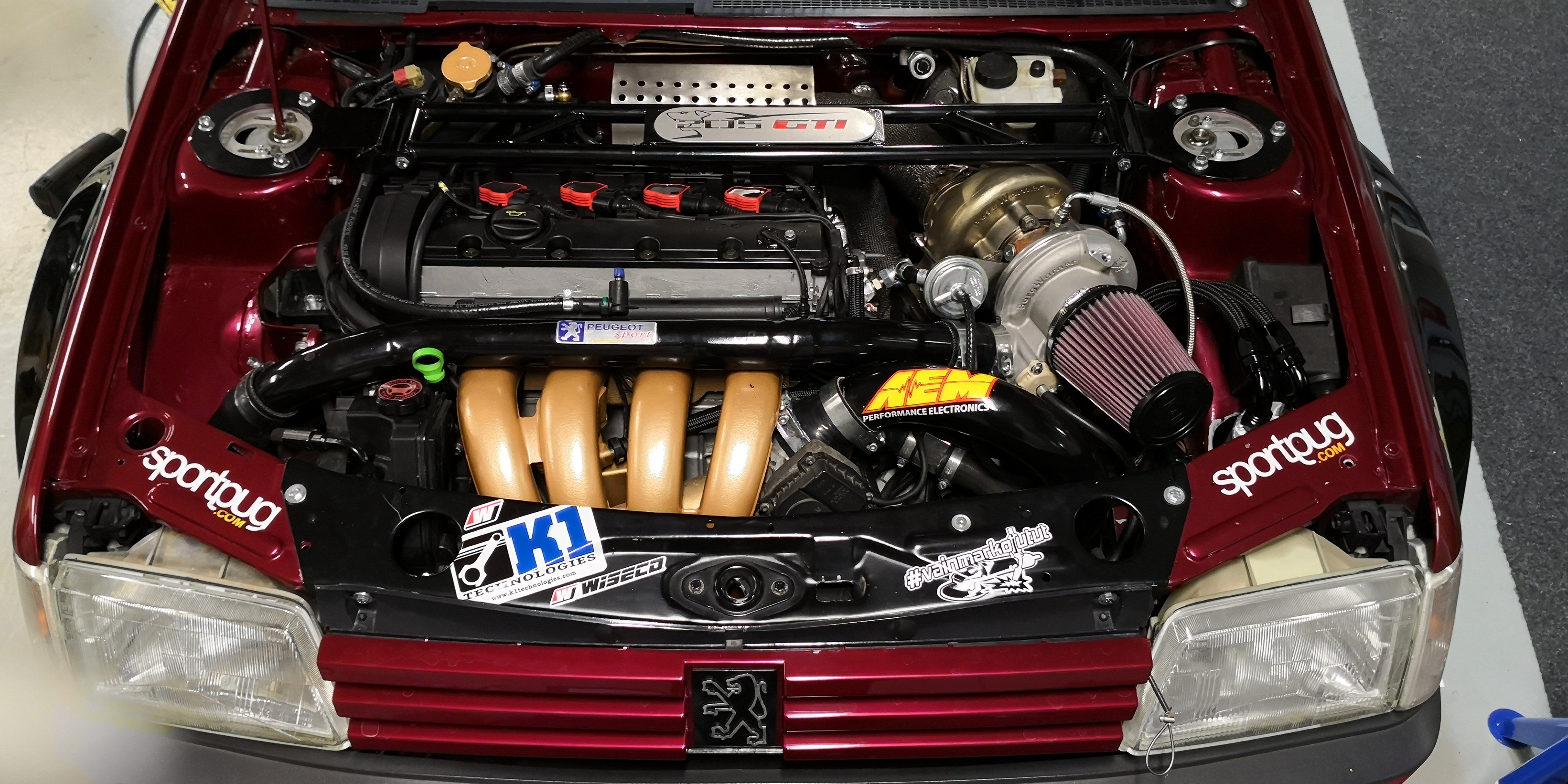

Just did some dynosessions with my 205 GTi with EW10J4S. Specs are:
100% stock head and cams, also timing. VVT active.
Wiseco 8.5 pistons and K1 rods. Otherwise all stock. TB is VW 1.8T 60mm DBW. Original one is a rotational solenoid, VERY difficult to get acting stable.
Borg Warner EFR7064 and 1300cc injectors.
AEM Infinity 506 ECU
Best pull was:
495Nm@4500RPM, 1.2bar boost
380bhp@6000RPM, 1bar boost
Exhaust cam needs some timing adjustment so we can get EFR spool as it should. It really should produce 1bar@3000.
After that, we started to lower the torque that gearbox won´t break. Too late. :D
BE4R crushed it´s fourth gear on rollers after about 10hrs. Now I´m planning to do it RWD. Can´t really figure out proper transversial gearbox to this. After camjob and setting boost to proper levels, there´s no chance to get anything tough enough...
Must say that this engine is sweet :)

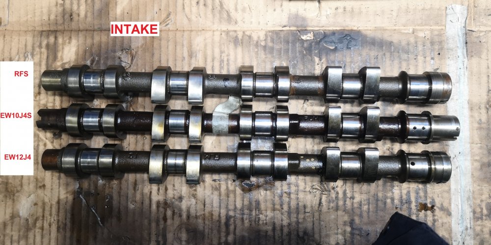

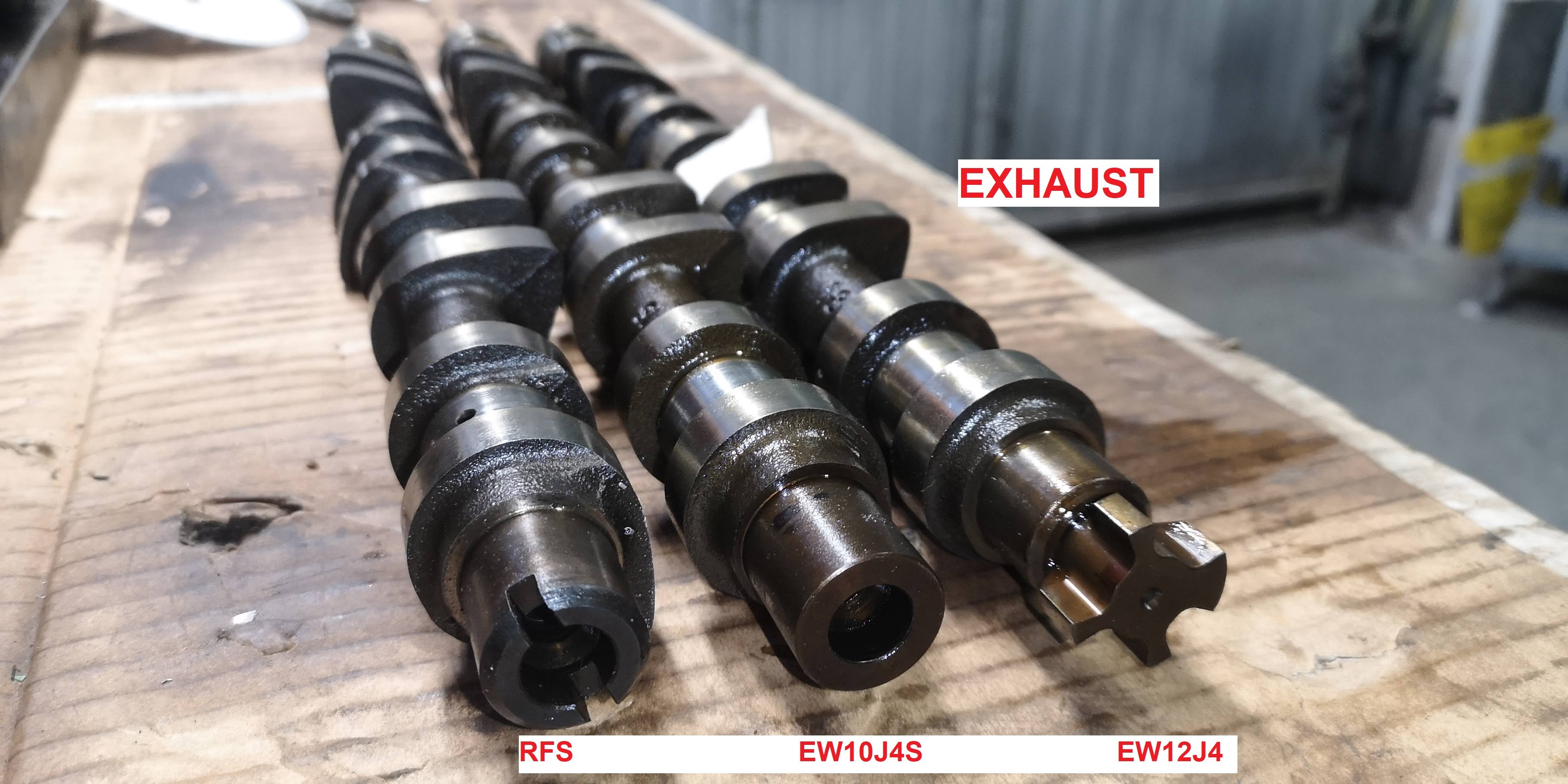

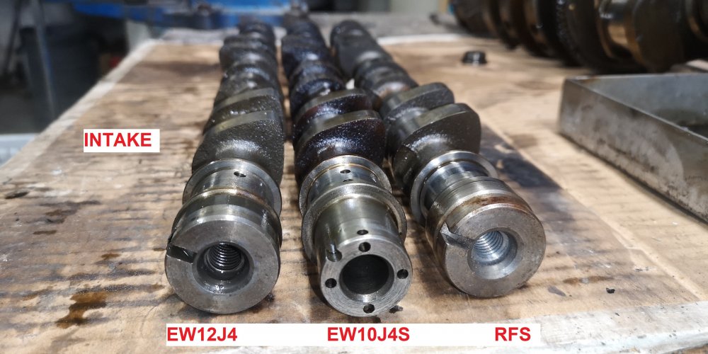

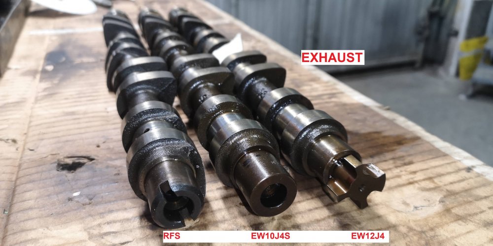

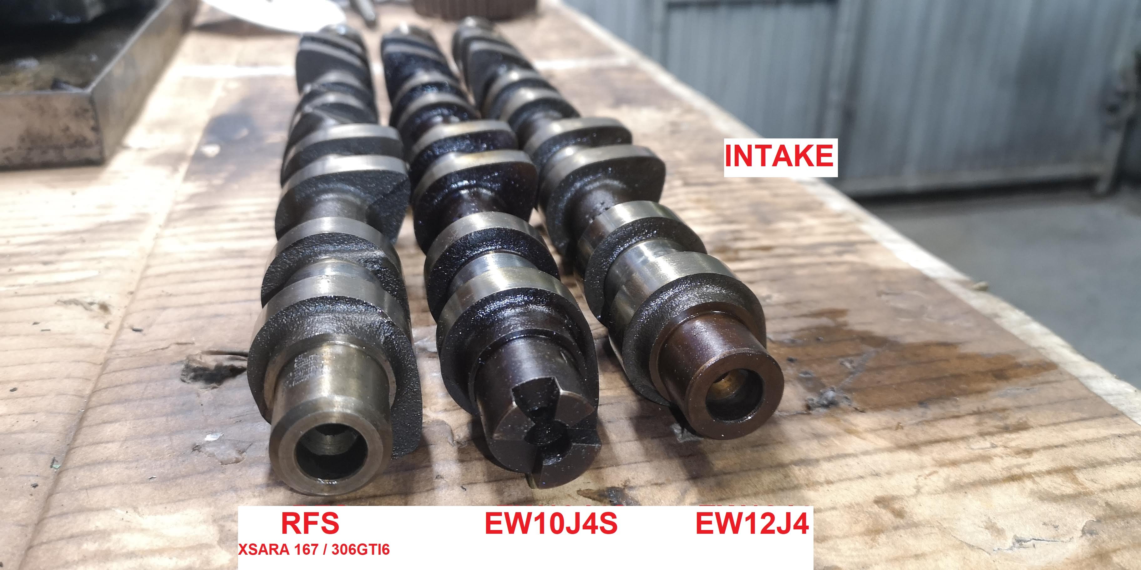

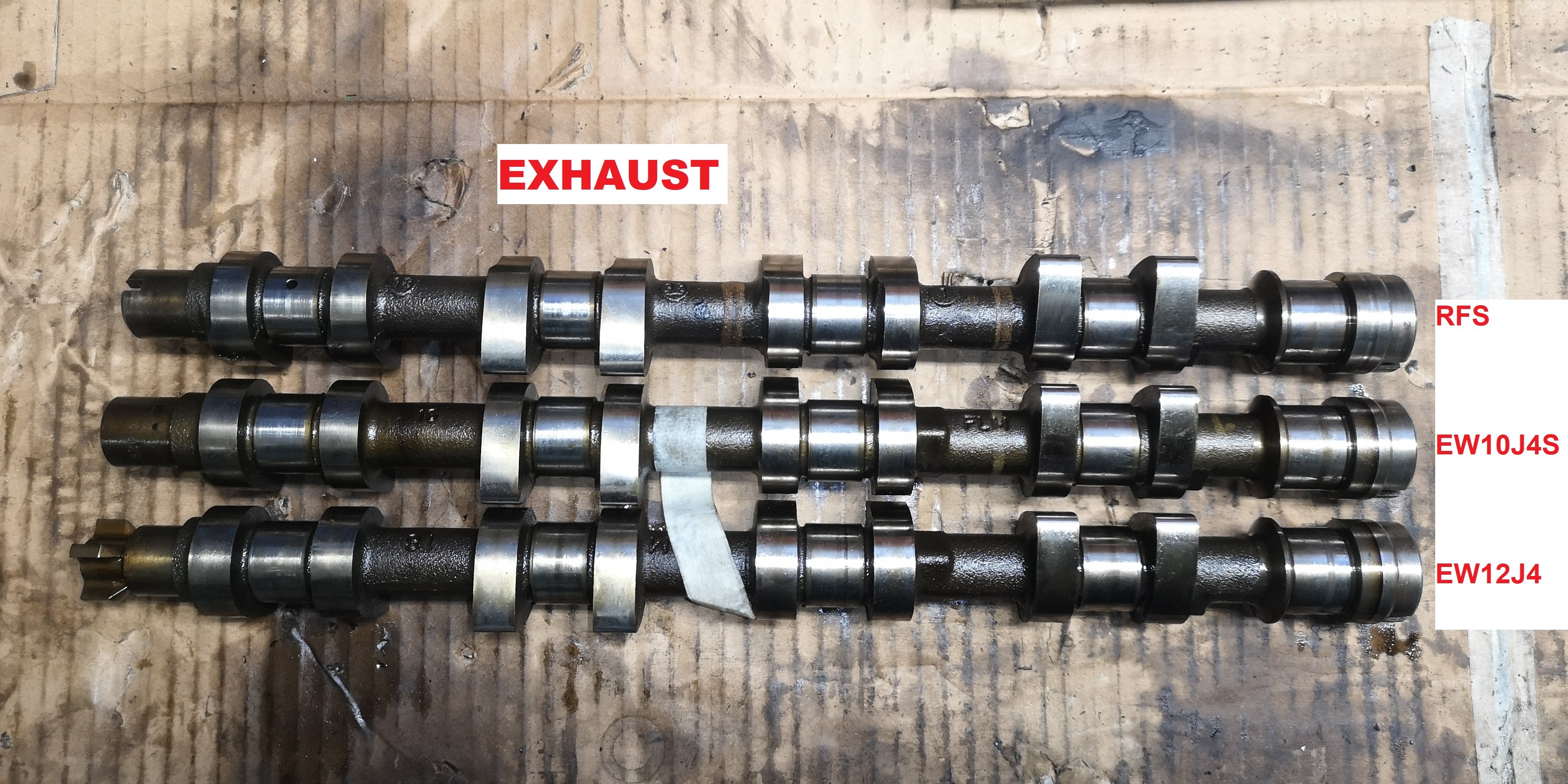

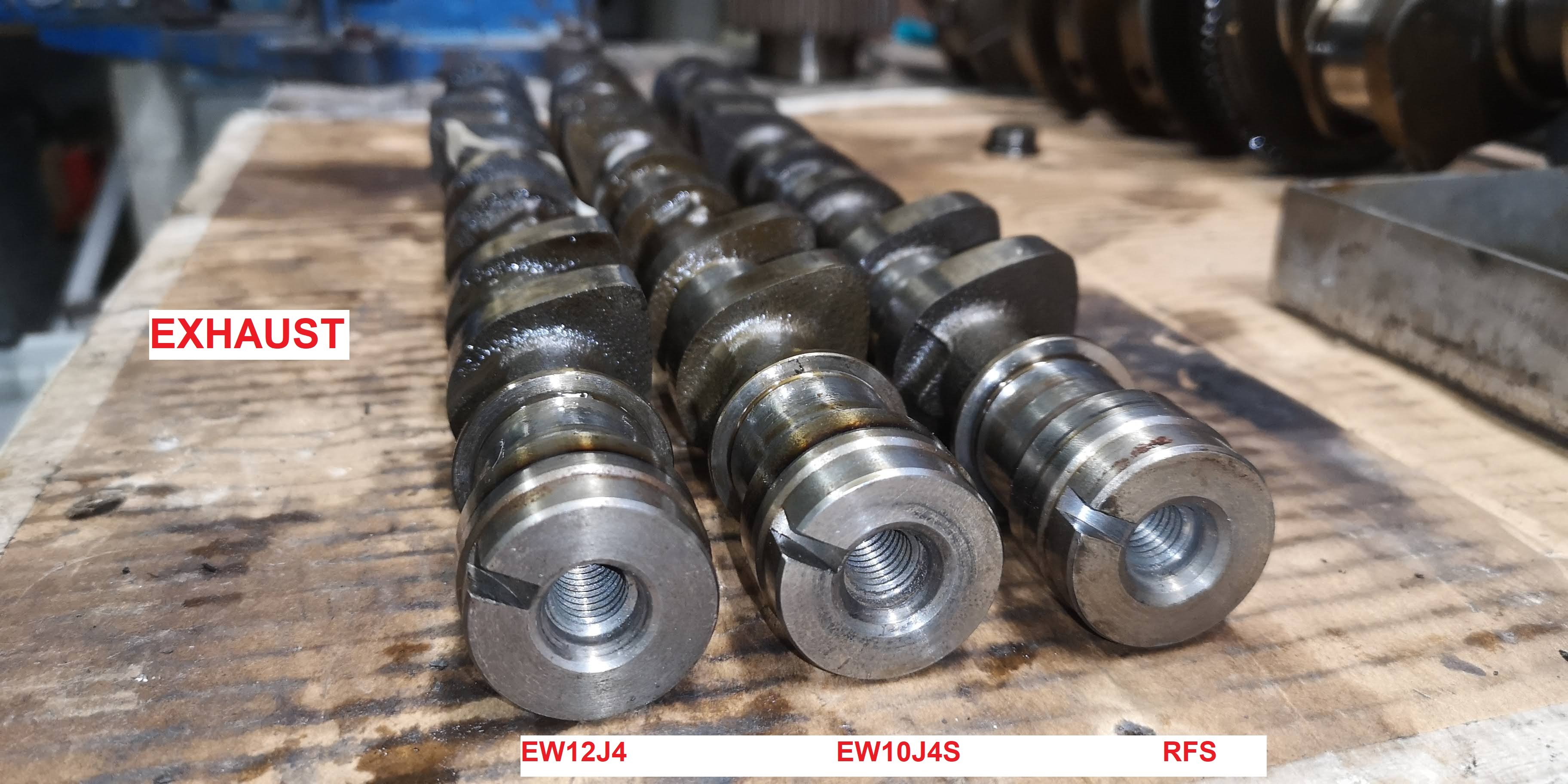

I don't know if those images can help somebody. Cams are a bit wider than the EW camshafts. It looks to fit without issues, but still no tightened.
I have also the idea of fitting the XU10J4RS (Xsara/306, RFS on images) on my EW10J4S head. Still not sure if I'm going to use the XU10J4RS cams, or two exhaust EW10J4S camshafts (VVT delete, as it will be installed into a 206 GTI).
The main problem I can see is that the EW10J4S head has the camshaft position sensor in front of the intake camshaft (EW12J4 got it in the top of the exhaust camshaft).

Yes but you do not have EW10J4 here,it is 136 hp,this is from 2.0 180hp and 2.2 158hp.
ammm84
Yes. My EW10J4 is still in the car (a 206 with broken engine), and far from me.

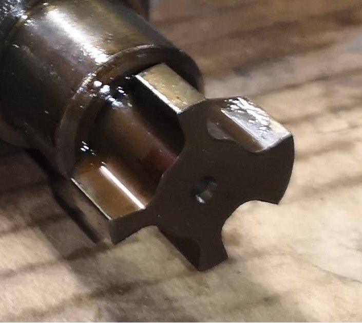

In my case I will use the EW10J4S head, and thinking about wich cams to use: XU10J4RS, or 2x EW10J4S exhaust cams. The main problem is that the car will want to read this on the exhaust camshaft:

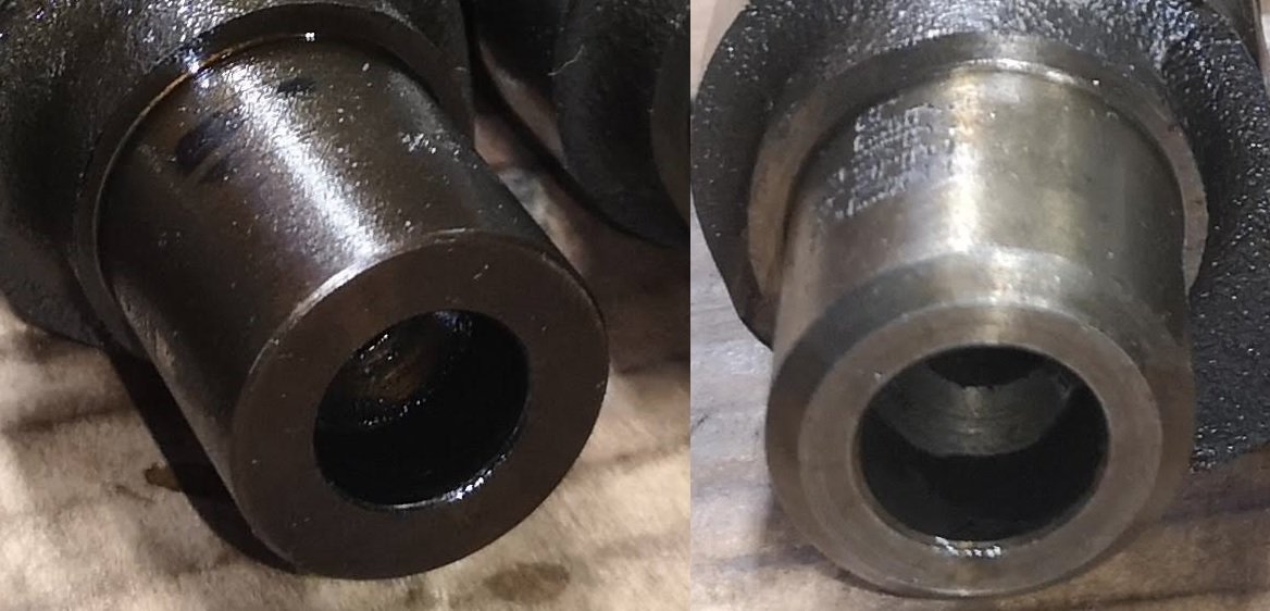

And instead it will read this:
Any idea about solving this?
looks like a separate pressed in part.
