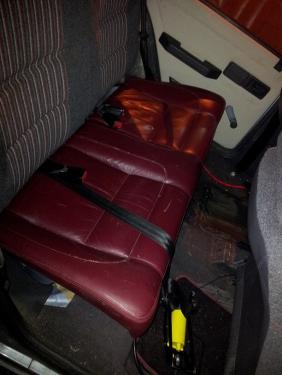

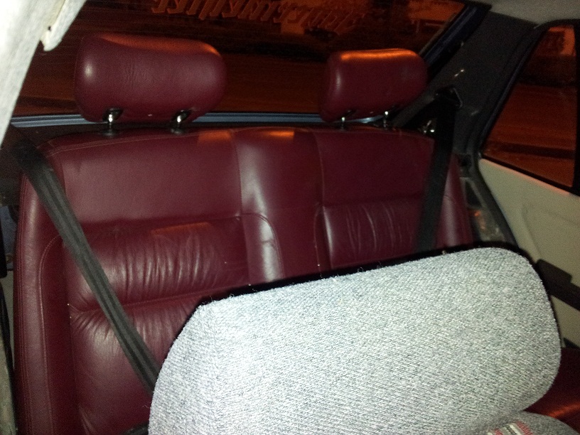

johnnyboy666
heres a few badly taken shots of the rears. Bare in mind they are just resting in place at the moment, so the backrest bit is a good few inches higher in this photo than it will be when Ive finished!
jonXS
they look a nice fit i like it, apart from maybe the red part
johnnyboy666
Yes, as with the rest of my car its not to everyones taste. But i couldnt resist a bit of red leather!
They look a lot narrower that standard 306 seats, which is why they fit.
allye
Amazing! Can some one please confirm whether 306 cab and hatch seats are the same/different?
johnnyboy666
i'd say definately the rears are different, these ones dont really have much of a 'frame' to them, just moulded foam with a stiffer bit for rigidity, they weigh f' all as well which is a bonus.
the back rests will definitely need reinforcing using the old backrests, as I keep a trolley jack in the boot and I dont want that flying through the seats!
