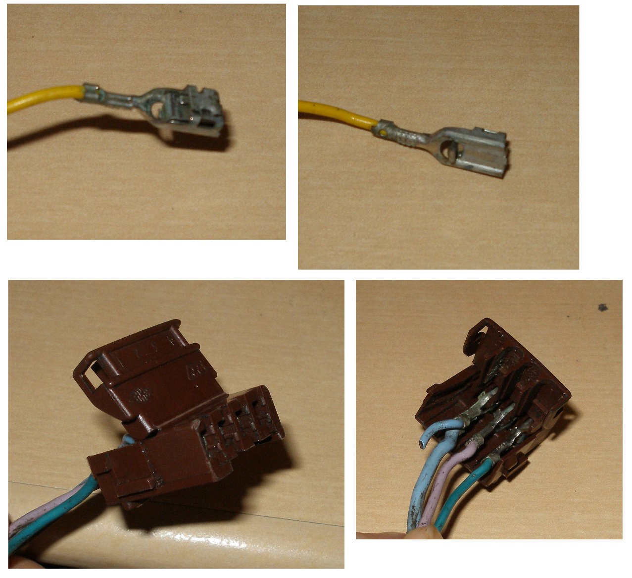

I've attached images of the connector (front and back) and the housing with the clip opened up so you can see the terminals inside.
The width of the terminal appears to be 6mm.

Lookswise, the closest is:
FLAT CLIP
6542 GC A=8 B=3 A 5MM2
6542 FN A=8 B=5 A 10MM2
But they're 8mm wide
The other option is
HARNESS CLIP
6542 30 A=6,3 B=3 A 5MM2
6542 32 A=6,3 B=0,3 A 1MM2
Which are 6mm wide
But not 100% sure either are correct :wacko:
Shame I can't wind the connector as it actually tells you what terminals you need then :blush:
second one looks more likely, especially given the wire size they are intended for... ;)

I was thinking of the second one too from my own look of the selection.
Next thing to find out is whether they still exist. On my last couple of parts queries from Pug dealers some parts are becoming obselete rather a lot now.

I managed to get them no probs from SEL imperial, they seem to easily get anything as long as its not NFP. I was going to do all my looms with new but at 40 odd pence each for most i had tosettle for a handfull. Just watch the height of the clip and match to the connector and also the size of the cable each clip accepts, there are different ones for each connector but the end that goes into the connector and clips in place is generally always the same and is the second one in the pic!

It turned out the part I needed was 6542.19 where the 'A' dimension is 5mm. I did get some of the 6542.32 with A=6, but it appears that A is the internal width of the terminal (or the width of the spade that slots into it). So 6542.19 are 6mm wide with a 5mm slot. A little confusing, but I got there in the end. The Pug dealer had them in stock which was nice (~40p each).
