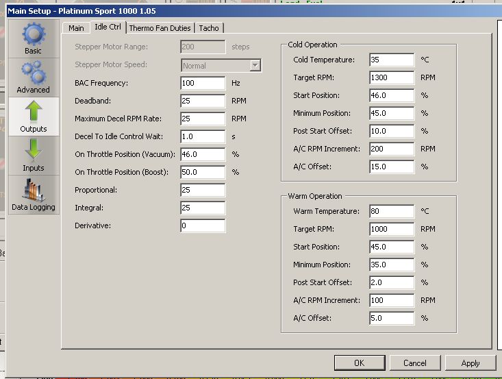

It's hard to get the Mi16 stepper to work on anything but an original ECU. The reason being is that the ECU also uses ignition advance to control the idle speed, just like a Subaru. Put a timing light on it and you'll notice it jumps all over the place. I'm happy to pass on my Haltech settings if you can use them.

What ICV are you using with the Haltech Peter?
As far as I can see from the Emerald menu it is also possible to use ignition advance to control idle speed.
I am planning on fitting one to mine in the future so if you have any tips and hints about what's the best (see easiest to setup and get good results) ICV and settings to start with it would be appreciated.

Here it is, for a standard 1.9L Mi16 setup. I'm unsure about that frequency of 100Hz however. It may be an early sceen shot. I'll double check in some files.
