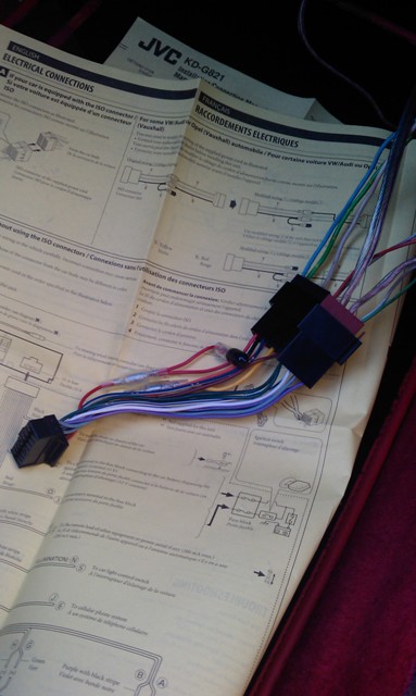

Henry Yorke 269 3 Cars Posted March 30, 2011 There should be two red connectors as standard. One on the back of your OE head unit which it sounds like you have and a female version (IIRC) on the car loom side. These two join together and it works. It sounds like someone has removed your original car loom side and replaced it with ISO connectors so a more modern radio can be fitted. Therefore the only way to fit your OE radio is to chop the car loom connectors off and fit the original connector from a car in a scrapyard. The part you got off ebay may well be a Peugeot to ISO connector but will be the wrong way round for your application. I have one of these looms in my CTI so I can run a more modern Alpine head unit on the original loom. This is what your loom will look like Share this post Link to post Share on other sites

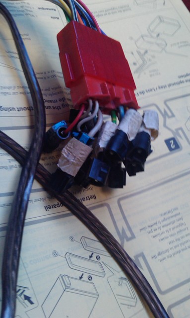

GLPoomobile 958 Posted March 30, 2011 The picture below shows the original 205 connector. The part facing you in the pic is the male end, which is on the car loom. As you can see, some utter faggot had a field day with the wiring at some point in the past. THe female part, with the wiring disappearing off the picture, is an ISO adaptor loom, but it's the same plug that would have been on the original 205 radio. On mine I did away with the original red plug (that decision was pretty much made for me, by the awful cowboy job shown above!). I cut the wires back neatly, ran some new speaker cable, crimped on the appropriate new terminal pins, and re-terminated them in to a pair of ISO plugs I had spare (brown carries speaker cables, black carries power, earth etc). The loom on the other side that goes to a single ISO plug came with my JVC headunit. Share this post Link to post Share on other sites
