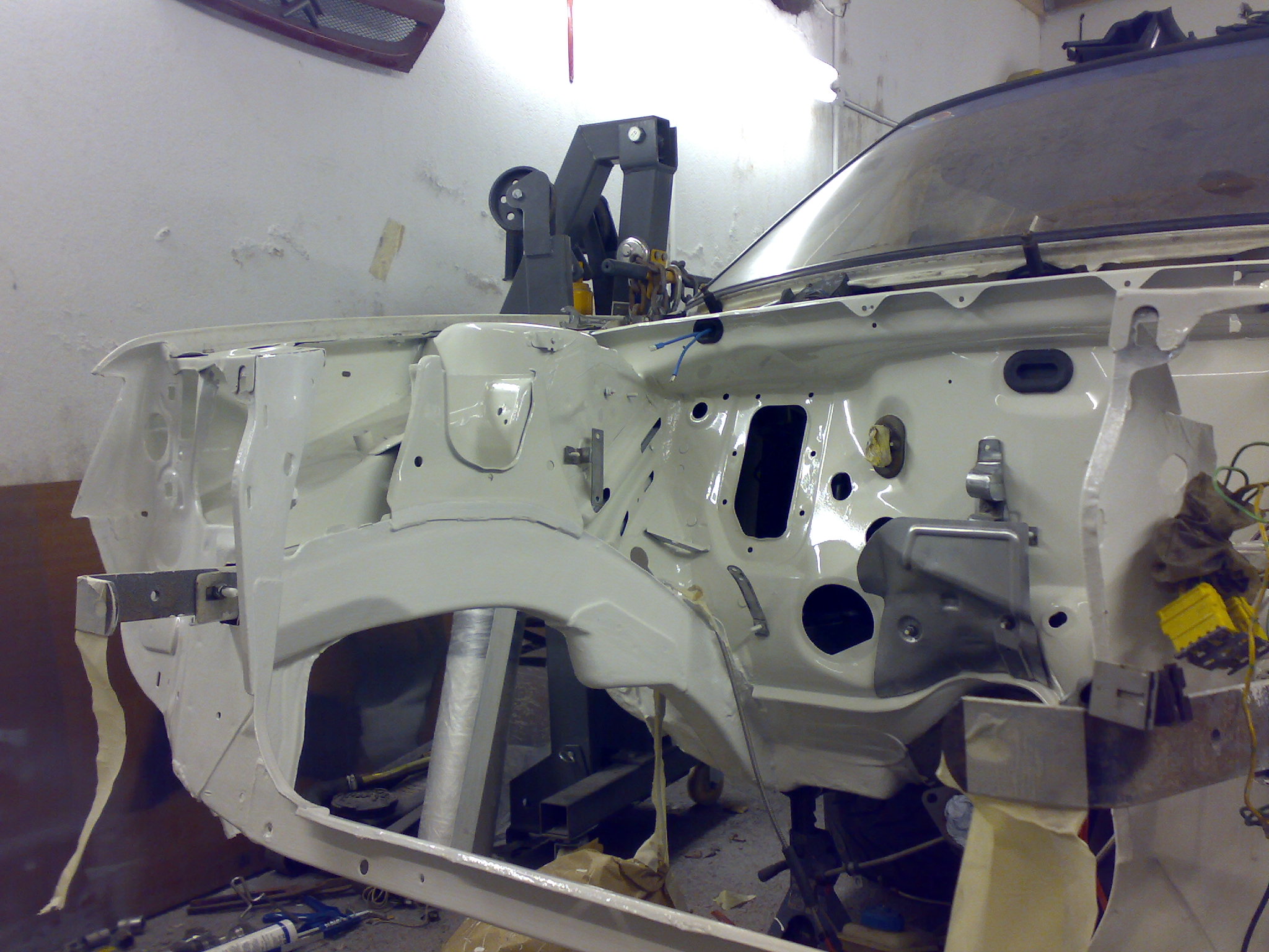

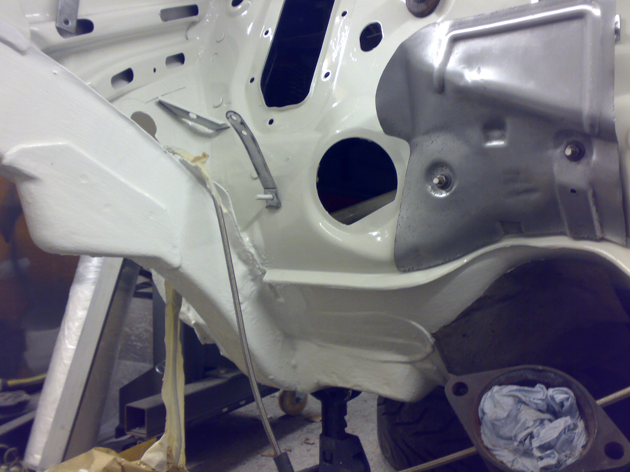

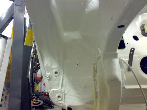

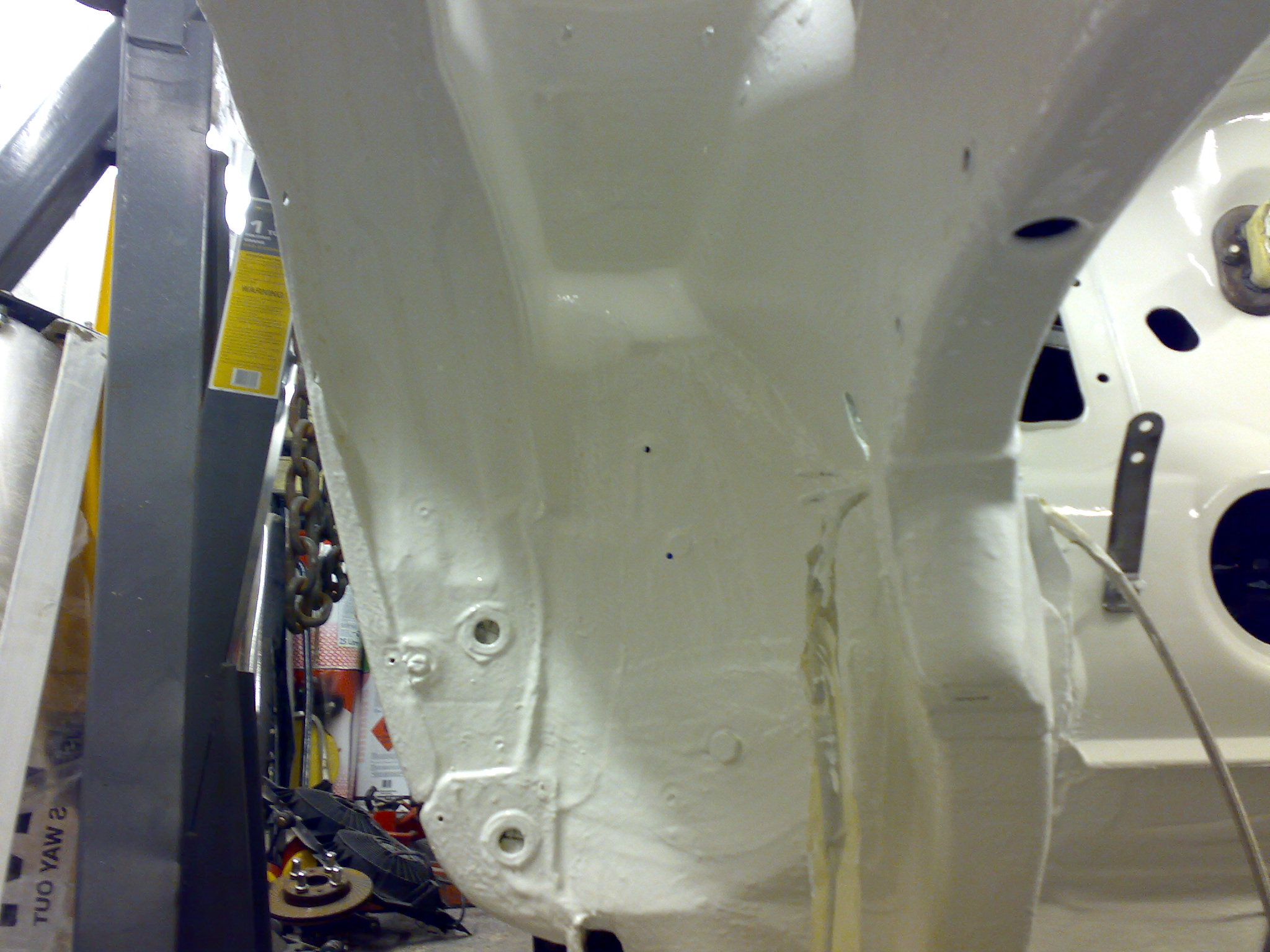

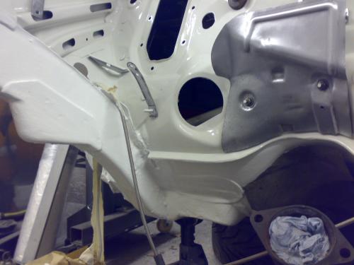

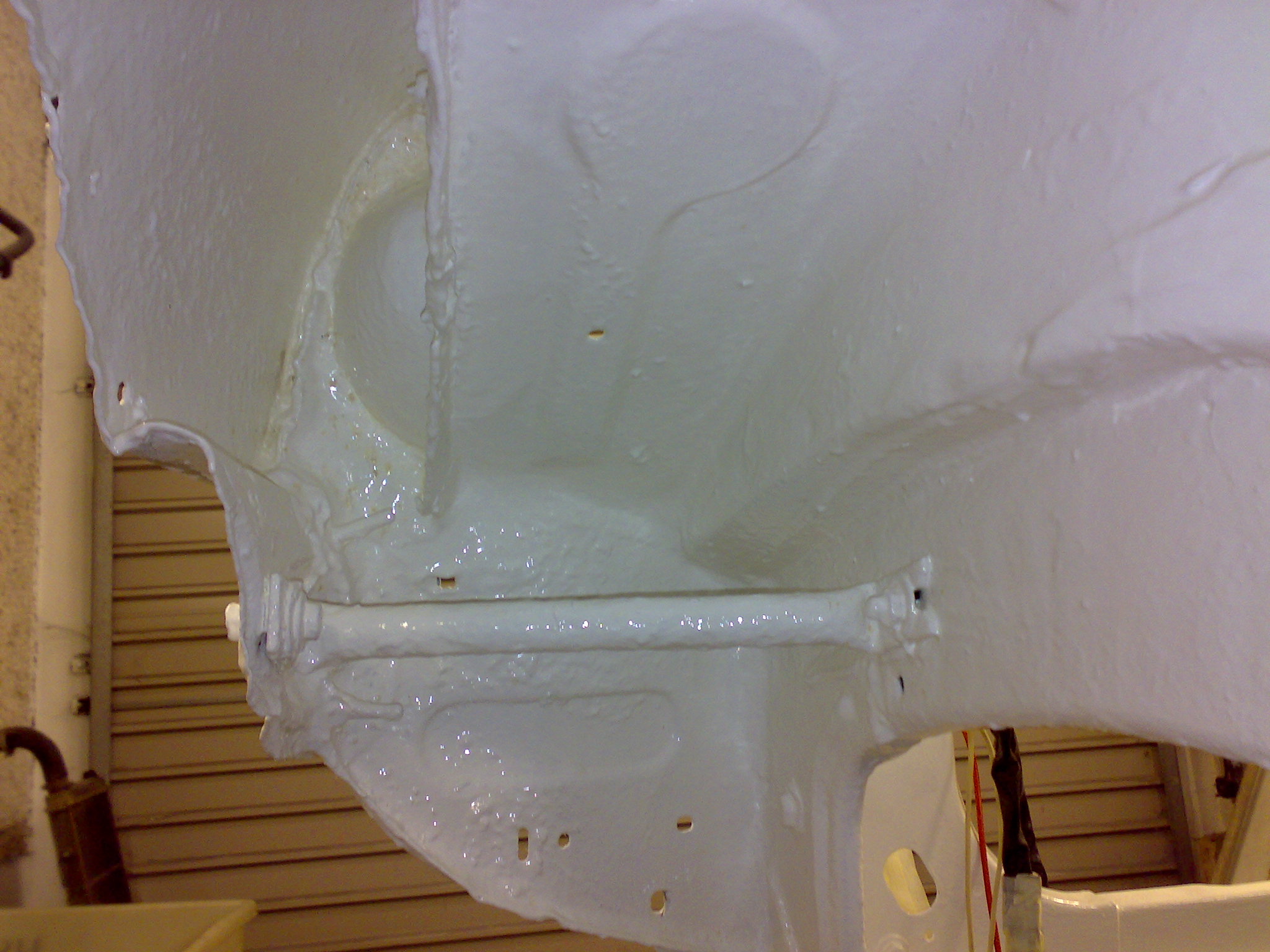

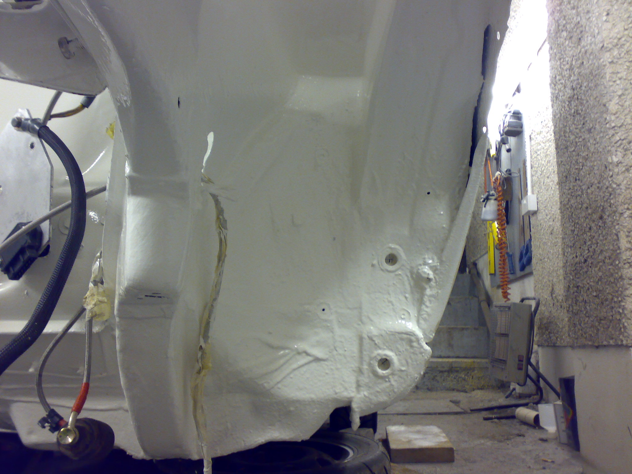

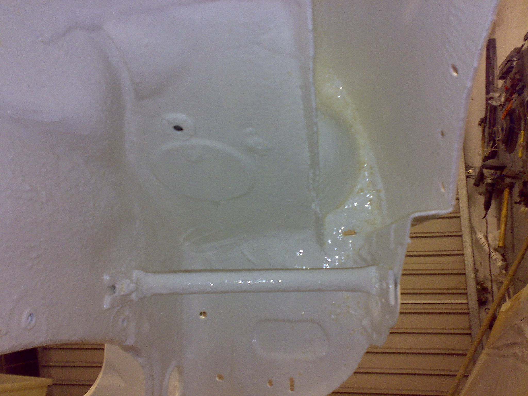

Over the last few weeks I have got the engine and box back so started to pull the old 1900 out.
When the engine and box was out I striped the suspension, subframe and a few other bits off the car so I could paint the engine bay.
The bulkhead, inner wings and top of chassis legs were spray painted.
I also painted the back of the wings and up under the arches, these where just brush painted as it gives more protection.

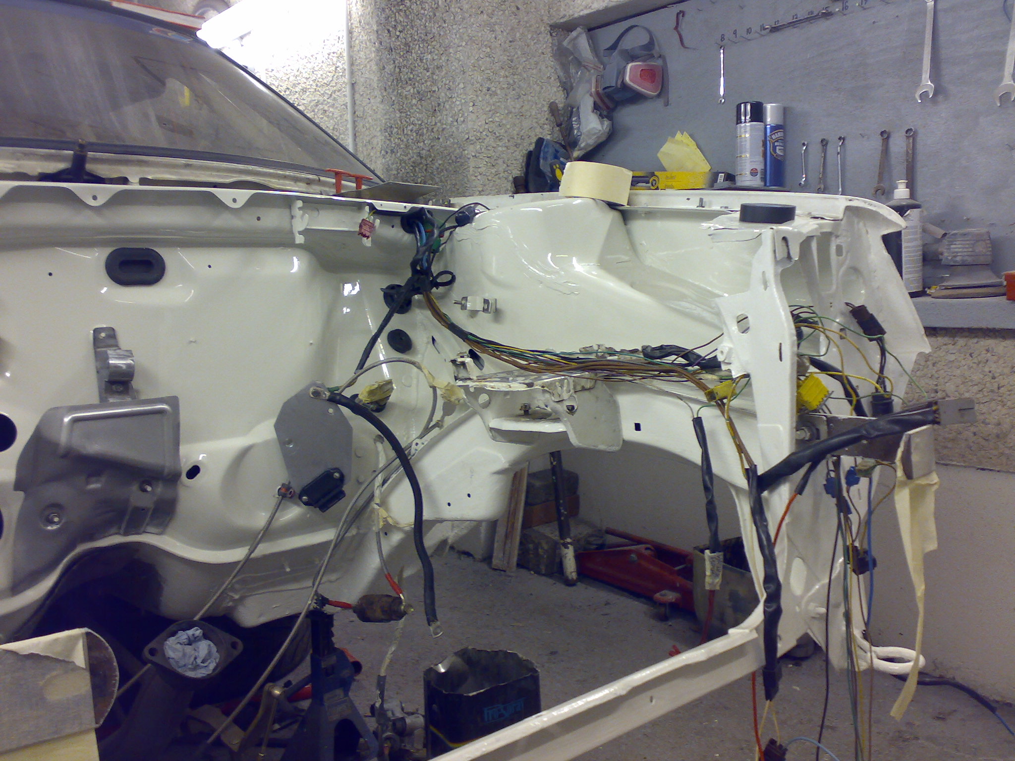

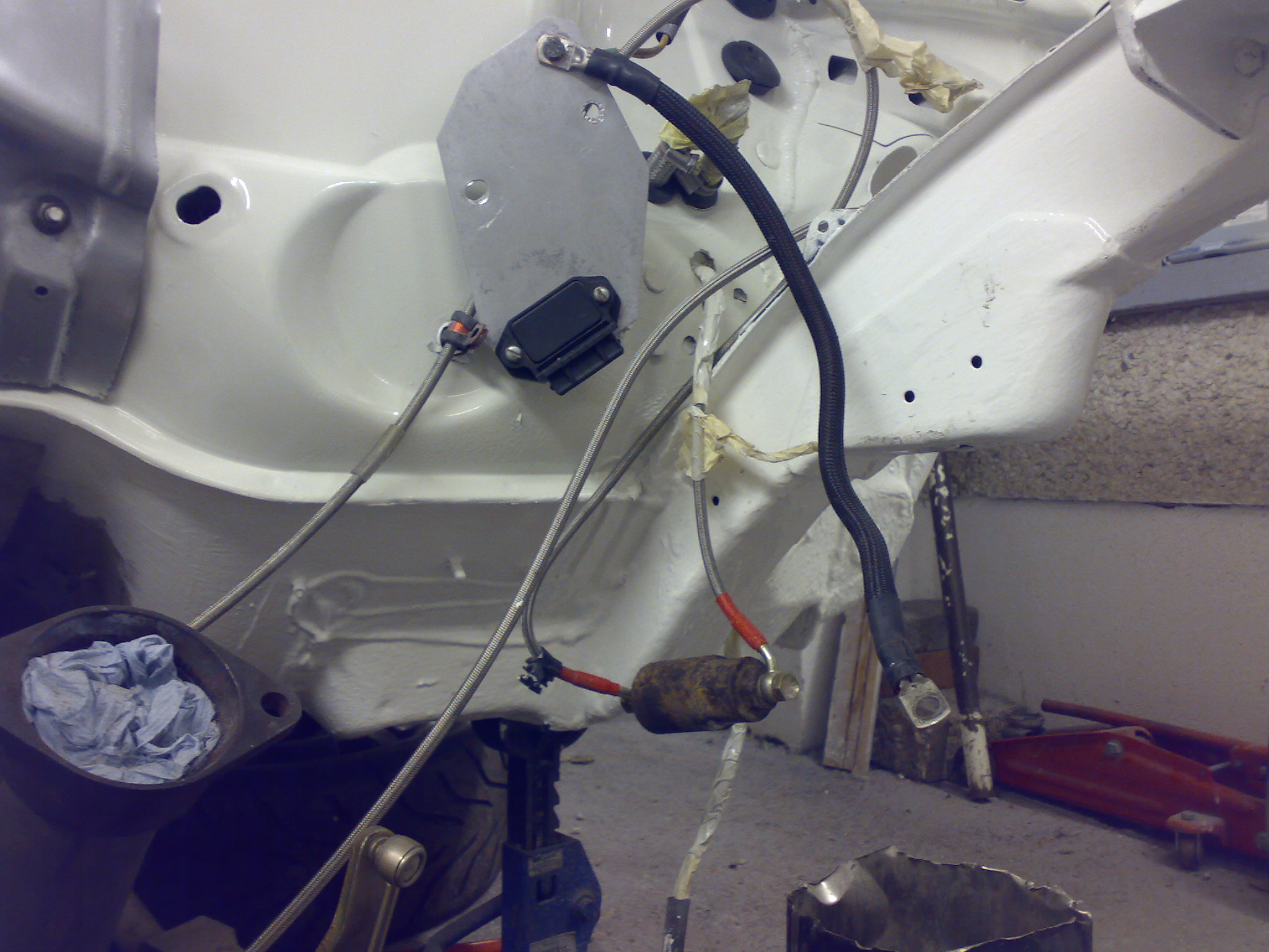

Then I set about the wiring, the loom had been in a mess just a ball of wires !!
Pics below show how far I have got to date.
More pics of the wiring up soon

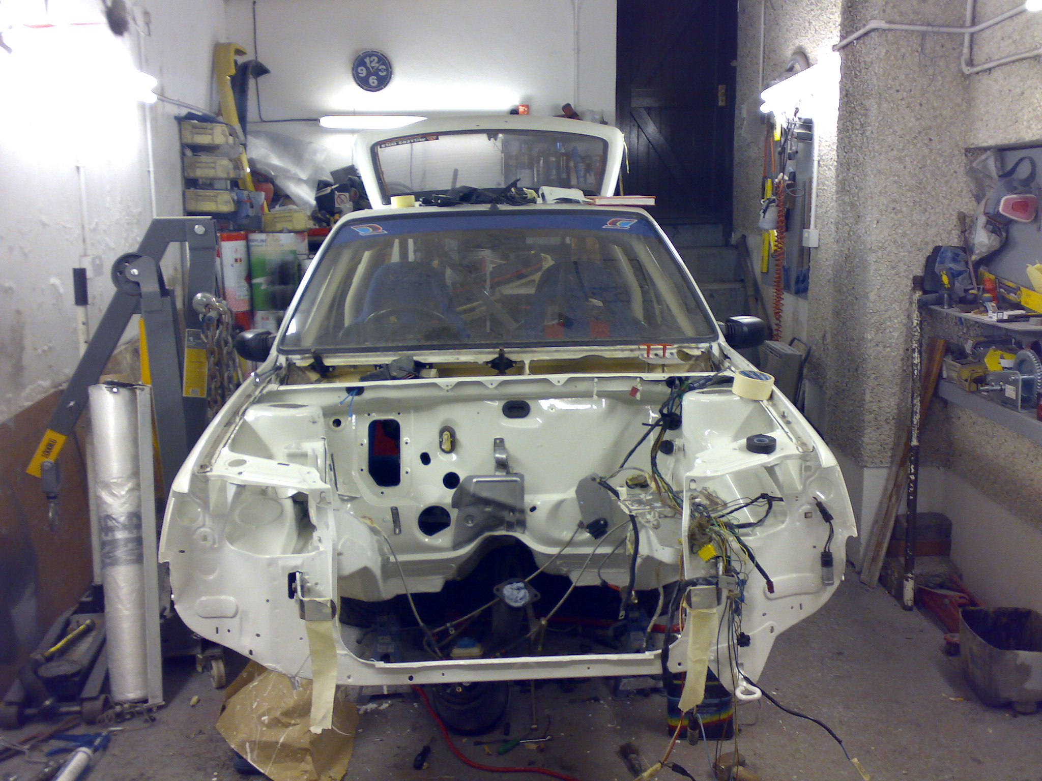

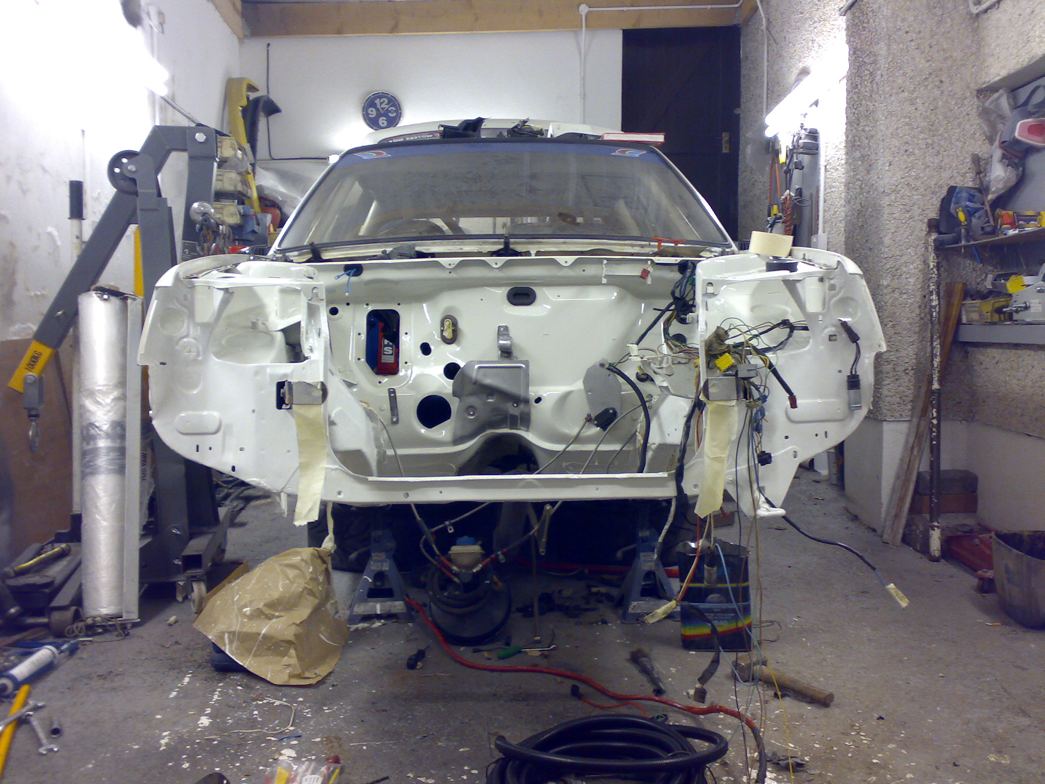

Some pics of the wiring loom and engine bay before the engine and box goes back in.
The loom was striped cleaned and new connections fitted.
All the bits in the bay were new or cleaned and painted.

The main engine loom is done and ready to go in with the engine.
When the engine box suspension are in then I'll start on the body work and interior.
There is a new bonnet to be painted and then both sides need a few repairs so I will end up painting both sides of the car
