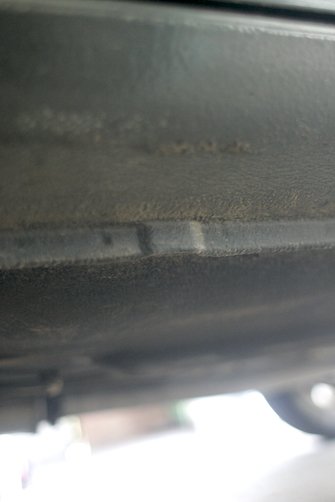

Gohn 62 Posted October 28, 2021 mine was up on jacks anyway there are 3 drain holes that run along the bottom rail and 1 rubber bung/plug the plug is located inside the rear jack point (in the pic its Left Rear) in a flat triangular section if your rail's straight it'll be easy to see the drain holes (if its taken a few whumps and whacks over the years the drain holes are less obvious) the drain holes are evenly spaced, the first one just to the rear of the front jack point, then the next two on down to the rear if these are clear, the sill never holds water unblock the 3 holes first with a bit of wire, hopefully the water that flows out will help to clear some of the mud then check the rubber bung a previous comment thought the water had got up thru the bung and drain holes but that would be unlikely unless you're parked in a pond... Share this post Link to post Share on other sites

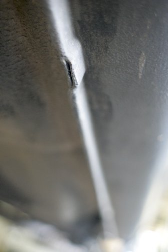

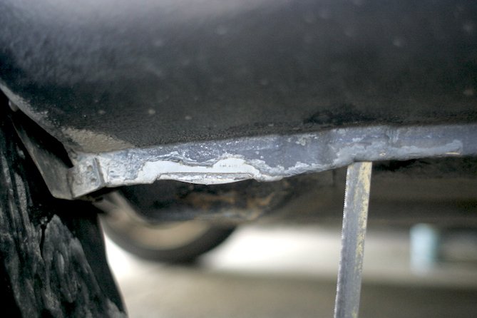

Gohn 62 Posted October 31, 2021 On 10/29/2021 at 5:17 AM, Steve K said: Does anybody have a picture of these holes er Steve, ignore my earlier post for it is wrong, sorry bout the bumsteer I've since had a proper look at the sill remembered unblocking my sill years ago but didn't know where from there are not 3 drain points, just 1, those pressed points along the sill are structural far as I can tell the only drain point is the one at the front I've taken a better pic with a thin hacksaw blade showing where the drain hole is at Front Left and I'm not sure on the round rubber drain plug at the rear? it may drain the sill but probably not sometimes the drain hole takes a whack or gets used as a jackpoint by mistake, if so you can easy straighten it back out and insert the wire to clear Share this post Link to post Share on other sites
