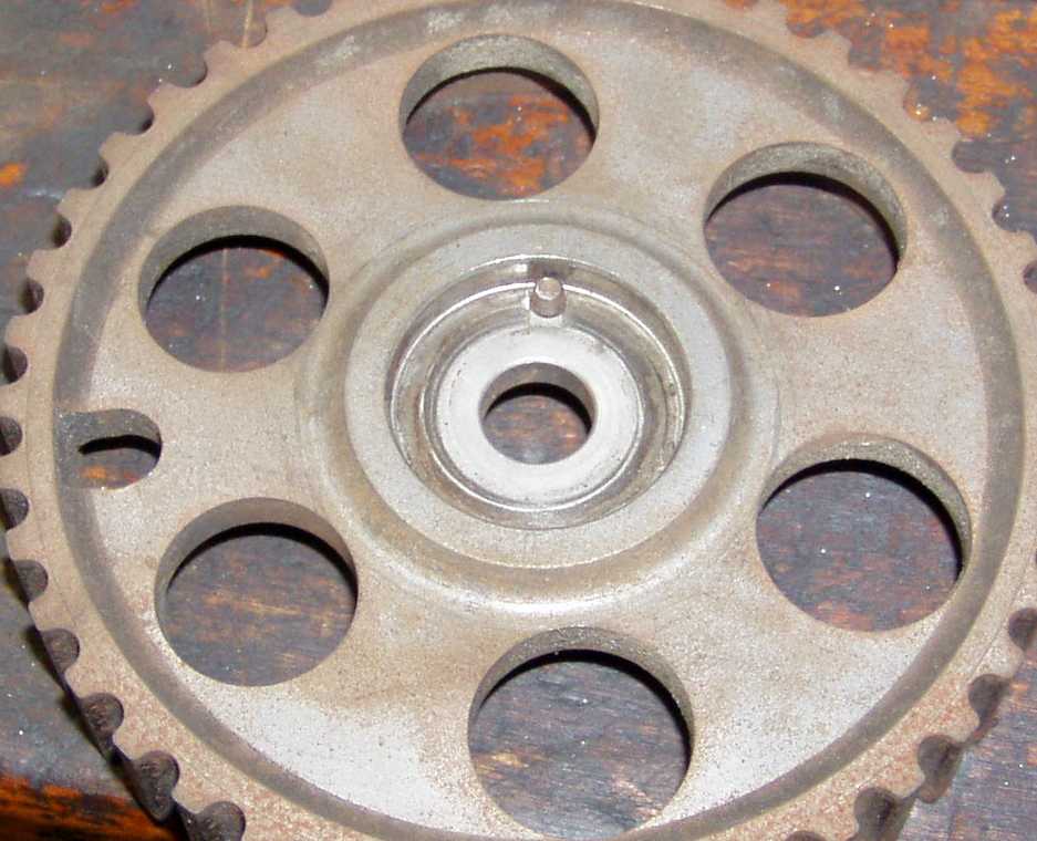

8V
1mm off the head needs approx. 4 deg. of advance (crank). If you also install a bigger cam at the same you need to advance it more. This could be 6-7 degrees depending on the cam grind.
I assemble the head/cam/belt first, then measure how much valve lift there is at TDC. I then work out how much the cam needs to be advanced to get the desired lift @TDC, in crankshaft degrees. Halve this figure for camshaft degrees.
The location pin is then removed from the pulley and the hole drilled oversize to accept an offset pin, turned to the required offset from above in camshaft degrees.
It's a little more tricky than a 16V offset woodruff key, but a fraction of the price of a vernier pulley.
Many folks skim a head, then loose what ever performance they've gained by the camshaft being retarded.
I can do exchange 8V pulleys if you tell me how much advance you want.

I am going to put an 8v head on from a XU10J2 engine on my 1.9 GTI. And i am going with a really aggressive cam (Kent PT27) of 304* and high lift. I am going to skim the head 1.7mm to raise the CR sine the CR will decrease if you just put a standard XU10J2 head on without skimming it.
Now i dont quite understand what you mean? Do you perhaps have some pictures of this location pin and so on?

Here's the pin on an early 8V pulley. It can be removed. On later versions the pin is part of the casting but can still be removed by drilling from the back.
When you remover the pin do you then set up the timing and find the new home for the pin,drill and replace? or do you rely on the bolt being tight and trusting threadlok?
maybe i'm asking a very stupid question!!
A new stepped pin goes into an enlarged hole. Because the washer covers the pin it can't fall out.
