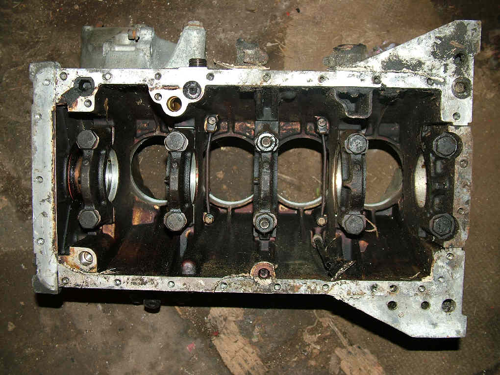

With the crank removed could I remove the pistons from underneath, swap the rings over to a set of 1.9 pistons and then fit these back in with the help of p.ring compressors?, or remove the pistons from underneath and replace the rods for 1.9 items retaining the 1.6 pistons and put in a 1.9 crank?.

pug_ham
I've attached a picture of an Mi16 block from underneath, there are no liners fitted & the only difference is the under piston oilspray bars but as I'm sure you can see, it would be impossible to get a piston out from underneath because there isn't enough space between the bearings.
Even if you could the piston ring compressor wouldn't clear the main bearing halfs in the block so there would be a gap between the end of that & the liner which would allow the rings to open & stop them sliding into the liner bore.
Graham.
matty_gti
