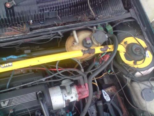

thats the way it gos, just thought a pic would be easier than explaining ;)

;) Brilliant that has clear up alot of things!,
did you use the 1.9 gti dizzy unit (bit b4 dizzy cap) or the Mi16 one? (1.9 or 2.0? or are they the same?)

thats a complete 1.9 gti dizzy,the adaptor can be used on both 1.9 and 2.o mi16s as mi16s never had dizzys,they used distibutorless ignition thats the reason why you need a adaptor to use a dizzy,if that makes any sense??
