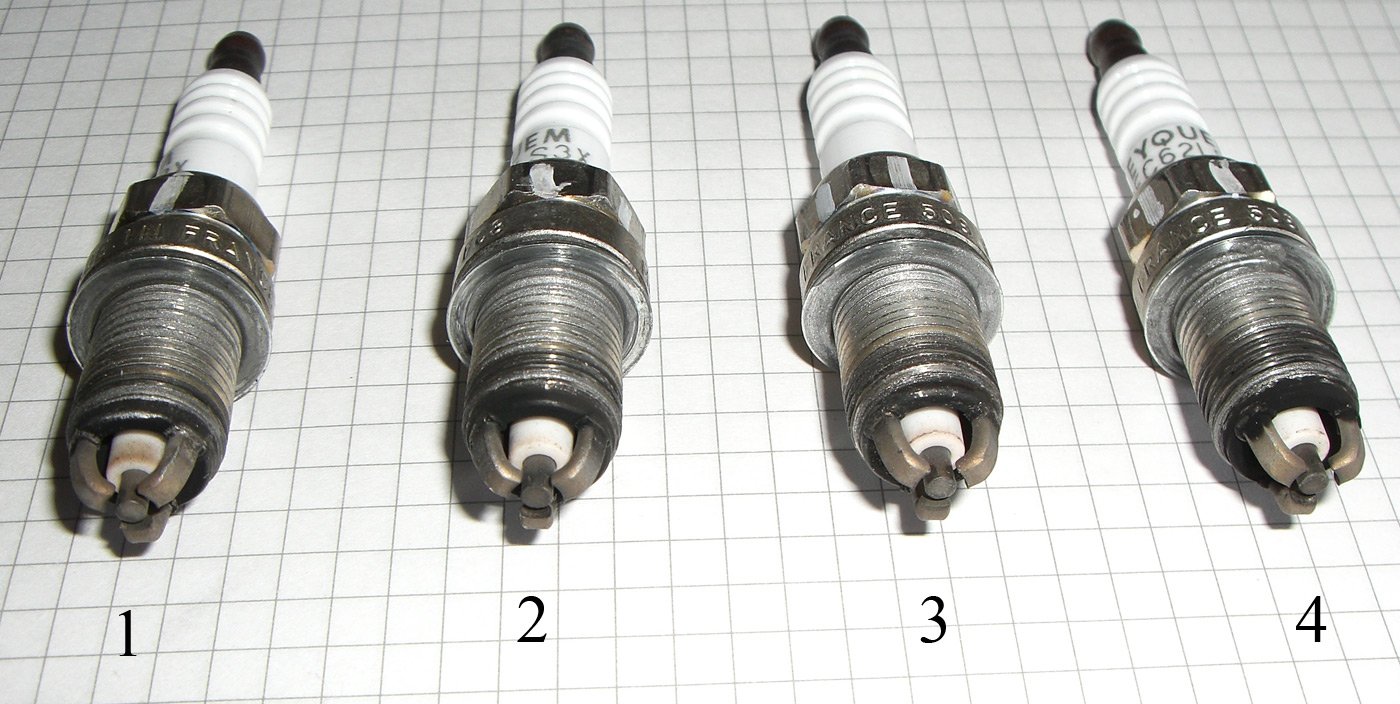

Took out the sparkplugs today and they seem to be in good nick and have the right color.
The TB's are only syncronized by me sucking and blowing through them while they still wasn't put on the engine, and I guess there's no need for furhter balancing as long as it idles nicely and plugs seem to have even color?

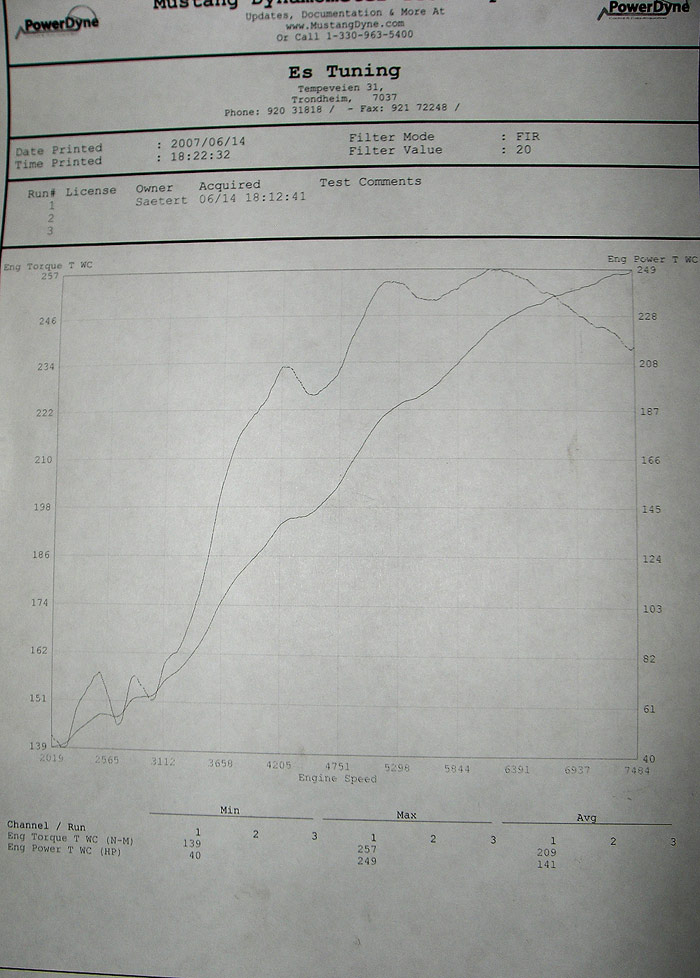

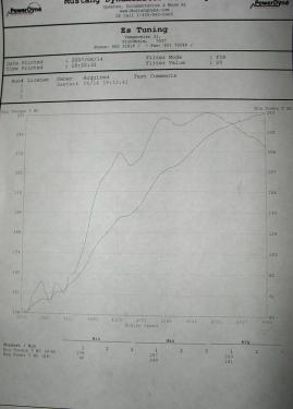

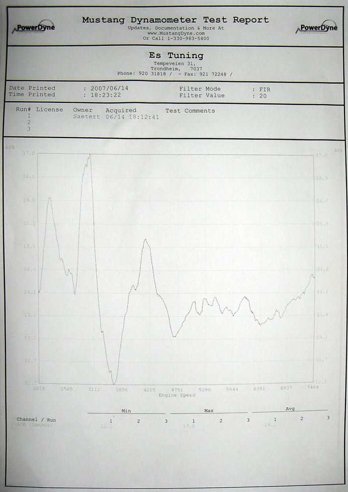

Just thought I would update this thread too with the engine results.
Powercurve and AFR after mapping session. As you can see the AFR need sorting out, K3 upgrade needed from Emerald before it can be done properly though.

250BHP @ wheels?
B1ack_Mi16
250BHP @ wheels?
Apparently, but the dyno must be over reading a bit.
But as "concluded" in the other post about the powercurves 270bhp is likely to be correct engine power.
