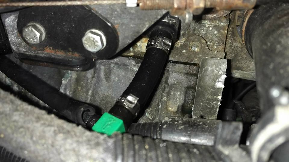

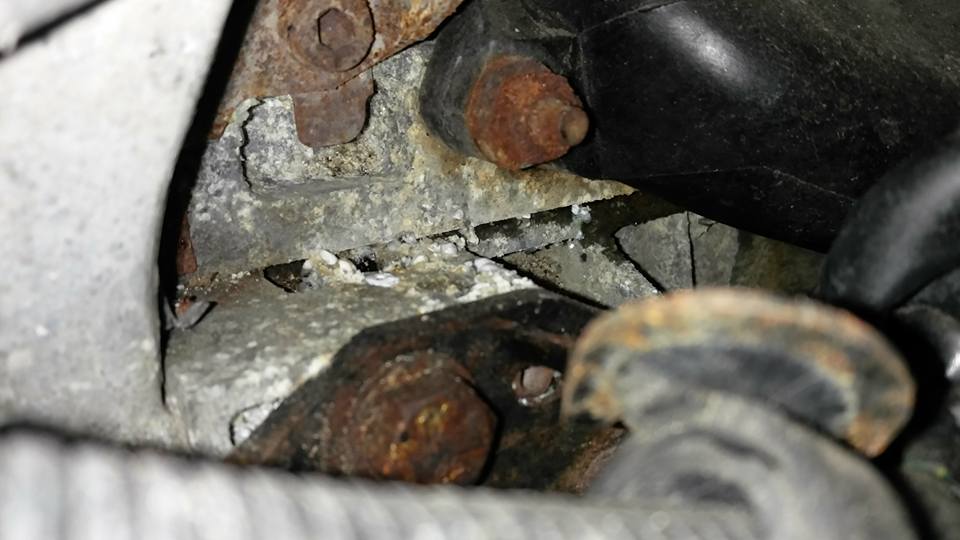

I let the car idle for about 30 minutes before it was put back. I noticed some steam coming out from under the hood when I drove the car in again, and after a quick inspection I'm 99 % sure that the head gasket have started to disintegrate. Water is leaking out between the block and the head, and it seems that it's all the way across the engine (at least where I could see). There was no smoke, no oil in the water, water in the oil or hard cooling lines.

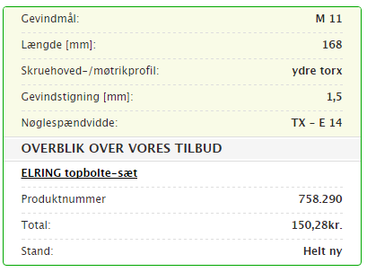

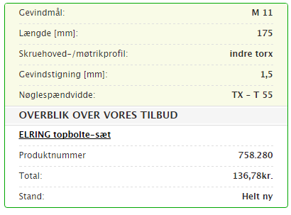

I ordered a new gasket, head bolts and some other small things I would imagine is worn. But after reading a bit about the XU engine, I discovered that there are different kind of head bolts. The car right now have inside torx head bolts. I have ordered head bolts with a outside torx head. I didn't notice untill after I made the purchase that there was a difference. Other than the head of the bolt, they are exactly the same.
Can I use my ordered bolts, or do I have to get a new set? I read that if you use bolts with a normal six-sided head for a car that originally had torx bolts, you could strip the threads in the block.

Okay, I took a second look and think I need to purchase a new set :(
Both sets are from Ering. I've bought 758.290, but I should have bought 758.280. Besides the head of the bolt, the lengths are different. Could it be that the bolts I purchased is for a TU engine? That would suck :(
EDIT: The TU bolts seems to be M10x1.5. I wonder what the bolts I ordered are for then. I don't think I'll use them if the XU is known for thread stripping. Those 7 mm of thread on the correct bolts may make the difference between a succes and a failure..
EDIT again: I think my new bolts are for the 16 v version. The parts finder came up with the wrong bolts because my car is from 1998, and Peugeot apparently only made the 8v version untill 1997. However, my car IS build with this 8v version, perhaps a special production for the Nordic countries or something. I don't know. But I will have to purchase a new set of bolts.. Just glad I discovered it now and not after I pulled a thread or something! :unsure:
