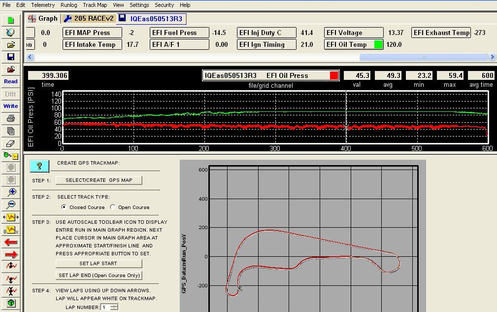

If you're not dry sumping you should also consider an accumulator. Here's a datalog from my car, with extended pickup, deep sump etc. The accumulator does a fantastic job of smoothing out the bumps. The pressure gradually decreases due to oil temp increasing.

Ok; oil accumulator it is.

I can second the accusump plan. I had one on my last Integrale. With a timer relay controlling the solenoid valve, I could also have oil pressure before the engine turned over too. They are a great piece of kit. The only snag is finding the space in the engine bay to install one. I ended up with the battery in the boot in the 'grale.

How can you argue with the facts (ie graph) when it comes to an accumulator? Sure, I've moved on to a dry sump and that's almost bullet proof (until the belt breaks). In the world of circuit racing, it just comes downs to G forces and how much tyre you can grip. A good 205 on slicks needs a dry sump, there is no denying. Until the UK gets AO50's, you can do a lot worse than fit an accumulator to even out the spikes in the oil supply.
I used a solenoid originally but I found a manual check valve dumping straight into the oil gallery was better. There was always 1.5L extra in the sump at start up, but this immediately returned to the accumulator as a reserve. Until someone posts some data suggesting otherwise, I believe it is the best wet sump alternative.
Andy
Agreed . Head of oil at 60 plus psi directly into the main oil feed gallery. A great way to protect a hard used engine at a fraction of the cost of a full dry sump setup.

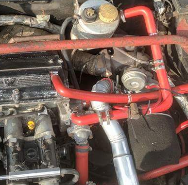

Saw this on eBay and thought of you after reading this 282409094127 great project
whats the thickness of a pulley got to do with the body of the pump being in the day of a dirty great turbocharger?? :lol:
Looks like enough space in that hole to me. More pics in the for sale section.

wicked
Peter, this is not a twin scroll. The twin scroll VF38/TD05 turbine housings are huge and you'll need the space there to get the double runners towards the turbo.
Wrt the manifold; I don't know if the GTI6 manifold is a good starting point in terms of material thickness; it needs to carry a turbo now.
Keep in mind that you need to merge cylinder 1 & 4 and 2 & 3 and both need to end up at the turbo.
