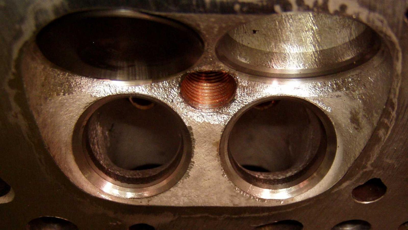

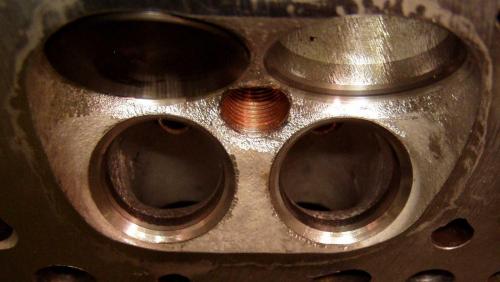

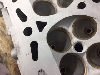

Oh. Valve guides. Expert guidance from none other that Guy Croft of Fiat/Lancia twin cam fame who looked at my guides, then asked if I was building a full race engine. When I said not, his judgement was to lap the exhaust valve seats , as the exhaust guides were o.k and fit K line inserts to the inlets, although he felt that even they were not bad, certainly no where near bad enough to replace.
So the head might not be quite as expensive as I had feared. He also commented that someone had been busy with the porting and had done a good job. Unfortunately, the same could not be said for the valve seat fitting which had left the inlet valves badly shrouded at low lift. Fortunately, that is not too difficult for me to remedy . I will take a detailed photograph to show what I/ he means
Andy
Valve shroudingpost-26334-0-40235900-1476818563.jpgpost-26334-0-91395800-1476818574.jpg
looks like they've been cut back quite heavily, checking spring installed heights might be wise
Andy
Yes. They have. Petert has given me the guidance on checking installed spring heights to make sure I get the correct load on the valve at zero lift. It is also the reason why replacing the inlet guides is now not advised as a seat recut would be required,uncutting even further . A shame really as the porting has been done well; odd that the seat replacement was not of the same standard..

Yep. The seats have been replaced at some point. I went along to the engineering company who are doing the crank balance for me clutching my cylinder head and valves. They confirmed that the valves were fine, the guides were showing signs of wear and the valves were shrouded at low lift. Their plan is to use K line inserts for the guides and then recut the seats with a clever machine they have that can radius the area immediately beyond the seat as it blends ( or doesn't currently) into the chamber. So, I am going to leave it with them . They did agree that If I was not happy with the outcome they plan, they would replace the valve seats and start again. I hope that will not be needed.

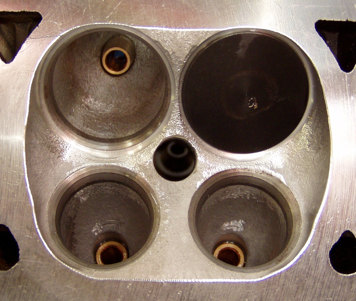

https://flic.kr/p/HsFQSZ
thats the 3 angle job my local guys did with their serdi machine, hard to see but the 3rd angle cutter has done a nice job in the port smoothing it out.
Andy
That is a good job. I will be delighted if mine turns out that well
It's impossible to get a proper 3 angle cut on the inlet with a standard size valve. The ID of the seat is usually always too big to begin with. Only by going to a larger valve do you create the correct geometry.

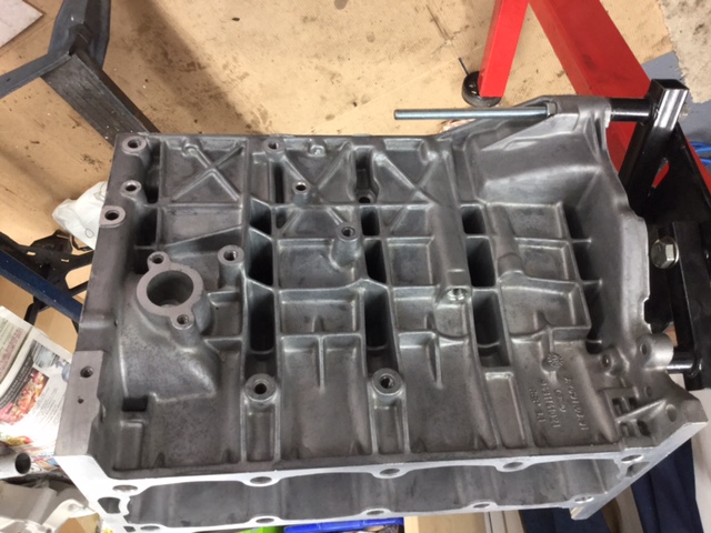

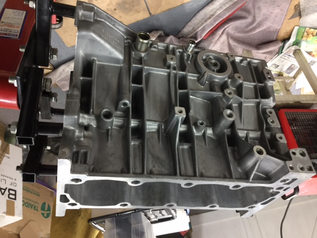

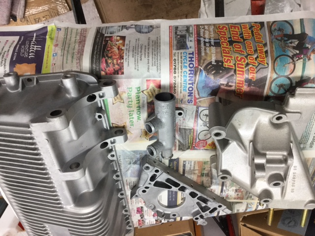

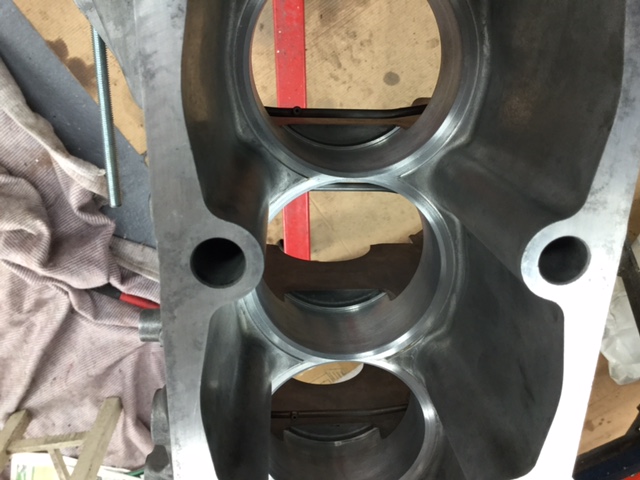

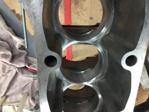

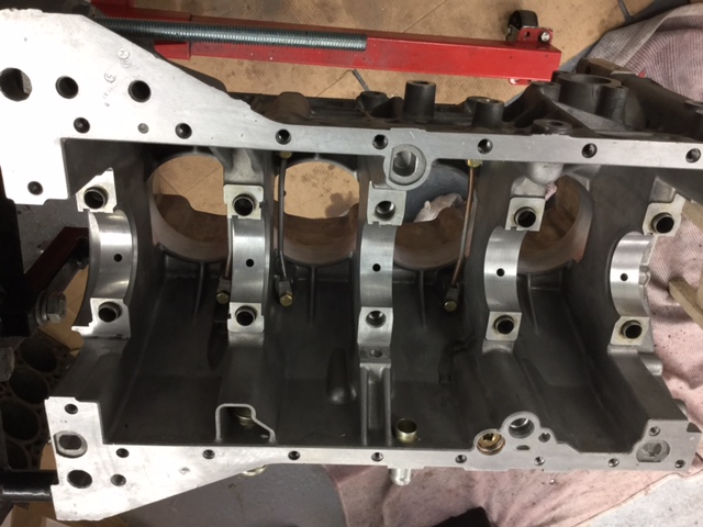

A little progress today after lots of cleaning and prep work . Oil spray bars and a couple of oil gallery blanking plugs installedpost-26334-0-07627700-1478263094_thumb.jpgpost-26334-0-50851900-1478263112_thumb.jpgpost-26334-0-76042800-1478263125_thumb.jpgpost-26334-0-42662000-1478263145_thumb.jpgpost-26334-0-66670000-1478263157_thumb.jpg

That looks awesome and very clean, did you have the liner seats recut?
How are you measuring the liner protrusion out of interest? I've seen the rebuild manual is a flat plate with depth gauge but I was going to use a precision straight edge across the liners and feeler gauges to the block, not sure if this is the right procedure.
Andy
I used a precision straight edge and feeler gauges . As for the liner seats, scotchbrite and elbow grease, although to be fair, the inside of the block was pretty clean to start with. Then I gave the block a thorough wash in Jizer, with long thin brushes for the oil holes and main oil gallery, followed by a bath in very hot soapy water , followed by an airline, followed by brake cleaner and the air line again.

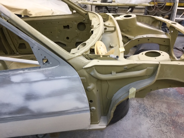

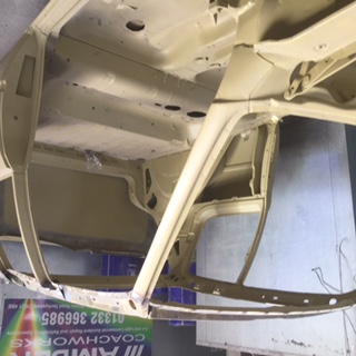

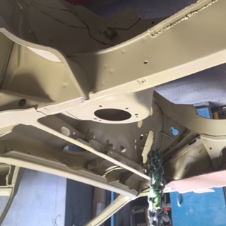

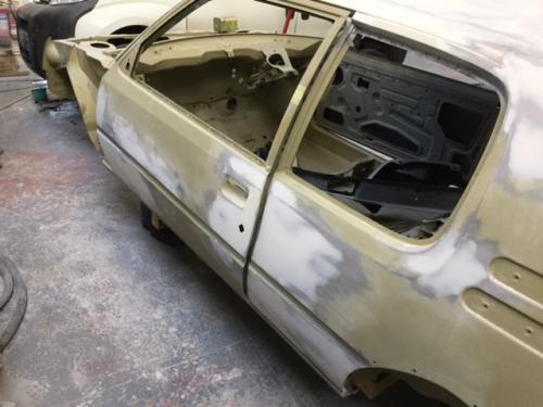

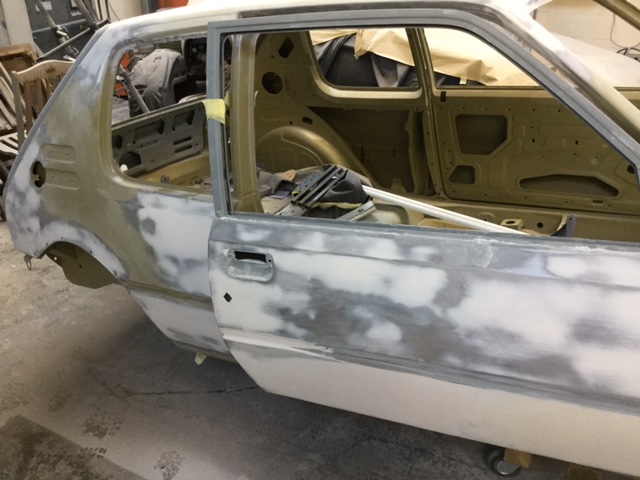

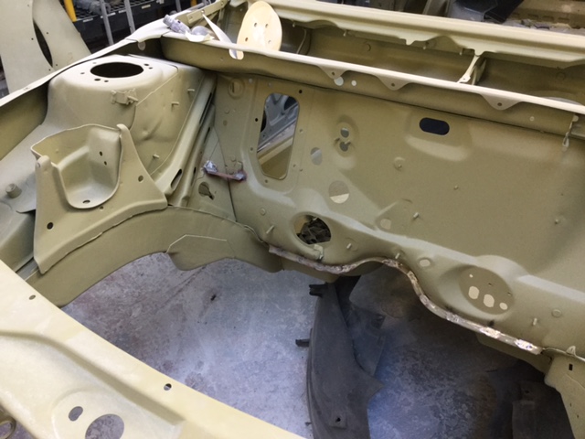

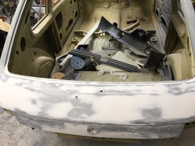

I visited the body shop today to look at progress. Nearly ready for primer which means I will be able to spend a couple of days over there doing all the seamsealing and painting the underside with epoxy mastic . I should have a complete shell by Christmas!post-26334-0-58997800-1478803837.jpgpost-26334-0-45529800-1478803908.jpgpost-26334-0-65158100-1478803931_thumb.jpgpost-26334-0-52577900-1478803947_thumb.jpgpost-26334-0-52417700-1478803975_thumb.jpgpost-26334-0-54450800-1478803995_thumb.jpgpost-26334-0-55109900-1478804014_thumb.jpg
Andy
Looks like lots of filler but in fact, very little. Just that Neil( the body man) found lots of little dents that he wanted to fix.
