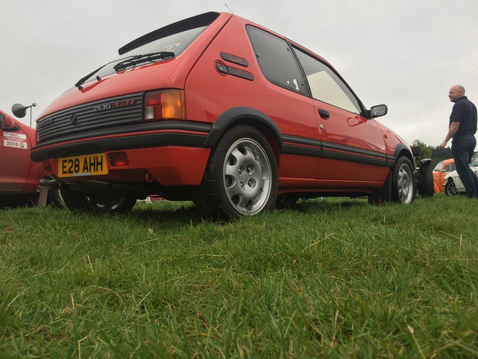

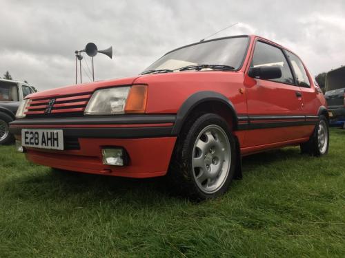

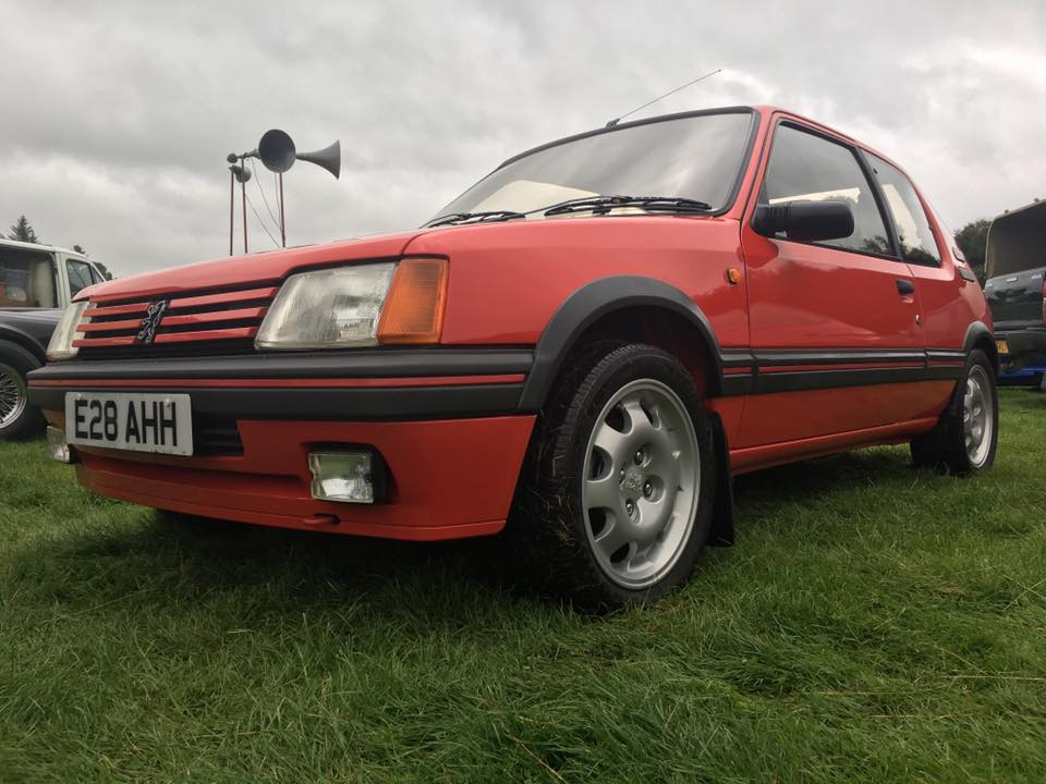

Just a couple of photos of the car at our show today. It was quickly put together just to get it there, but the paint and trim still all need finishing off but it was looking brilliant.

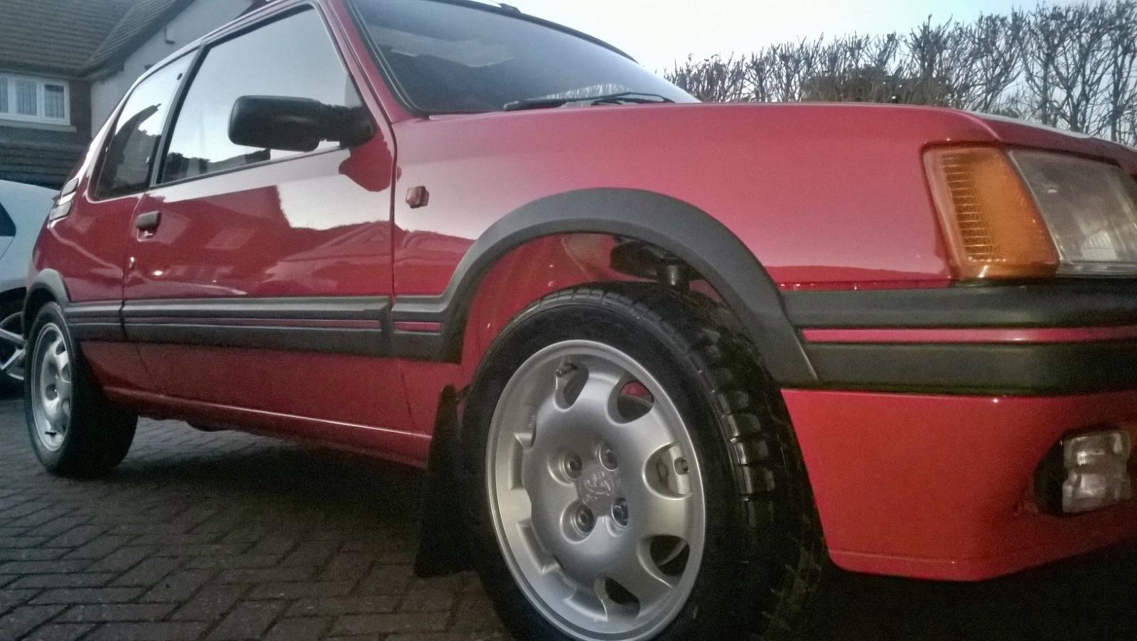

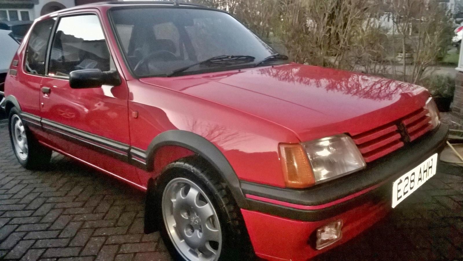

Well it was a bit late but it has now come home, almost a year to the day that it went away. But it looks brilliant, no rust or even dirt anywhere, just too good to take out in the heavily salted roads around here at the moment. Really pleased with how it has turned out. Just need to find a grey two pin central locking motor for the passenger side door and then it will be finished.

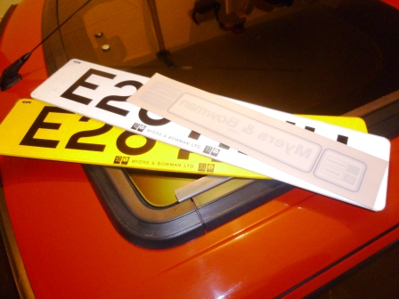

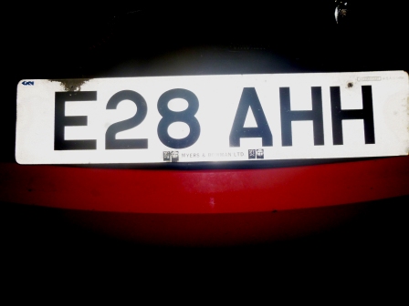

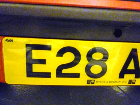

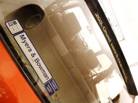

Ordered up a new set of the original dealer plates and rear window sticker from DMB Graphics. The first photo is the 29 year old original plate and the other 3 photos are the new plates plus sticker. They are exact replicas from photos I emailed them, they even included the original GKN logo at the top left hand corner of the plate and the dealer sticker is exactly the same as the original. Took less than 7 days from initial e-mail to delivery, superb service and thoroughly recommended.
Not a bad present for the old car's 29th Birthday tomorrow :)

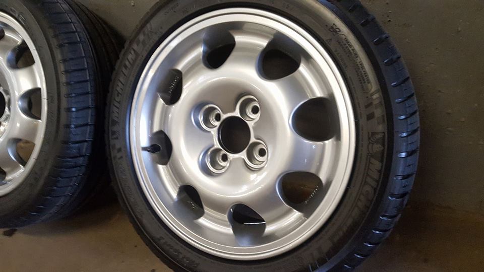

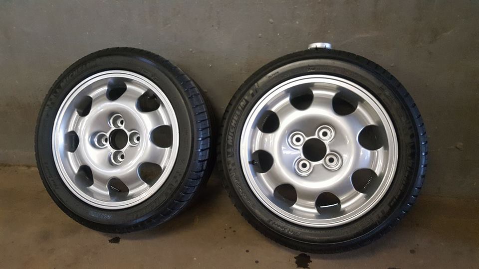

Just bought a set of the rear bumper mounting bolts and rubbers from the bloke in Czechoslovakia and had the spare Speedline wheel and one of the others repowder coated. Well pleased with how the spare turned out as after 30 years underneath the car as it looked like it had almost dissolved. Swapped the old Yokohama A539's for Michelin Pilot Sport 3's as it had Michelin MXV's from the factory. Would have liked to have used 185 55 15's Michelins but they only come in Michelin Energy's.

205Rallee
Yep and a cracking job they did. Just waiting for some dry non salty roads to give it a run out :)

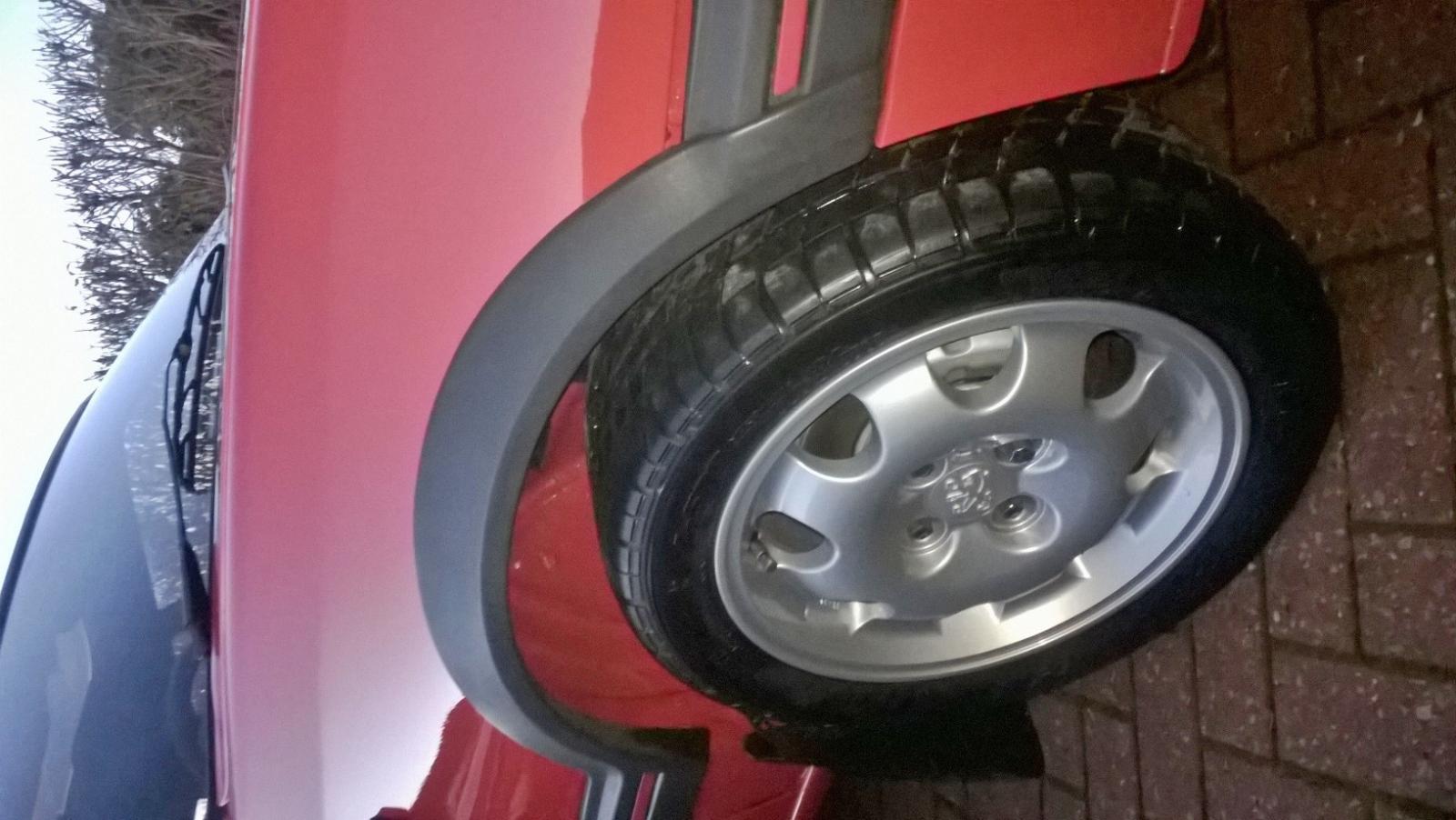

Finally got around to fitting up the wheelarch trims with starlock washers, didn't use Peugeot ones just got hold of a load from a teddy bear shop(!) for £1.95 including postage. Replaced the rear bumper side mount bolts and rubber buffers with a set of new ones from the bloke in Czechoslovakia off e bay. Then had a look at the front bumper slider bolts and rubber buffer, well the buffer was like new but the top hat nut/washer thing had totally dissolved. Couldn't be bothered waiting for a new set to come from Czechoslovakia so I bought some M16 stainless steel washers and some M8 stainless bolts along with M8 motorcycle fairing rubber nuts, Using the original rubber buffers it looks spot on and cost me about £6 with enough to do three front bumpers.
New hatchback struts fitted, along with an interior light switch (the one in the A panel by the door stop strap). Other than a few electrical glitches it's all finished and sitting under its cover. Not got any excuses to go in the garage I'm getting withdrawal symptoms !
