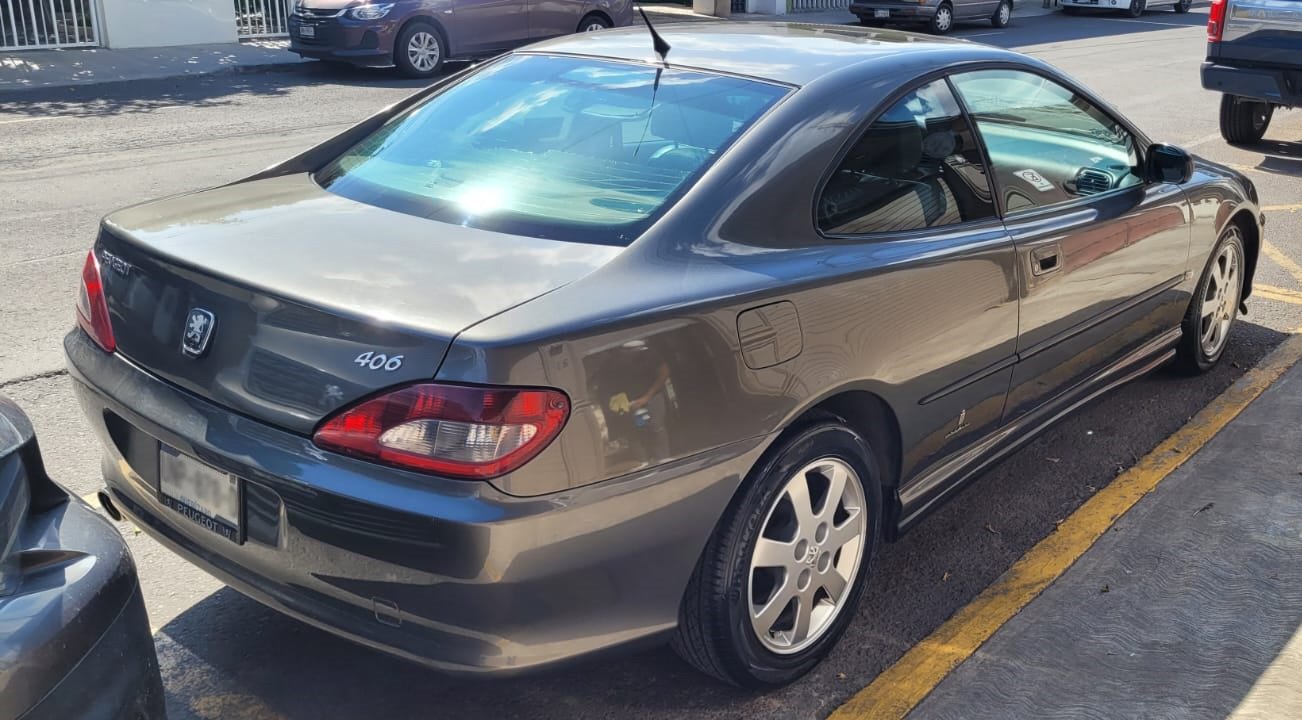

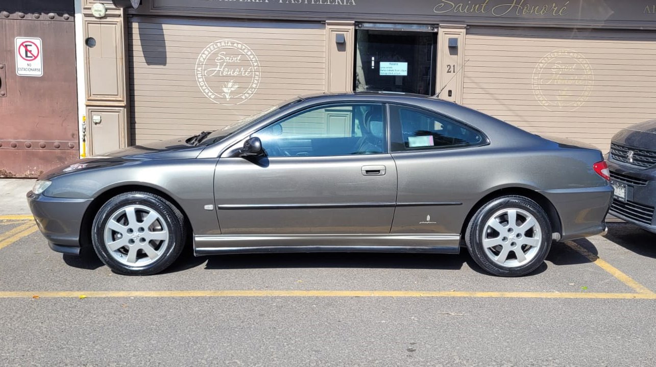

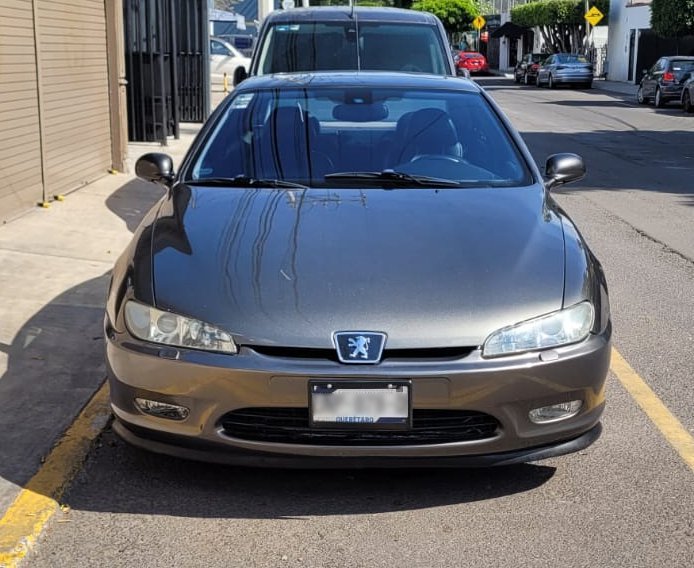

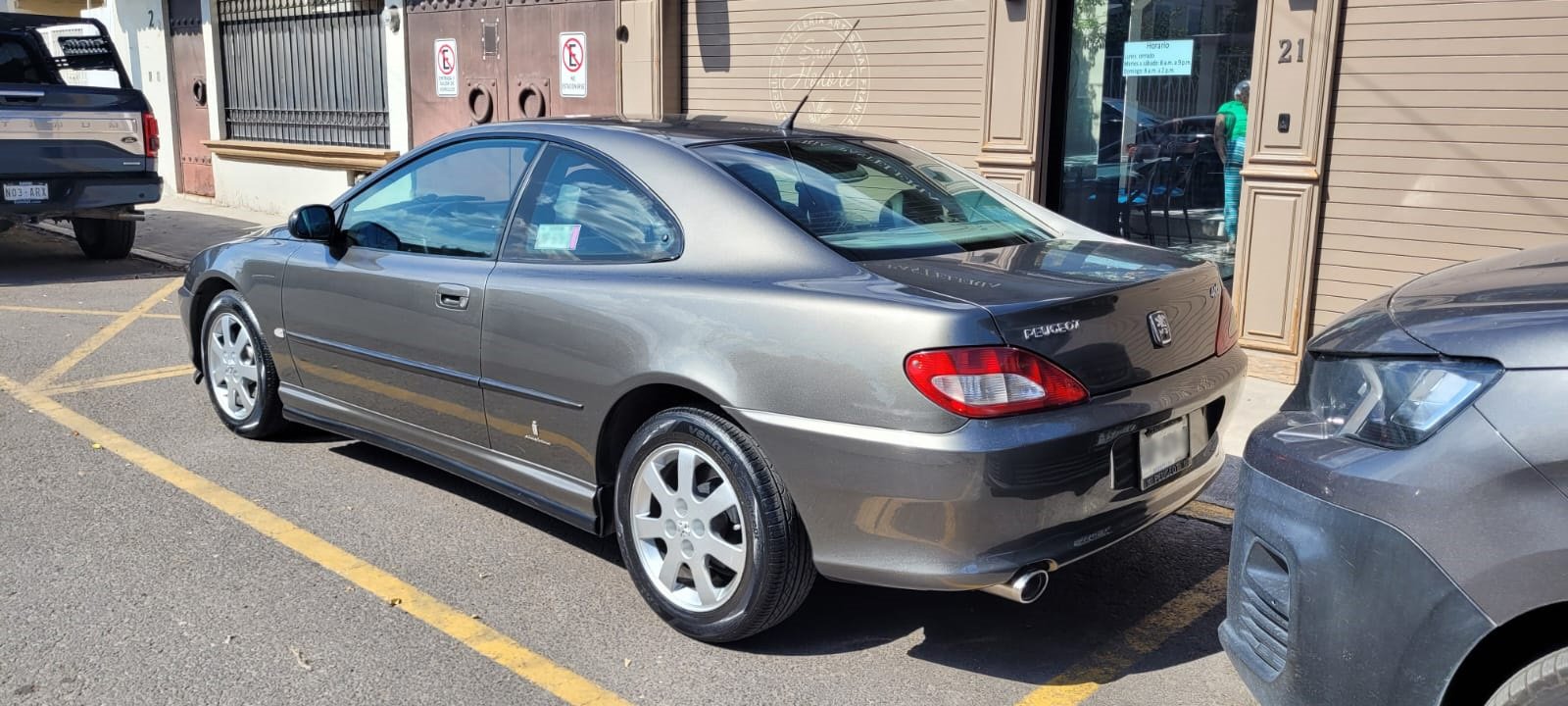

Mr_bugatti 10 Posted November 19, 2016 before eibach after ... Share this post Link to post Share on other sites
Mr_bugatti 10 Posted November 19, 2016 that is what the car looks like after the installation ... the ride is not bad .. i noticed no difference ... I just got the car registered and got my mexican number plates a few days ago so now I have been driving a lot it all around the city ... i noticed only 2 things ... a smell of gas fumes and the dash ... it seems to be a bit loose .. if I drive through a bumpy road it makes some noises ... anyone know how to make these rattle noises go away ..? is there any certain bolts i should check ? Share this post Link to post Share on other sites
