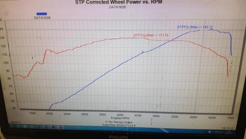

I will put up the dyno printout when I suss out how to do it now that Photobucket seems to be a no go .

I was expecting a little more BHP I suppose but if I am reading the sheet correctly I have at least 115 Lb/ft of torque from 2100 rpm to 6400 rpm which makes it nice to drive .
your figures sound like wheel numbers, flywheel torque on a standard 1.9 is more than 115, so 140 bhp at the wheels is a good result.

http://s928.photobucket.com/user/hoodygoodwood/media/ANDY%20PUG%20DYNO_zpspnw4tuzv.png.html?sort=3&o=0
Sorry its a dodgy link but photobucket does seem to be working .

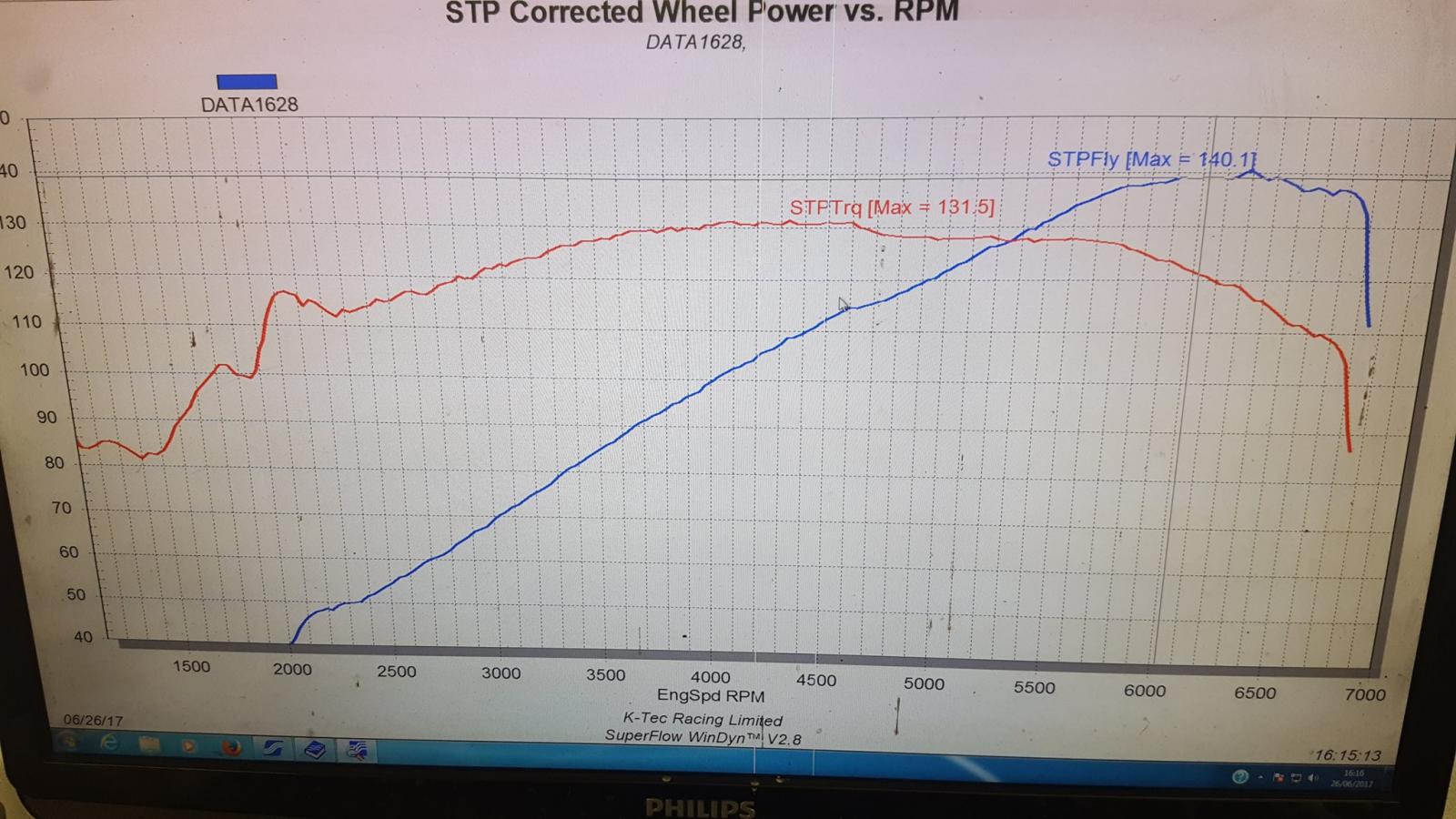

As you can see maximum power is 140.1 BHP at 6200 rpm , torque is 131.5 lb/ft at 4500 rpm .
Standard 1.9 GTI is 130 BHP at 6000 rpm and 119 lb/ft at 4750 rpm .
Have checked with the tuner and these are calculated flywheel figures not at the wheels .

It's about right from building these in various spec's, the std inlet manifold isn't great with a 285 cam, With bodies they make around 150>160 bhp, also the K tec roller's are realistic generally and have had a few car's on other RR days find a extra 10bhp out of thin air. As we know Figure's mean little its how it drives

Graph from the RR
