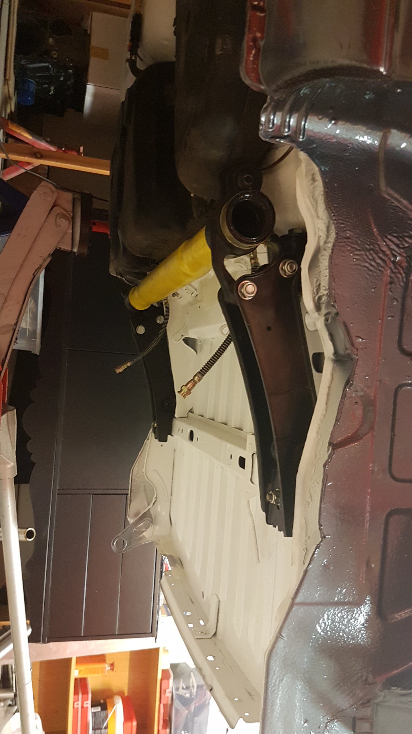

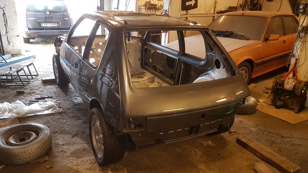

Not much progress lately. But managed to put the rack together yesterday.
Still need some hydraulics and rod ends, need to put it on car before moving it as now both wheels live their own lives.

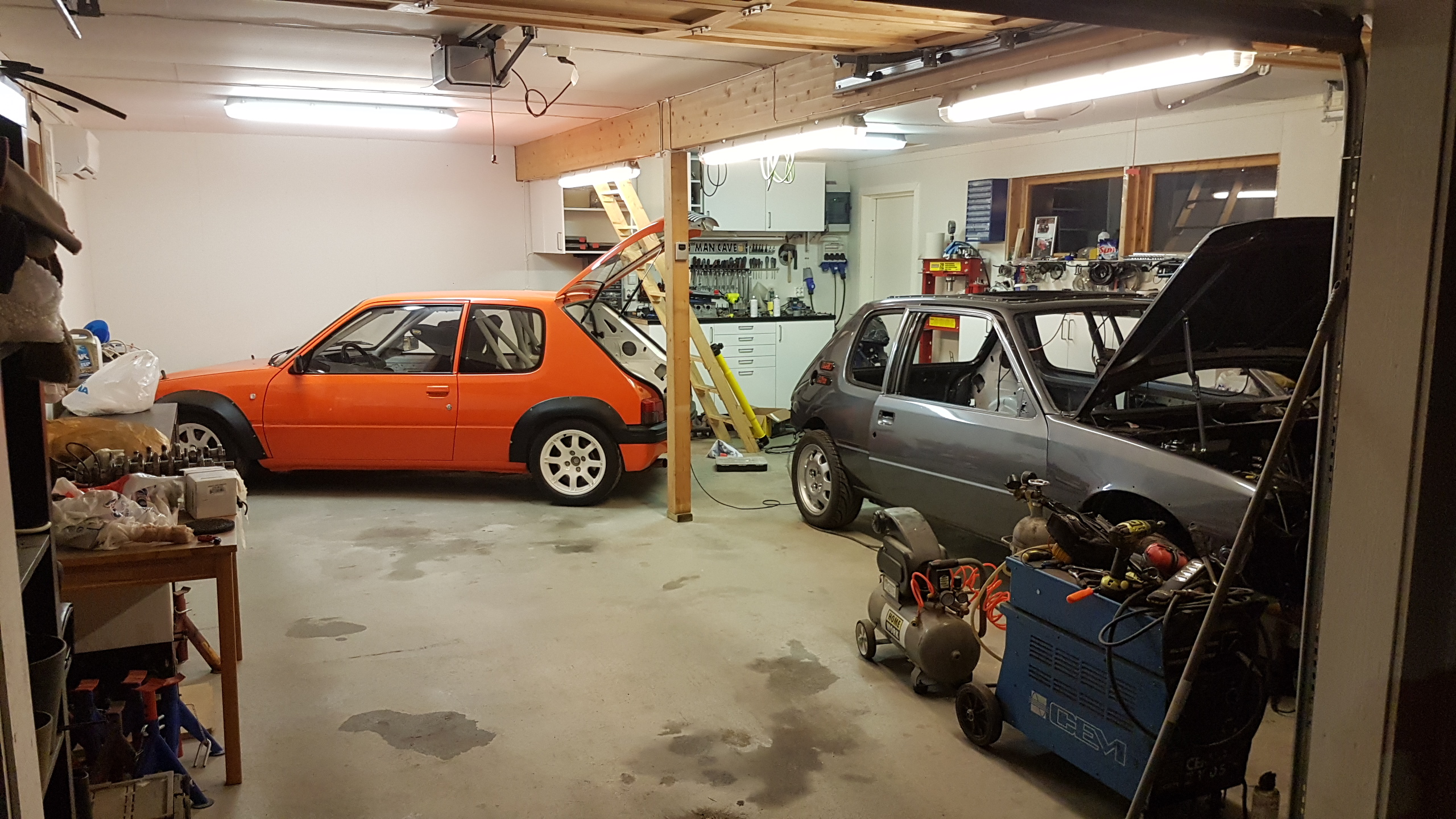

It's not my workshop though, just my garage at home where I try to do as little "dirtywork" as possible to keep it kinda clean.

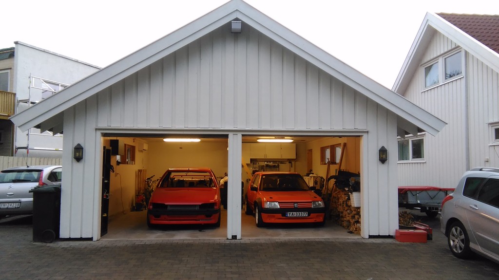

However I'll move the 205 here to do the assembly work.
It has the space for all 3 of them, 2x205 and 1x405. Just waiting for the last 205 now.

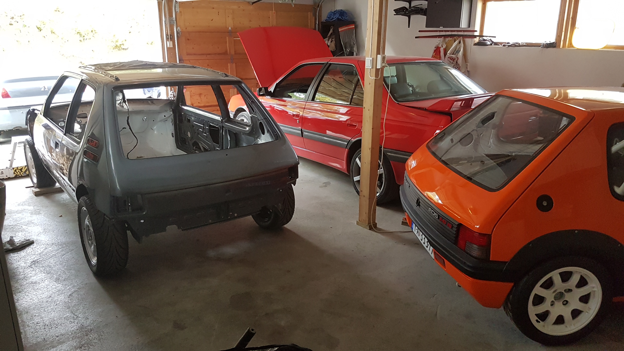

Got myself a 20t press this weekend, and cleaned up the workbench a bit. Need to tidy up a bit more before I take the 205 home to start assembly.

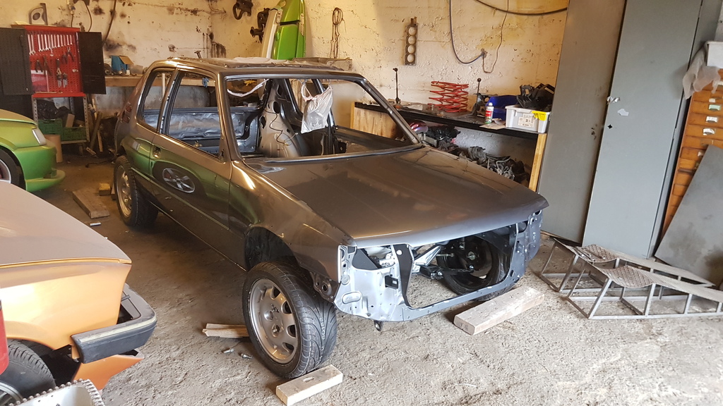

Went to the garage yesterday, put on rear dampers, steering rack and the new wheels/tires.

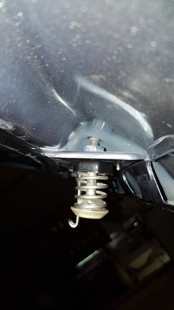

Was mounting some small stuff in the front yesterday, and got a bit sceptical about the bonnet lock.
Is it supposed to be some spacer between the bonnet and the part with the pin or can I just bottom out the threads?
Can't really understand why it has so long threads. Any risk of making a outwards dent in the bonnet?
its so you can adjust the bonnet height
B1ack_Mi16
Ok, so it shouldn't necessarily be bottomed out, but it can be without touching outer skin?
I thought it should be bottomed out and the bonnet height just was adjusted on the sides with the two rubber stoppers one on each side.

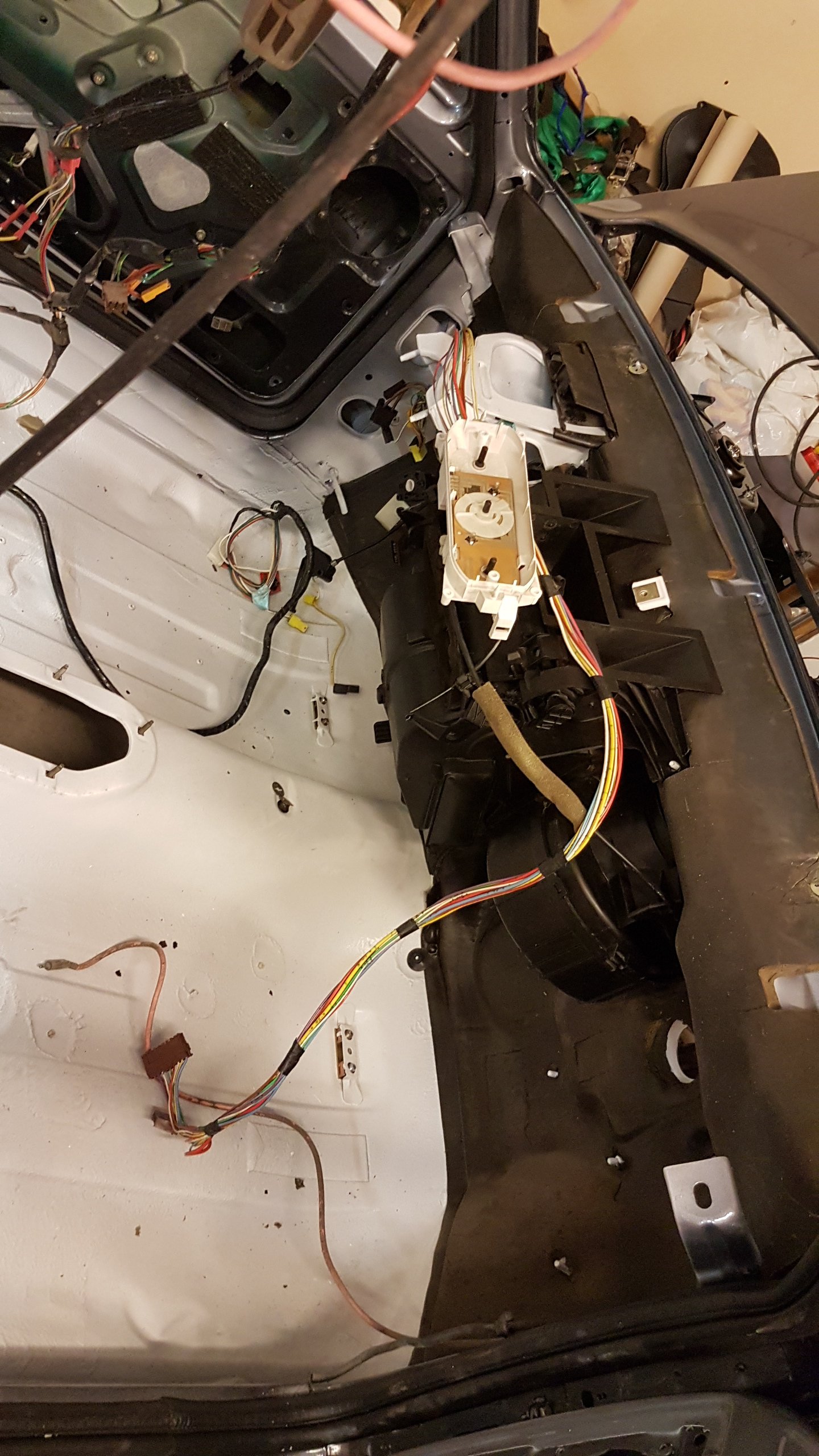

Hi guys. Are these two connectors for the engine sensor loom / tacho and live/switched 12v for engine management loom?
I'm starting to look into getting the wiring back into the car.
Wires in the middle below image center.
jackherer
Yes, the thick red wire is switched 12v, it should be numbered 2 and the tacho input is wire 112 which should be pin 4 of the smaller 6 pin plug, I think it is the thin blue wire in your photo.
B1ack_Mi16
Ok, so it is indeed the right plugs at least then. Just what I needed confirmed :)
jackherer
There is a spreadsheet with the full pinout here - http://www.205gti.com/downloads/wiring.xls
Be aware that the pins for switched 12v and the starter solenoid feed are sometimes swapped over in position, this appears to be the case with your car.
