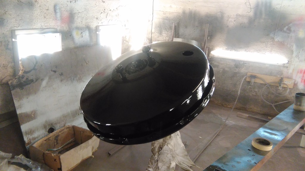

Btw. do anyone got experience using a 255mm brake booster from a 405. I believe it will fit at least. Found one and decided to spray it at the same time as the rest of the parts.
Thinking of using a 22mm master cylinder from the same 405.
a 200mm servo is about 10mm away from the scuttle panel so I doubt a 255mm one will fit.

Ain't the standard 205 GTi one 225mm?
jackherer
There are space issues in right hand drive 205s so even GTIs only got a base model 200mm servo.
B1ack_Mi16
Ok. it seemed to be about 10-15mm clearance on my track car (which I guess has a 225mm item) when I looked this morning.
Meaning it might be possible or just not...
Will just have to try it I guess. 15mm is all that's needed.

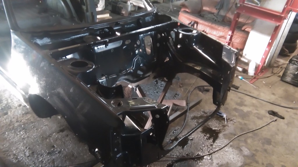

Managed to prep and paint the subframe today, re-did the brake orginal 225mm brake amplifier as the 250mm one did not fit.
Also continued the cleaning today, pressure washing with white sprite inside arches etc.

Painted the 3 wheel arches that didn't have paint this evening.
Tomorrow I'll put on the rear beam and see if I can move it to the paint booth.

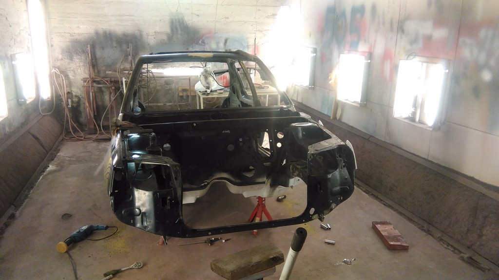

Have moved it to the spray booth now. Still some rust removal to be performed before I can spray it in the white paint/primer.

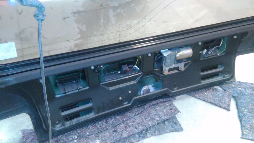

Is it possible to remove the rear windscreen rubber and re-use it? I.e. take it off prior to cutting out the screen?

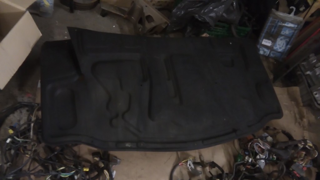

I removed this from the bonnet, I guess it does not really do any sound-deadening at all, so might not be worthwhile to put it back?
yes, the trim should come out easily enough, take care not to stretch it, sometimes they can be a bit stuck to the sealant if there was excess squeezed out the sides.
if the screen is good and no corrosion under it I'd leave it in and mask it.

Agree if I can get the trim out and no sign of corrosion underneath, I'll mask the screen.
However wonder if I'll be able to get the trim on again after painting. A lot of lubrication is probably needed.

Did not manage to save the rear screen rubber... sat more or less totally stuck :)

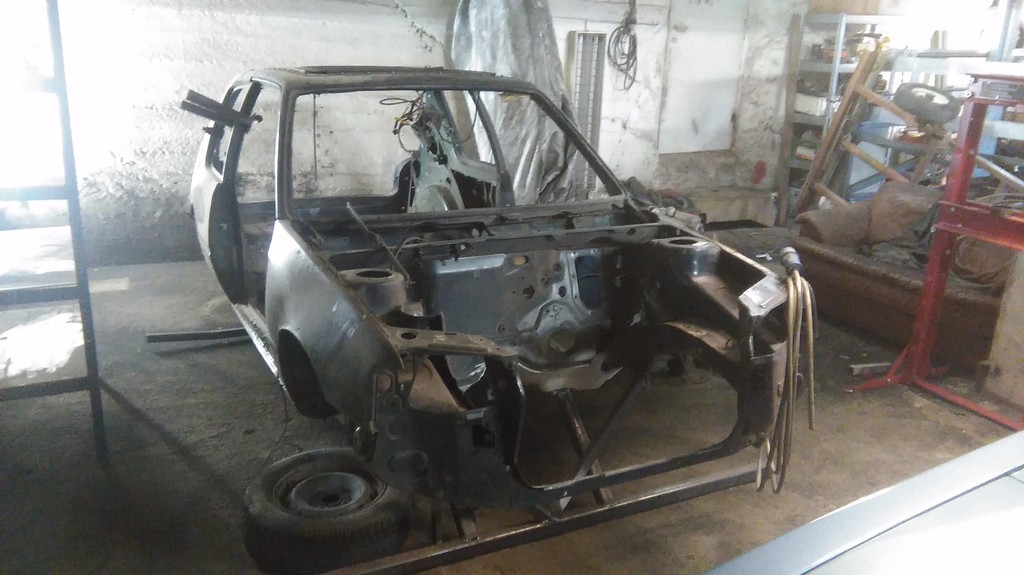

I've been busy with some cleaning up and sand blasting lately though.

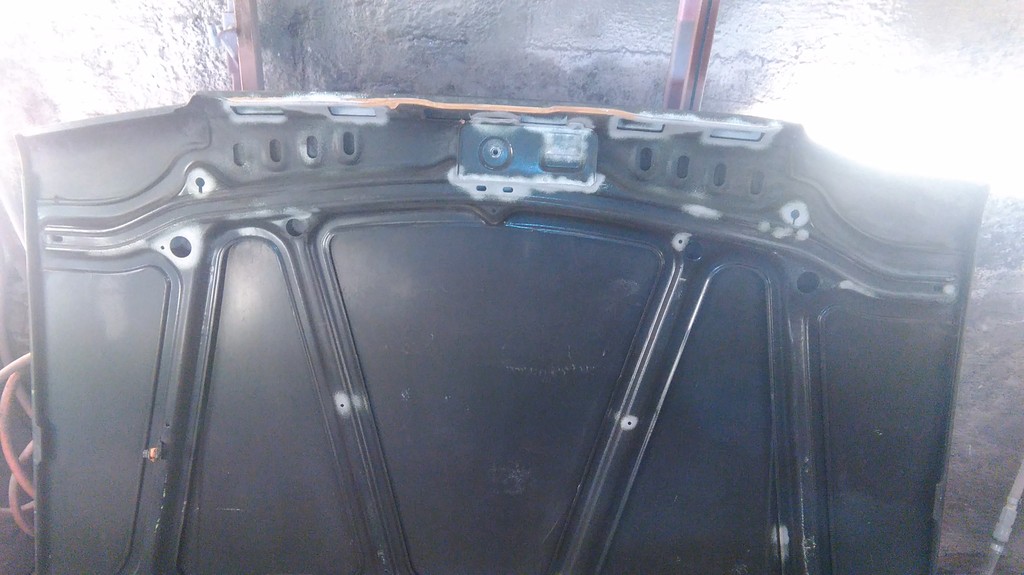

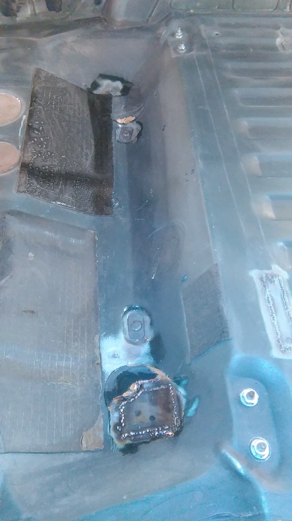

Inside of bonnet, quite some rust under the sealant just at the very front, and also around most of the holes in the inner skin.
Chassileg
Inside of the threaded rods for fuel tank support was blasted and given an oil treatment. More or less all the normal places of this car has some rust, even though it's a low miler and late model 1991.

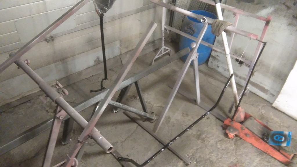

Some more slightly progress, painted the gear rods and the front ARB.

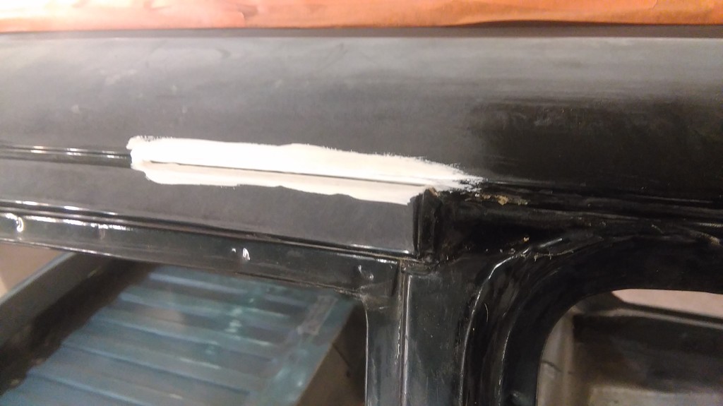

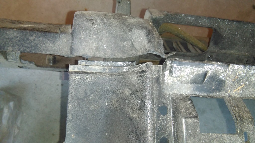

Also did some more sanding on the car in general, and cut out part of the cracked seam sealer above the rear side windows. Painted it with a brush now just to protect from corrosion. Adding new seam sealer next time probably.

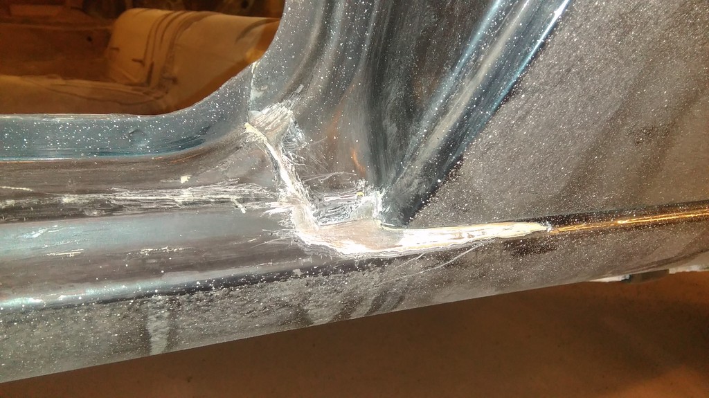

B-pillar to sill is starting to let go of the paint, however the zink layer still seem to be more or less present, so no real corrosion yet. Need to cut out the old seam between sill and rear panel next time and get a better view of this area.

Paint was indeed getting loose at bottom of B-pillars. Scraped it a bit and cleaned up the area.
Painted it locally before adding seam sealer.

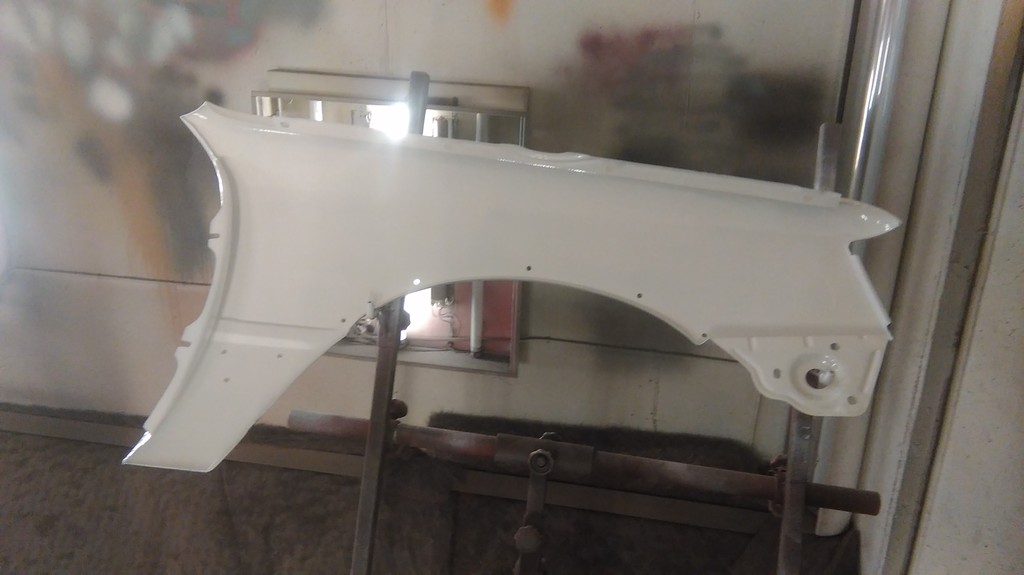

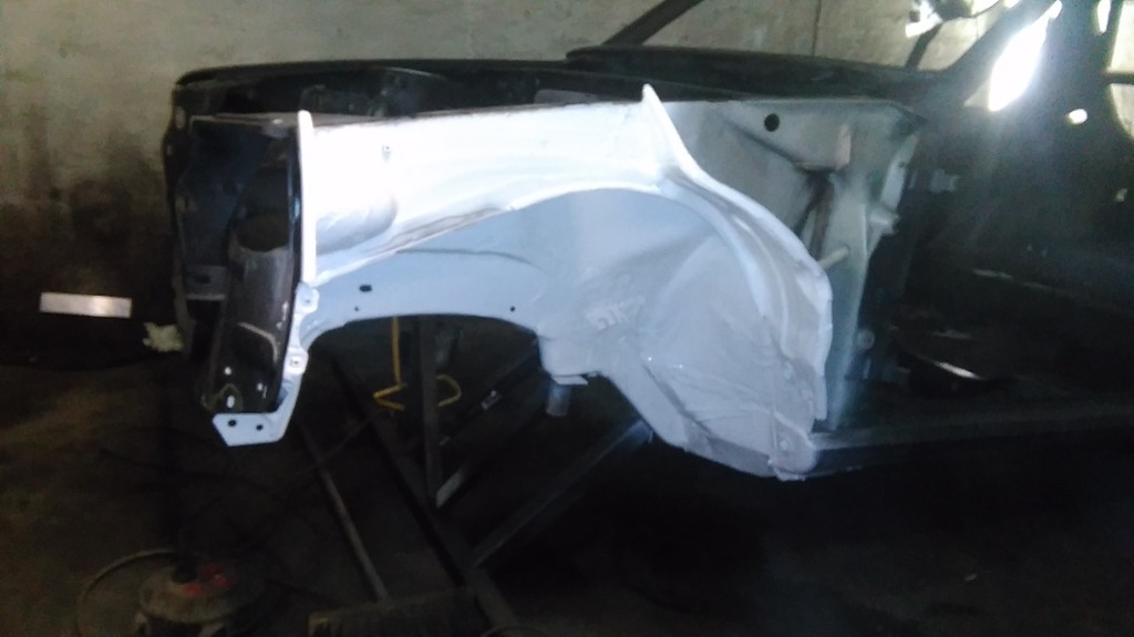

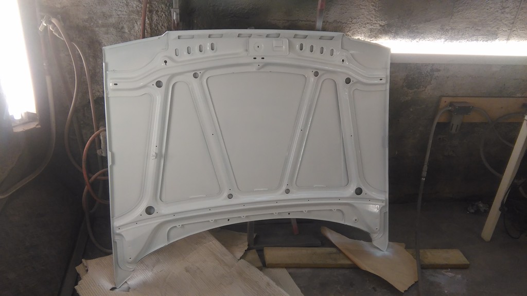

Also painted the rear of the bonnet in white as primer
And the inside of the new left wing

Had a go yesterday too, and had to cut out more of the sealant between sill and rear wing.

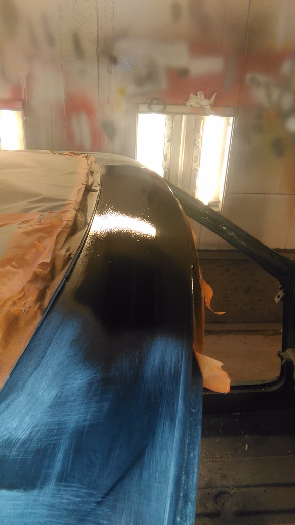

Managed to spray the front wings and the bare-metal areas on the shell before I had to leave today.

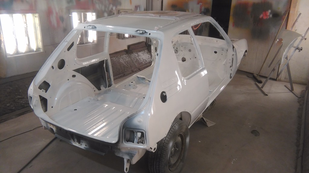

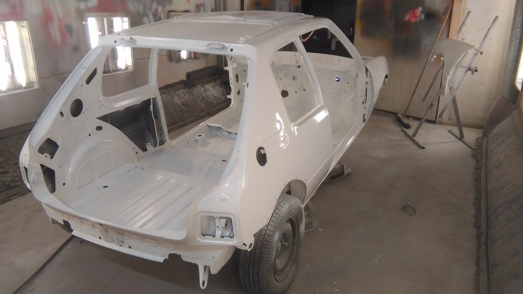

Sprayed the rest of the inside, and was going to spray all remaining on the outside too, however did run short on hardener, so have to get some more before I can finish it all off.
B1ack_Mi16
Now finished spraying primer / filler. Just need to matt it down a bit before spraying color.
