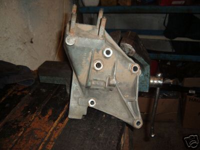

No, the engine mount for an 8V is on the head. Whilst the 16V mount attaches to the block, with five bolts. Three of the five bolt holes are on the 8V block, but are you game enough to hang it off only three?
In addition, the dipstick is in the wrong place, but that can be solved.

to fit a XU9j4 head i need to change the top engine mount as I saw in man Mi16pics conversion
I need a mount attaches like in the pics (five bolt holes)
and also the right top engine mount
