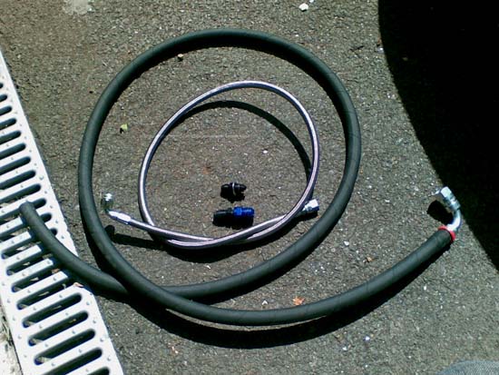

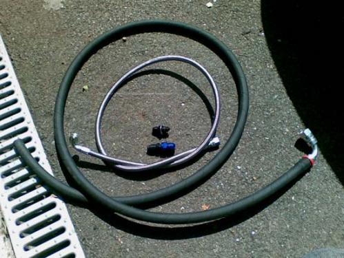

I finally got round to sorting out some new power steering hoses. Had them made by Think Auto in Isleworth Middlesex. Can't recommend them enough really, I had to take part of the steering rack down so they could match up the right threads but 20 minutes and £66 lighter I walked out with these:
Having the hoses has meant I could put the steering rack back on the sub-frame, install both drive-shafts, bolt the sub-frame back on, connect all the gear linkages and finally plumb the PAS hoses in.
