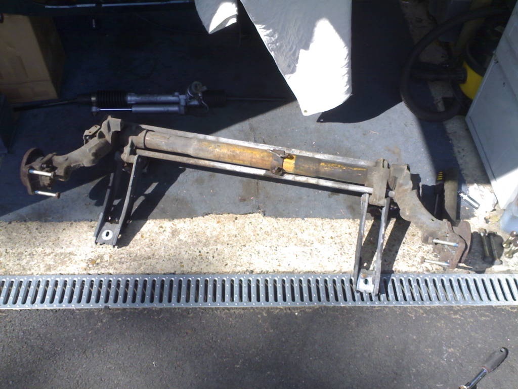

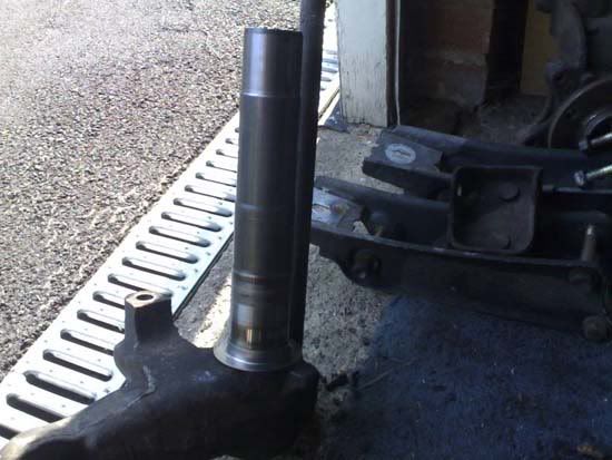

I thought as I was removing the rear beam and front suspension so I could undercoat and seal the under side of the car I may as well rebuild the beam with new parts and have the beam cleaned and powder coated. So once the beam was removed I set about breaking the beam down and inspecting for the dreaded corrosion and general solid rust that seems to happen so often with this suspension component.
Once I began to undo bolts it all seemed to come apart fairly easily which I took as a good sign. I started on the left hand side torsion bar removing the offset washer and the torsion bar came out freely after a few smacks of the sledge hammer. The arm seemed in good condition with no sign of rust and and grease still evident on the bearing. So onto the right side I wasn't so lucky. The screw just would not come out of the torsion bar and in the end it was damage limitation and I had to drill it out. The torsion bar is scrap but the arm again is in fine condition.
http://img.photobucket.com/albums/v331/ewP205/arm1.jpg
http://img.photobucket.com/albums/v331/ewP205/arm.jpg
Once the beam was apart I took it to the local sand blasters/ powder coaters and they made them good as new! I wanted the beam bright lairy yellow and I definitely got the desired effect! I also had the rear brake disc protectors and heat shields done at the same time.

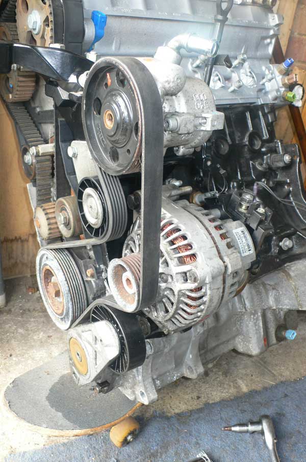

Time for a quick update. While I had a couple of spare hours today I thought about cracking on with the alternator auxiliary belt tensioner. With the air conditioner compressor removed and sold the normal belt would've been too long so I bought a shorter belt from a local factors which was still long enough to go round the various rollers, alternator and power steering pump which I'm going to retain on this car. The problem I came up against was the belt was still too long but with the top bolt of the alternator unbolted and tilted down on the bottom fixing the belt tightened up. So the plan was to use a standard 8v tensioner (like others have) and make the bugger fit.
http://img.photobucket.com/albums/v331/ewP205/7.jpg

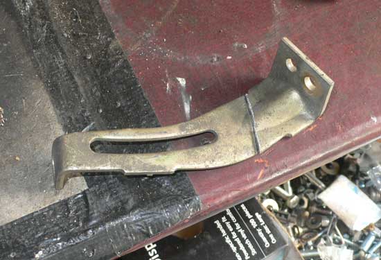

So i was kindly donated a 8v tensioner (cheers Ian) and went about cutting it and drilling so I could still use the tensioner in the way it does on the 8v motor by tightening up the front nut. Once it was drilled I could temporarily fix the 'arm' onto the block where the alternator normally bolts in and see how well it would work. I was well pleased to see the 'arm' lined up with the alternator bolt hole so it would just mean drilling out the bolt part of the tensioner so I could use a much longer bolt with a spacer.
http://img.photobucket.com/albums/v331/ewP205/3.jpg
http://img.photobucket.com/albums/v331/ewP205/4.jpg
http://img.photobucket.com/albums/v331/ewP205/5.jpg
http://img.photobucket.com/albums/v331/ewP205/6.jpg
http://img.photobucket.com/albums/v331/ewP205/8.jpg
http://img.photobucket.com/albums/v331/ewP205/10.jpg
http://img.photobucket.com/albums/v331/ewP205/11.jpg
So with all the bits made and all the bolts gathered I trail fitted to how well it all worked. And to my surprise it worked really well. The belt tensioned up just right, not too loose, not too tight and i bolted it all through and turned the engine by hand to see everything working as it should. With it all built I broke the parts down and gave them a quick blast of black paint.

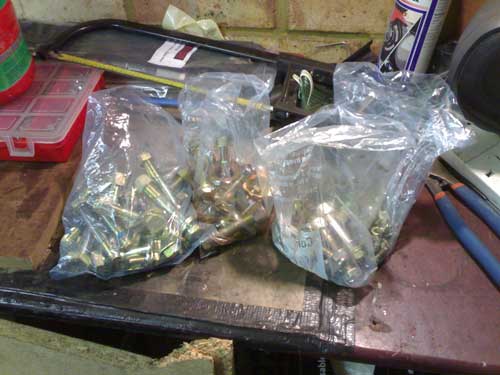

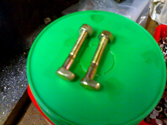

Quick update, after a long chat with my powder coater about the cost of new pug bolts he pushed me in the direction of a local zinc platers. I took several large bags of Peugeot bolts down to him and within a week i had them all back and they all look like new :) all for the sum of £30. I'm going to take my torsion bars down there too and have him clean them up too :wacko:
http://img.photobucket.com/albums/v331/ewP205/bolts2.jpg
