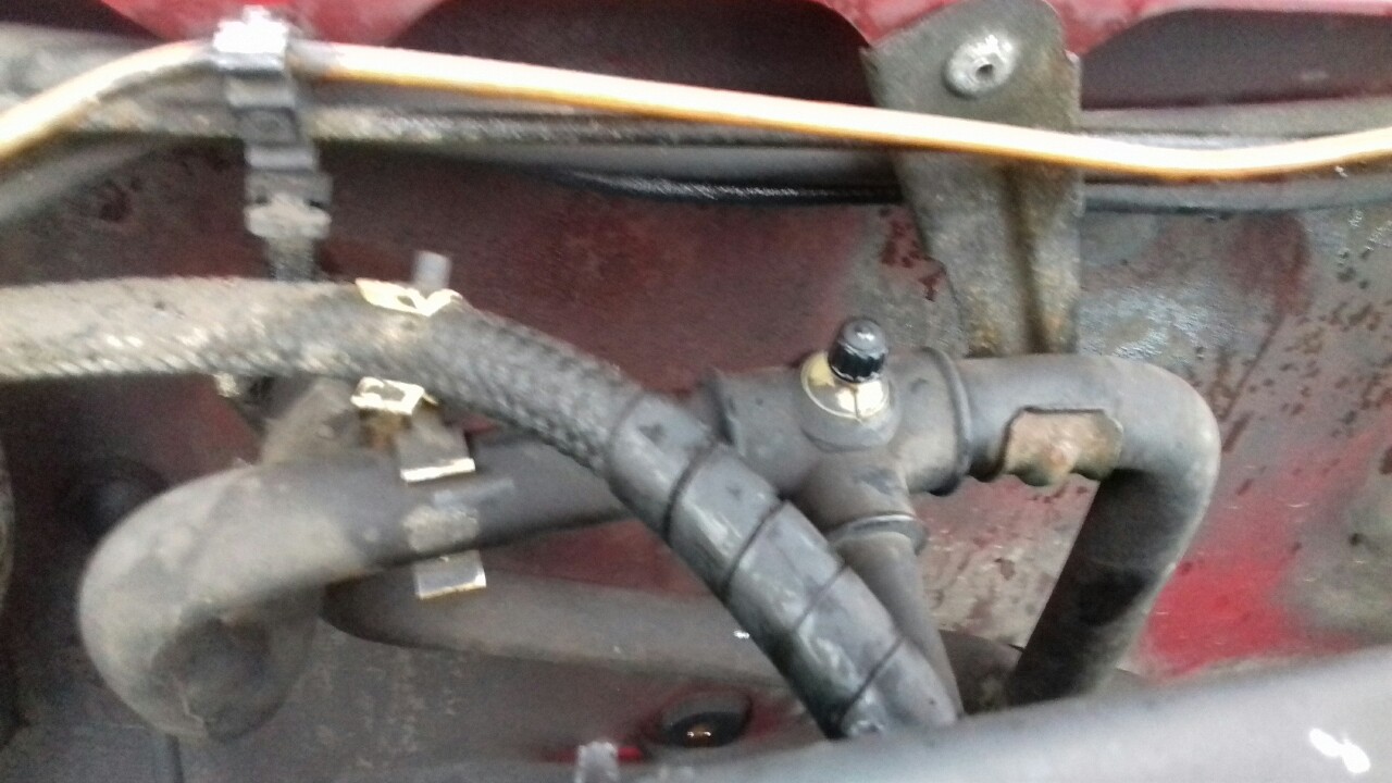

Here's a picture of the pipes to and from the heater. Having bled it all seem to get warm apart from the one on the left of the picture that heads into the bleed nipple. Can anybody enlighten me as to what is going on please?
Telf
If I leave the heater on full heat but without the fan operating after about 1/2 hour you get the faintest whiff of warm air. I'm leaning towards the heater matrix is blocked ?!? But never had this issue before

Can only be an air lock or a blocked matrix-same as central heating in the house, probably radiated heat building up in matrix rather than hot water flowing through it
Telf
It must be blocked because coolant is flowing freely at the bleed point. Damn!
Easy to change and not expensive. Just fit a new one.

A bit late to the party, but you know the inlet and outlet to the matrix are on the engine side of the thermostat? Taking the stat our will make the engine run cooler and the heater less effective as water will constantly be flowing through the radiator.
You can test for blockages by taking off the hoses from the thermostat housing and the back of the block and running pouring water though one from a hose or watering can etc.

Cheers Ad. No I didn't know that! Well even with the radiator fans blowing so coolant up to a decent temp there's no warmth in the car. I guess the matrix must be blocked as there is hot coolant at the bleed and no amount of squeezing the pipes makes any difference.

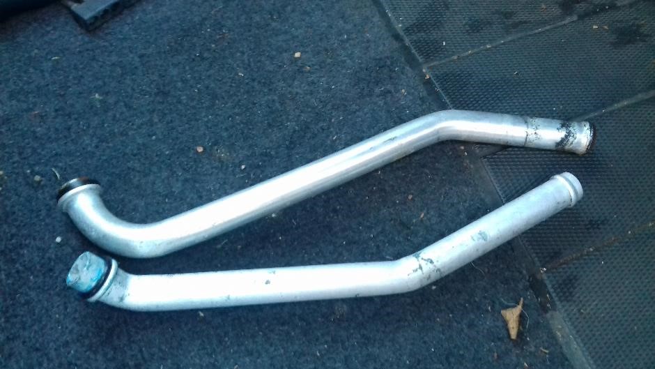

Today I got round to changing the heater. One of the screws was rotten to the extent that no tool was ever going to get it undone so I cut through the pipes and removed them.
Now I have a issue- it turns out the pipes supplied in the kit are too short and actually bend the wrong way when in position.
Does anybody have a set of the matrix pipes please?
Telf
Top pipe is the original and bottom is the replacement

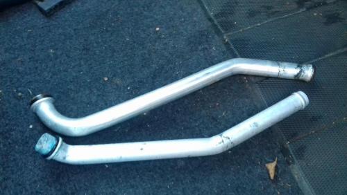

Telf
Replacement pipe supplied by Jackherer- cheers buddy. I now have heat!
jackherer
It was lucky the one you needed was the one usable part I had in my scrap bin, you saw the state of the other one or what was left of it!
