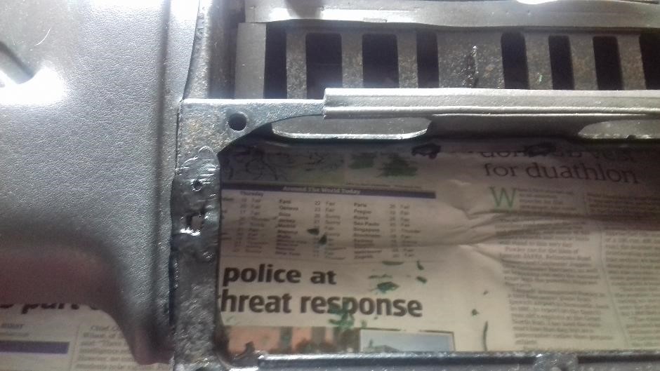

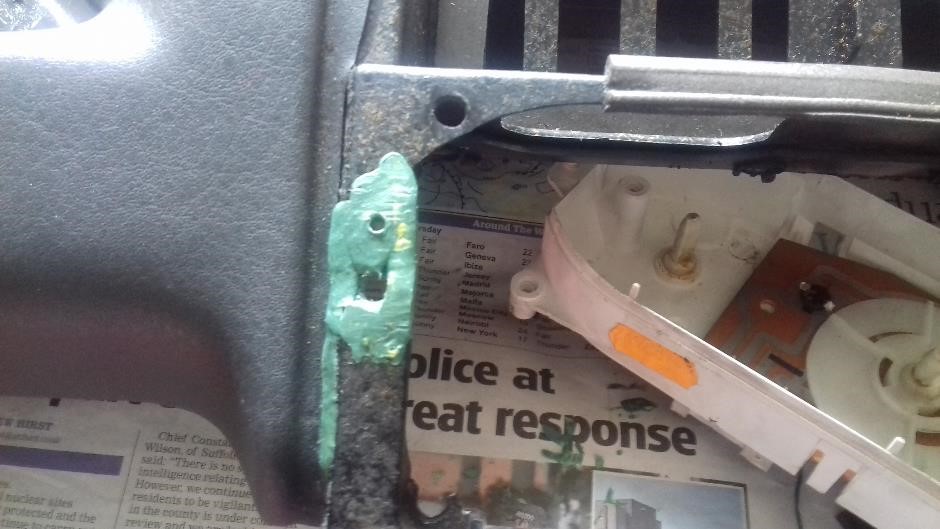

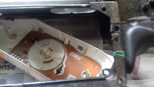

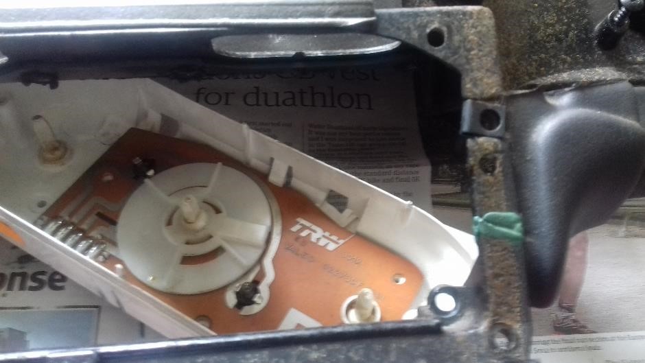

In the spirit of still trying to save as much of the car as possible I had a go at repairing my dash today. I think its fairly common for the shroud around the heater controls to snap at the bottom. Heres my repair using some Modelling putty:
it seems to be strong enough - I accidently picked the dash up by the reattached portion last night and it didn't fall off!

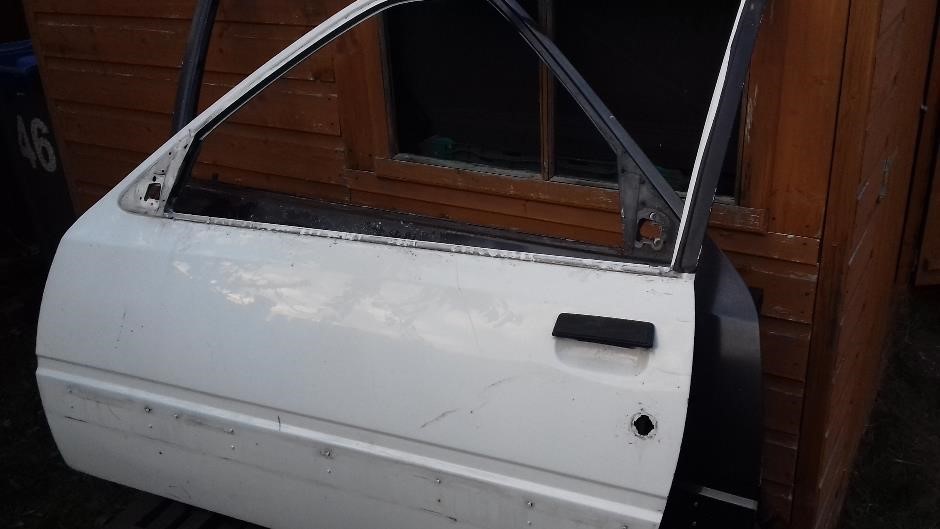

A little progress this evening 2 doors stripped and ready to go to the sprayers for inspection. They want to replace both my doors as they are rippled!
