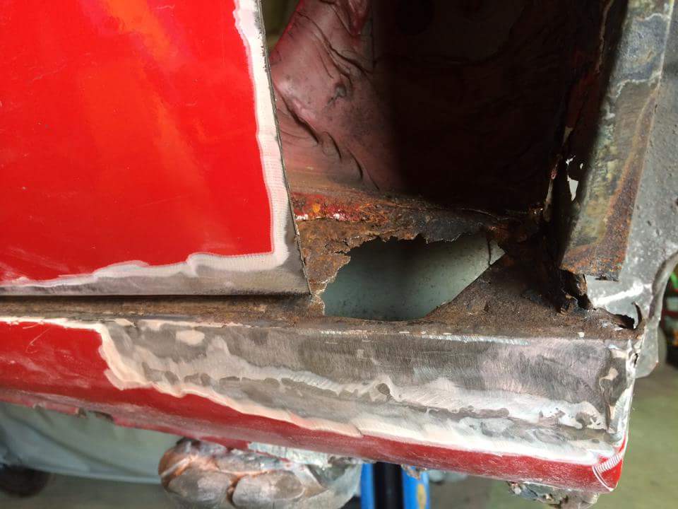

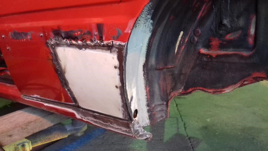

As the nearside rear arch was a known area of concern that has been tackled first.. pictures speak for themselves.

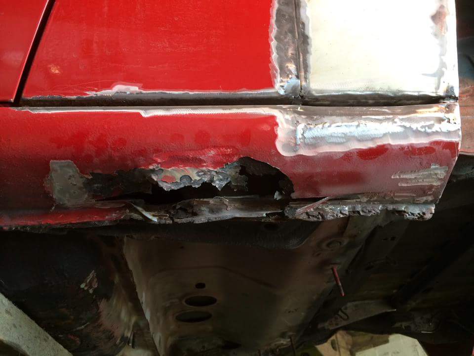

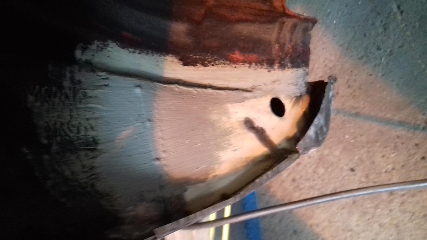

basically the previous repair that I paid a lot for about 18 months ago was a complete bodge. As you can see the Sill is in a sorry state... it gets worse

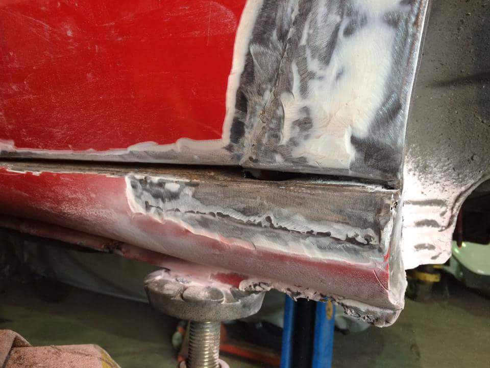

the bottom of the sill has actually been filed with fibre glass and mastic- not metal as it was supposed to be

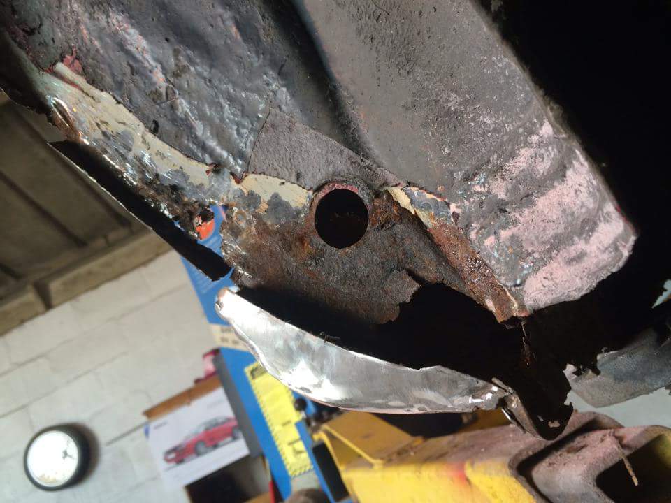

rotten area cut away. rear arch tacked ready for weld

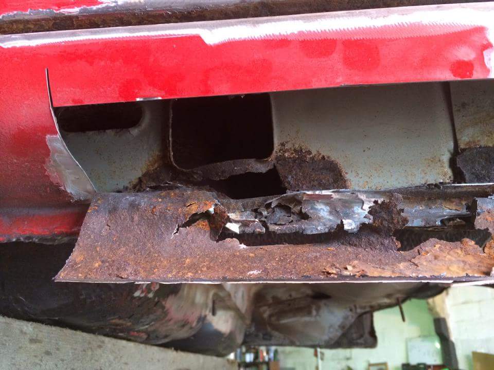

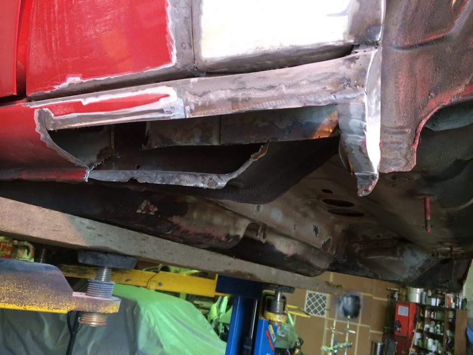

slightly out of order as the extent of the sill damage was found after the 1/2 panel patch was tacked on. At the moment trying to decide if to replace or repair the sill...Weekend to think it over!

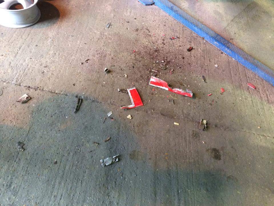

And the dead metal left scattered on the floor!
