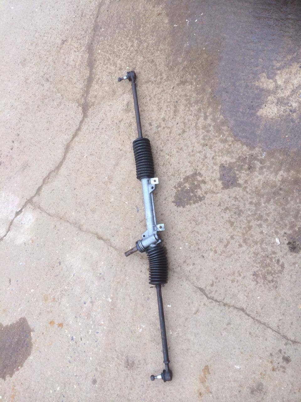

Here she is at the moment, planned for the next week is the removal of the remaining running gear which will be taken off to be cleaned, shot blasted and repainted.
