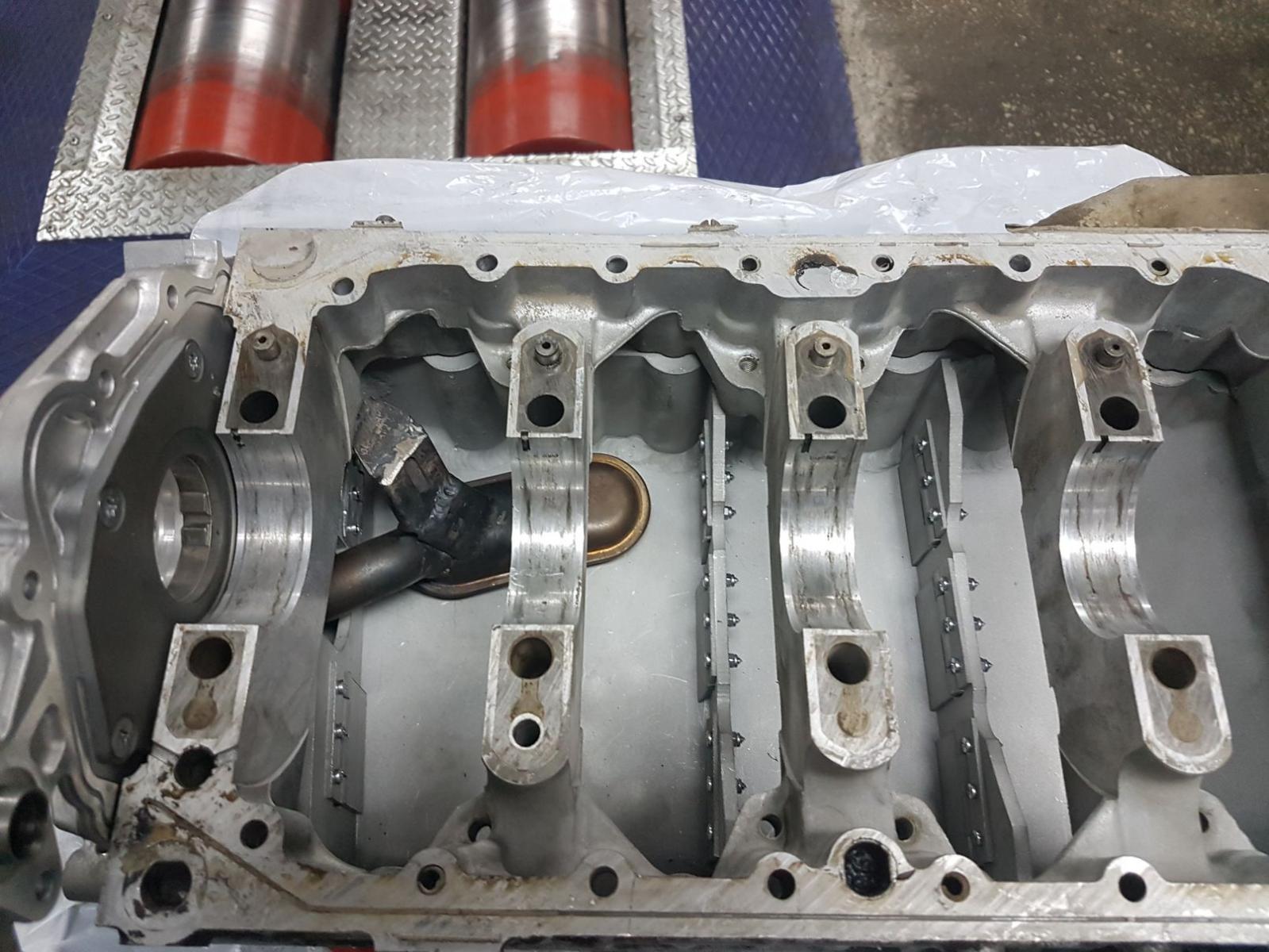

Actually it doesn't have a check valve. The separator is just baffled. There is a chance that some of the oil comes up the hose when cornering, as the level drops (that is why a baffle is preferred when using the car on a track).
This is a baffle that I made:
http://drive.google.com/uc?export=view&id=0B5WxbgjTAvq3dzFlb1BETnpoRzg
http://drive.google.com/uc?export=view&id=0B5WxbgjTAvq3bFhlN3RKbzR6UEU
http://drive.google.com/uc?export=view&id=0B5WxbgjTAvq3OXZtNFdFQXZzTFU
I have also moved the drain back up as much as I could on the sump. When you do this the hole gets exposed out of oil, which means that if there is pressure in the crankcase it will force the oil back up the hose (this is similar to what happens to original position and cornering without baffled sump). If you do not want this you need to make a proper breathing system.
sam jfm
That baffled sump looks the business, I will have to get making I think! What have you used to construct it?
drmo
It is made out of stainless steel sheet. Model was made out of cardboard. It gets the work done, but next one I'll make a proper trap doors out of metal.

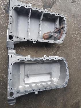

You can also buy one from Peugeot Sport. They use rubber baffles too.
Not cheap though.
Schumi
This is the my shortened and baffled sump. Its for vertical upright mounting. I will use with OEM windage tray. Maybe I will add short lip for front of sump for braking G force.

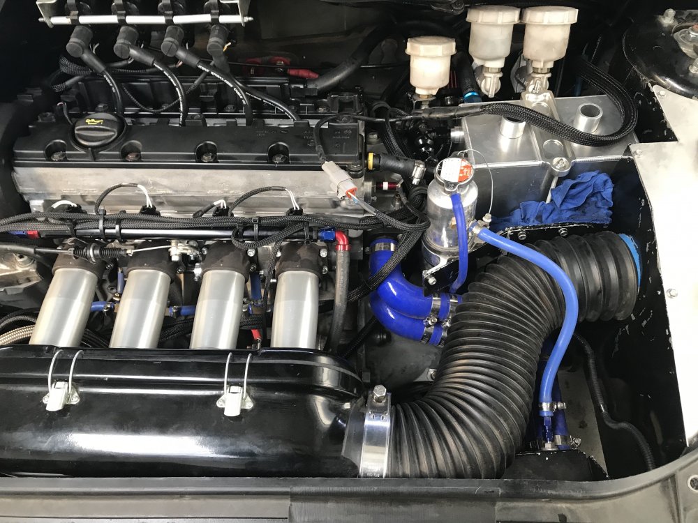

I have also had this problem after fitting throttle bodies to my j4s. It's still running vvt. When held at high rpm the catch tank filled and pumped several litres of oil out. At the time I only had the breather from the end of the inlet cam to a tee down to the sump and up to the catch tank, I then opened the blanked hole on the top of the exhaust cam cover and sent that to the catch tank as well which improved it slightly but not much. The next thing I tried was to drill holes in my new inlet manifold to open up the original holes between the ports, I sent these down to a separate tank I made which I mounted under the inlet with the a pipe in the bottom going back to the sump, also I put a pipe from the top of it up to my breather catch tank.
This seemed to fix the problem until I got back to service after a stage and found the catch tank full again. The problem is definitely a lot better as if I had done that before I wouldn't have even made it to the end of the stage before it pumped all the oil out the engine, what I plan to do next is increase the diameter of all the breather pipes and add a drain from the bottom of the catch tank back to the sump but unfortunately I'm not going to know if it's worked until the next time I rally it because it isn't doing it until it's worked very hard which I can't re-create on the road.
