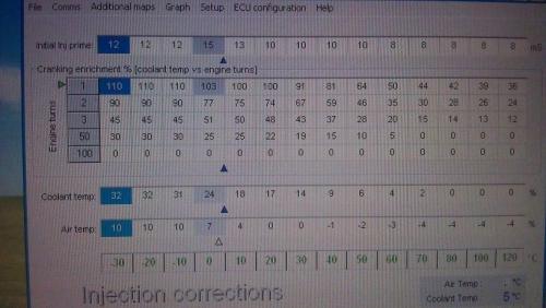

I'm having trouble starting my car in this cold weather. I don't use it much and last started it about 4 weeks ago, at that time it started as it normally does, ok with some light feathering of the throttle for 10secs or so then it'll idle just fine. I've never messed with the cold start as its never been an issue tbh........ until today when it just wouldn't catch.
I have no idea which way to adjust the settings, I know its the injection corrections that need adjusting. Would anybody running an Emerald I presume on 16v ideally ? that starts pretty easy at these temps (0 ish to 5 ish degrees) be able to take a screenshot of there injection corrections to give me an idea of which direction to go.

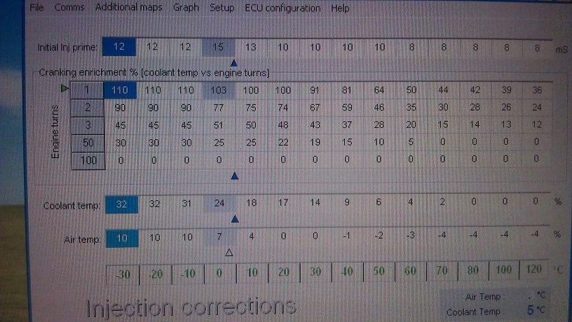

If its any help to the knowledgeable I've attached a screenshot of my Injection corrections page.

I got it started today after changing the fuel in the tank. Other than starting it about 4 weeks ago to pull it out of the garage for a wash it hadn't been used since last July. I don't know why I thought it maybe the fuel but glad I did or I would have been scratching my head till the end of time.
I'd still like to fine tune the cold start, so is there anybody able to point me in the right direction ? Which part of which row to adjust ? initial ignition prime and/or cranking enrichment % ? and do I just adjust 1 site or a block ? I've read you generally only get one chance per day to try it, so at what % increments should I increase the values because I'd imagine theoretically it could take a lifetime of cold starts to get it right.

I was in the same mind set as you regarding not fiddling with it (little knowledge is dangerous) and tbh after having a quick gander at the link you posted I probably still won't. I will have a proper read of the distructions when I have abit more time to concentrate on what its saying. I would phone them but as like in your case I'll have forgot by the time I put the phone down. LOL
It didn't bother me prior to this issue and now I've found it wasn't related to cold start I may end up just leaving well alone......we'll see.
Once upto temp mines solid at just under 1k and just over when cold.
I'd also be interested to see your cold start map too Jon if you get chance.
