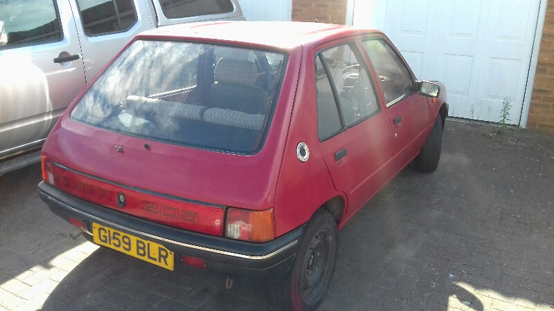

Ive had a fairly torrid time trying to finish my spray job off!
Everytime I use the cutting compound I get this white bloom appear. Someone today sid it may be water ingress as it sits outside overnight so Ive cut it back again. Now its sat with a tarp over it to stop the condensation hopefully maybe....
ARGHHHH!!!
toolie72
Hmmm, tried cutting part of a panel then slapping wax/polish on it, to see if paints needing something to protect it from the atmosphere?
Might be worth doing a few wee patches with whatever polishes etc you've got lying about
Almost like your paint is soft (not sure how to describe what I mean-sorry)-like it hasn't gone off properly underneath

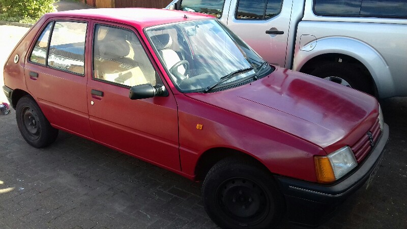

We have manged to get rid of most of the white marks but not all. As the weather is on the turn we have waxed the car 4 times with some G4 professional wax. It looks OK. Also added a reflective panel to tidy the back up.
it looks better in the photos!
The reflective panel was off fleabay. I think an aftermarket reproduction. It didn't fit very well - seemed to be too curved and so in order to make it look ok I added a line of sealant at the top! Not strictly as Peugeot fitted them I'm sure!
steve@cornwall
Looks nice and tidy, I think I would have had to paint the vallences too.(tartism) You've certainly given it a new lease of life.
Well done for having a go. I think if I'm honest your choice of oil based paint has made things hard for you. I think the bloom problems are probably because it still hasn't fully "gone off" hence you remove the top layer flatting which leaves an uncured layer open to the elements eg water which allows it to bloom.

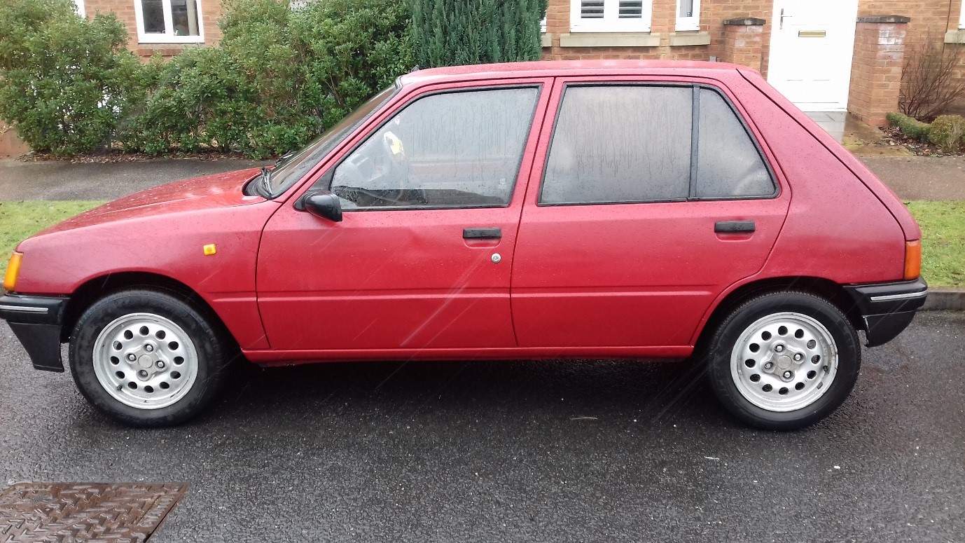

A small development. Acquired a set of 1.6 alloys with reasonable tyres today for £75. They need a lick of paint but should help reduce the chance of a off road experience this winter and make the car looks a bit better!
As far as the painting of the car goes we learnt a lot. However the main thing I learnt was leave it to someone with more experience and better equipment. Come spring the cars going to be sprayed by someone other than me!

Fitted a set of 1.6 Alloys with new bolts and a original set of peugeot locking wheel nuts I saw on Ebay. All in £110 and still a few months wear left on the tyres.
allye
Best wheels for a base model! Looks good.
steve@cornwall
You know what? I think that has a lot of character just as it is.I like it!
