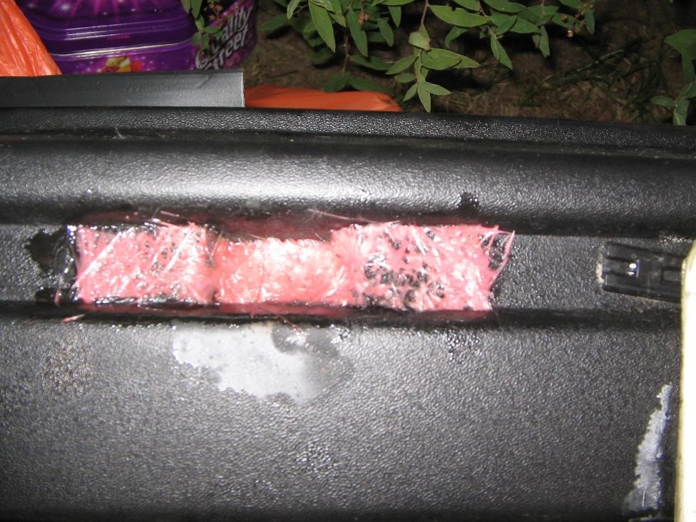

I had a go at a GRP repair today for the bumper - it seems solid enough - However I've never smelt anything like it in my life- had to revert to a full Respirator facemask!!
Truly horrible- Halfords advice use a dust mask - lol the fumes coming off it where something else!

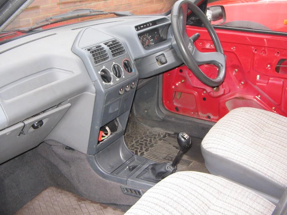

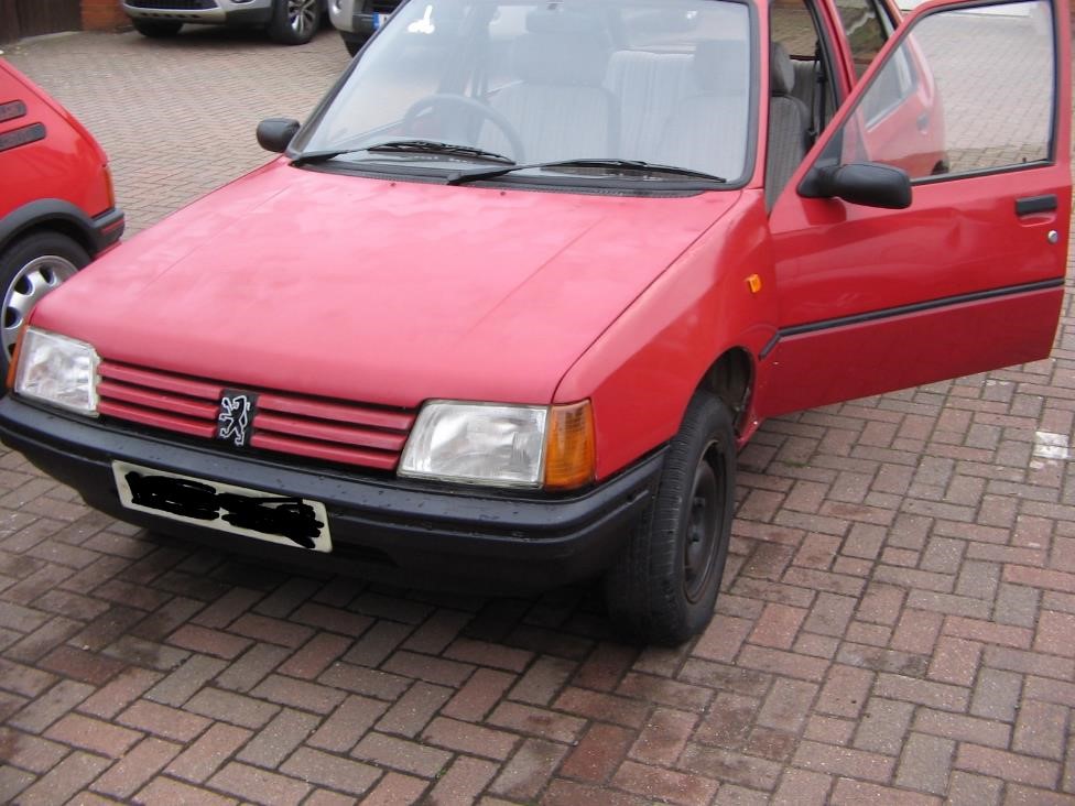

Spent today refitting the bumper and headlights and refitting the rest of the interior- not too bad for a minimum spend project- MOT in a few weeks once I fix a drive shaft boot.

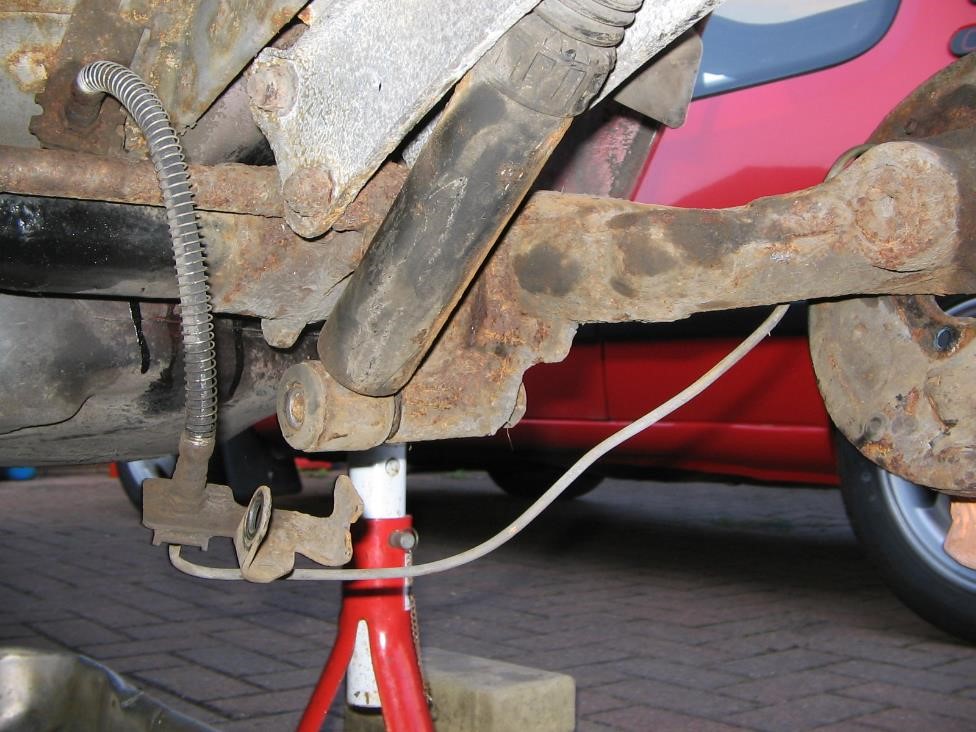

having taken the wheels off and put it on axel stands the nearside moves freely and the off side is in a fully up position(well not quite hitting the bump stop!)
I'm going to try and wedge some wood into the arch and use a scissor jack to see if it moves. Looks terminal to me though. There is a 309 being scrapped that i'm taking parts off but I believe the rear beams are wider?

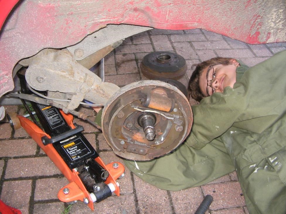

New Beam sourced from the GTX that SkyQuake is breaking.
Started this job thinking it was going to be a nightmare but other than taking most of Saturday it wasn't too bad.
I was relieved when I realised you can disconnect the brake hubs without having to break into the system - I didn't fancy bleeding the break lines/snapping the bleed nipples!
For anyone who hasn't done this job you can see the flexible lines do give enough clearance to manoeuvre the brake hubs clear

And as its really my sons project here are a few shots of him actually doing the work!

In other news a set of front and rear GTI bumpers/valances are waiting to be fitted to replace the tatty tired ones currently on.
