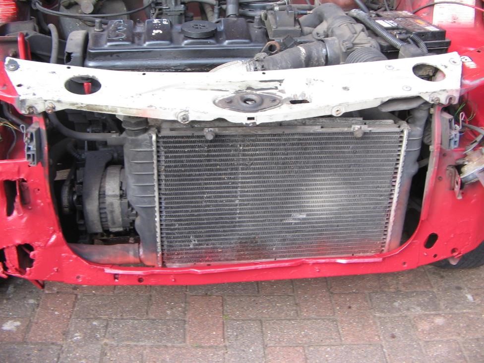

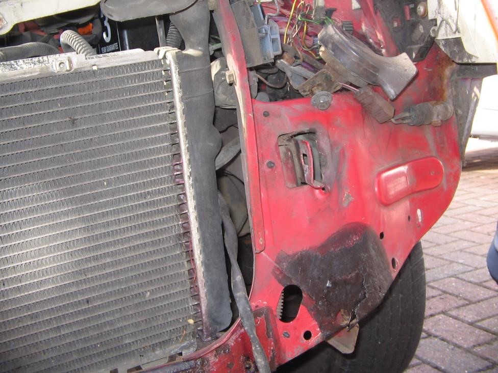

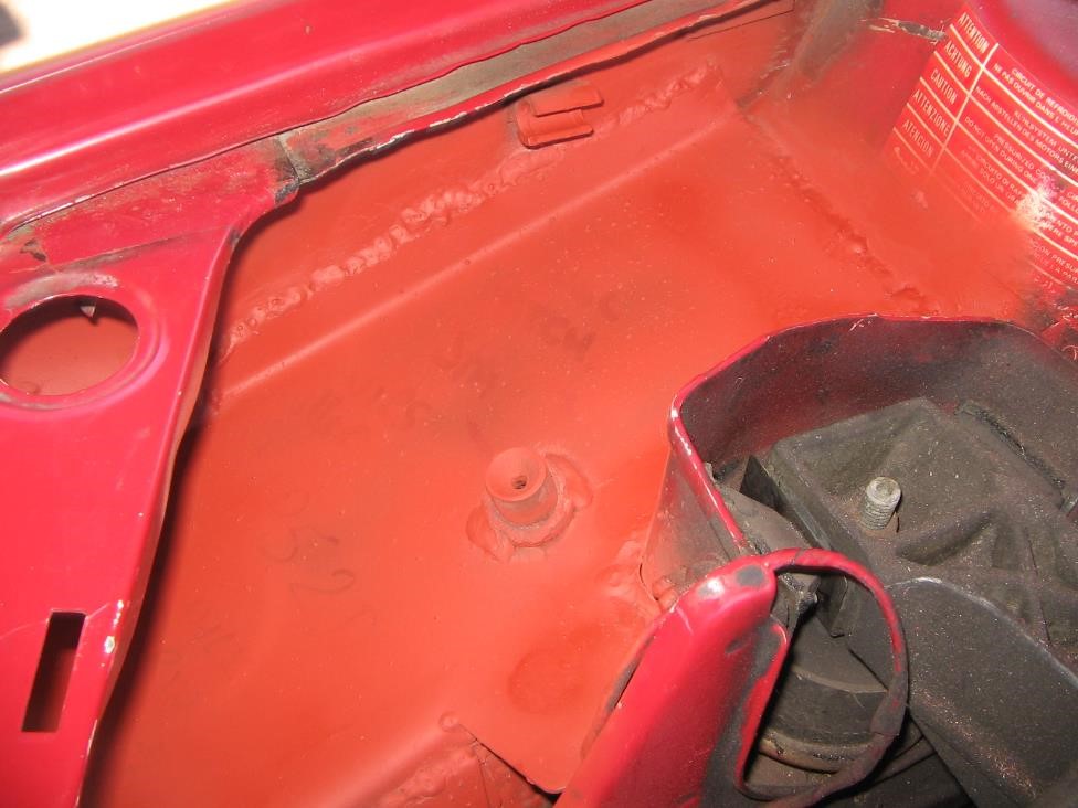

small update - I thought I'd tackle the rust on the splash panel today
heres what it looked like- not too bad
Telf
After a few hours with a dremel, wire brush and some primer
That's my first attempt at any kind of de rusting - guess I will have to see how it goes- the larger holes are going to be welded next week

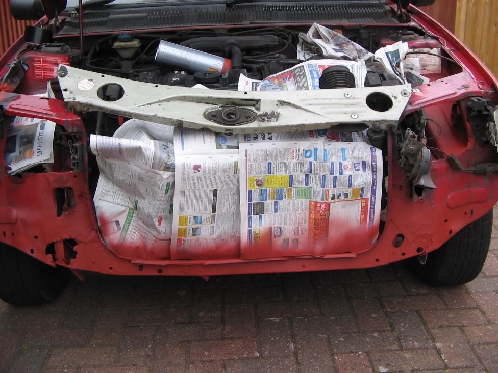

Telf
Well having seen the weather forecast I thought I'd better spray it before a day of rain- turned out ok

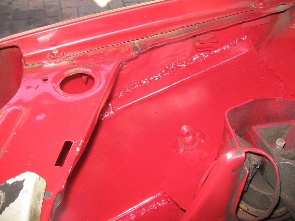

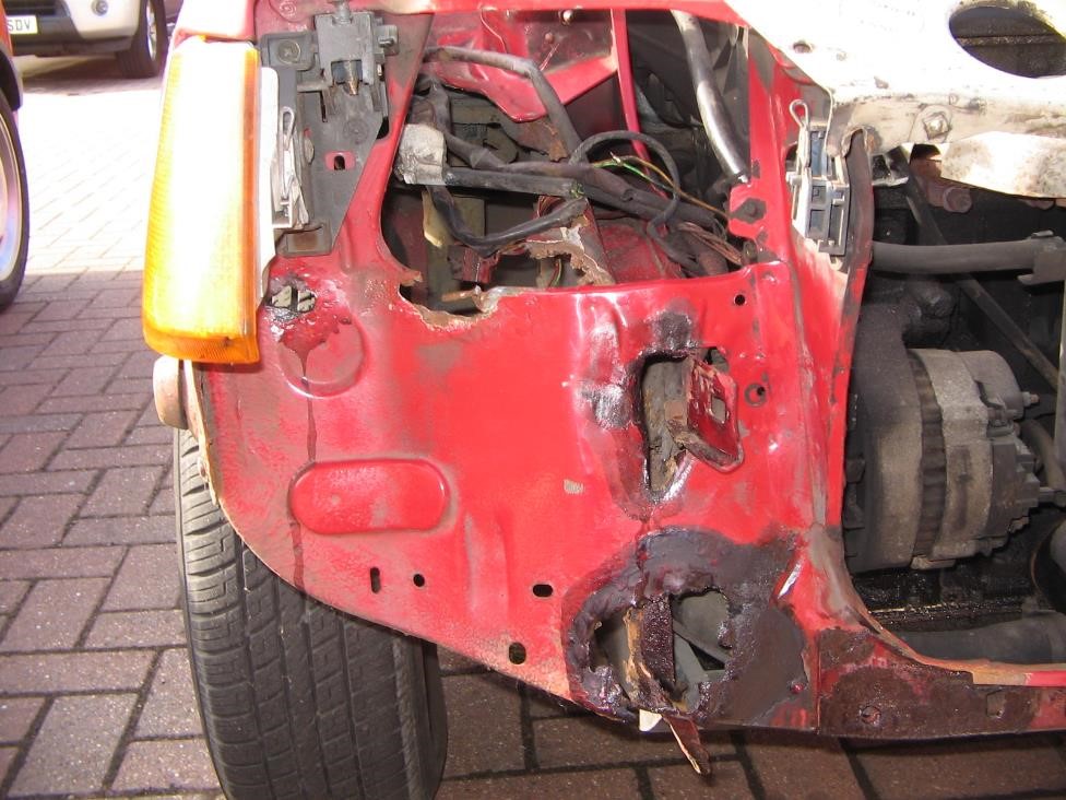

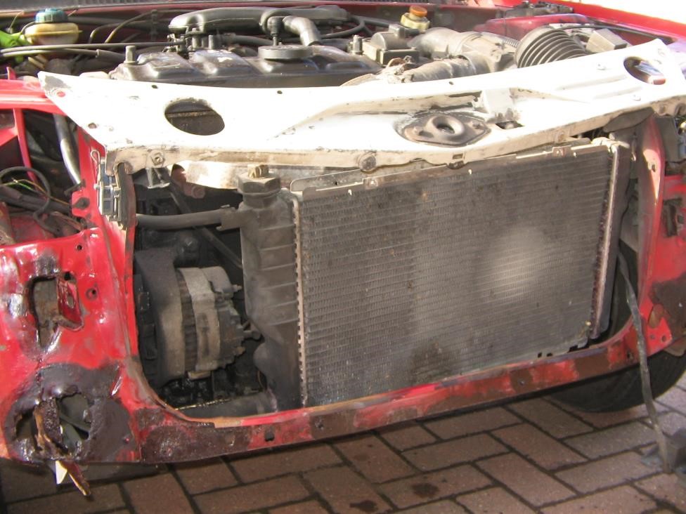

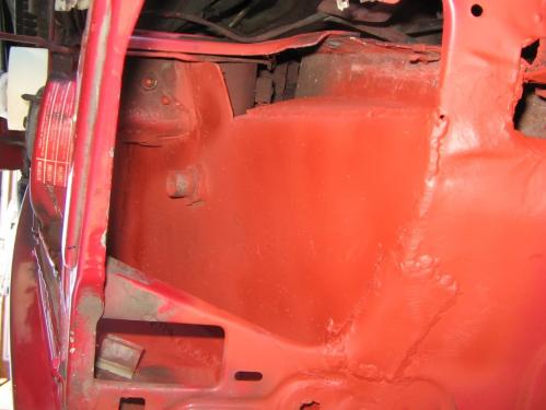

Well I will get round to the tank in the next few weeks - heres an update of the weekends work.
First off the Inner wing welding!
So I decided not to try welding it myself - as a result I found a mobile welder who came to the house and did it- I think the results are pretty good. I also got offered a welder that he was selling so I am buying that for future use!
Its a complete new plate sitting in/on the remains of the old
Edited by Telf
Telf

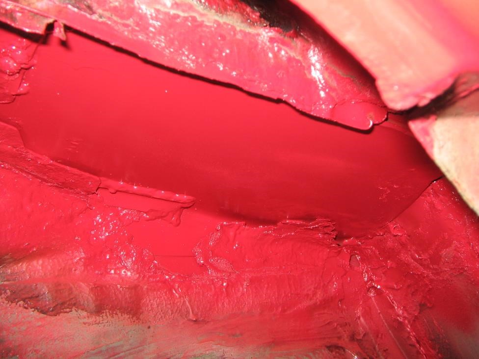

Heres the view underneath - I had to paint it quick as rain was forecast- good job I did because its pouring down here!!
Once it stops I will Seal it all up with some panel seal - and generally make it look better!
Edited by Telf

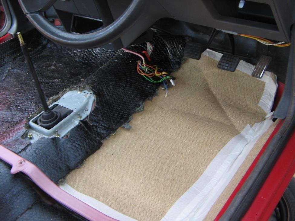

Next up was putting the interior back in - it was all taken out so I could make sure the floor wasn't rotten.
As the drivers side sound proofing fell to bits when it came out I decided to be a bit DIY and made a replacement out of 3 layers of old carpet- dunno if it will work but I'm from Yorkshire so have to save money if at all possible :D

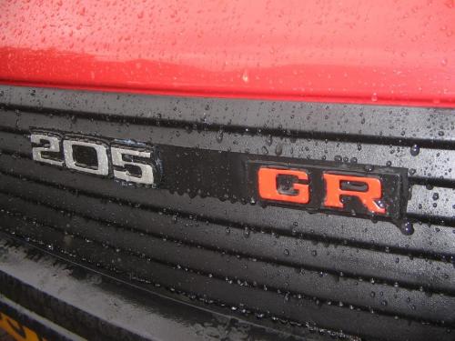

The rear panel badges have also been refurbished with some paint and lacquer- they have come up quite well

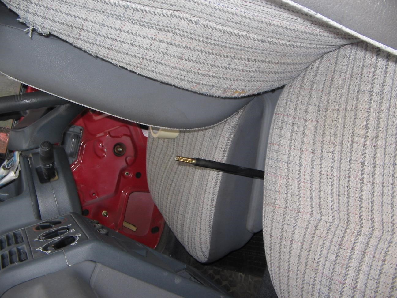

Now a general request!
We (myself and my kid) think the car should be kept as original as possible( GR badge not withstanding- although I kind of like it in Red!)
If anybody still has the seats shown in storage or something and they would like to sell them please let me know- im also looking for the front door cards!
Telf
Here is a close up of the pattern
