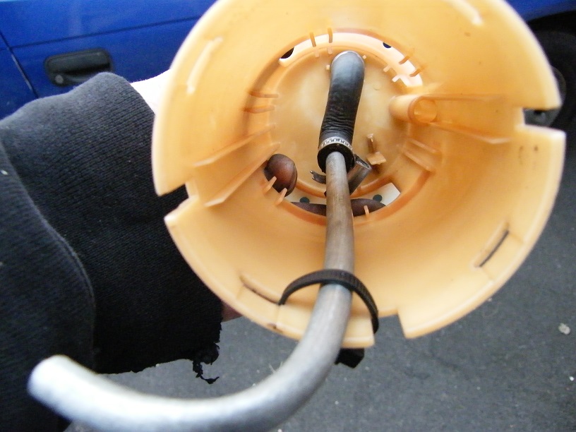

johniban
not sure what all this using a diesel tank is about , mine is the standard gti tank and gti fuel filter housing, i just removed the pump and fitted torques fuel fittings

guess you have a short length of hose dangling down into the filter bit?

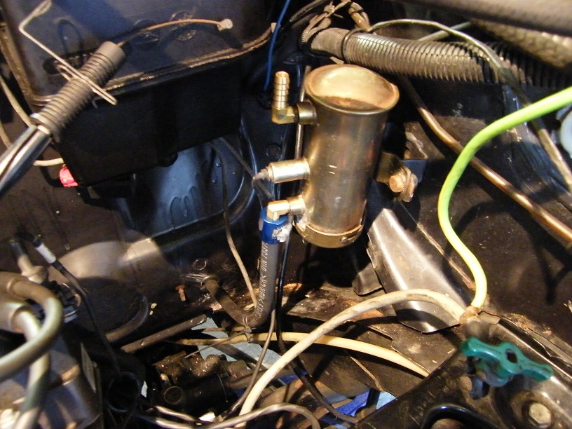

pip470
The above photo looks great but here is what i did. Not pretty but worked, puel pump was in engine bay and sucked all that way fine.
johniban
Yeah, just about 3-4 inches of copper pipe, put kept the original gauze so it doesnt suck the crap up

Pip.. nicely done, can i ask, did the fuel pump run ok mounted in the engine bay? i thought they had to be within 18 inches of the tank
pip470
Yeah the pump was fine there, It was a concern at first but it worked and never had any problems.
