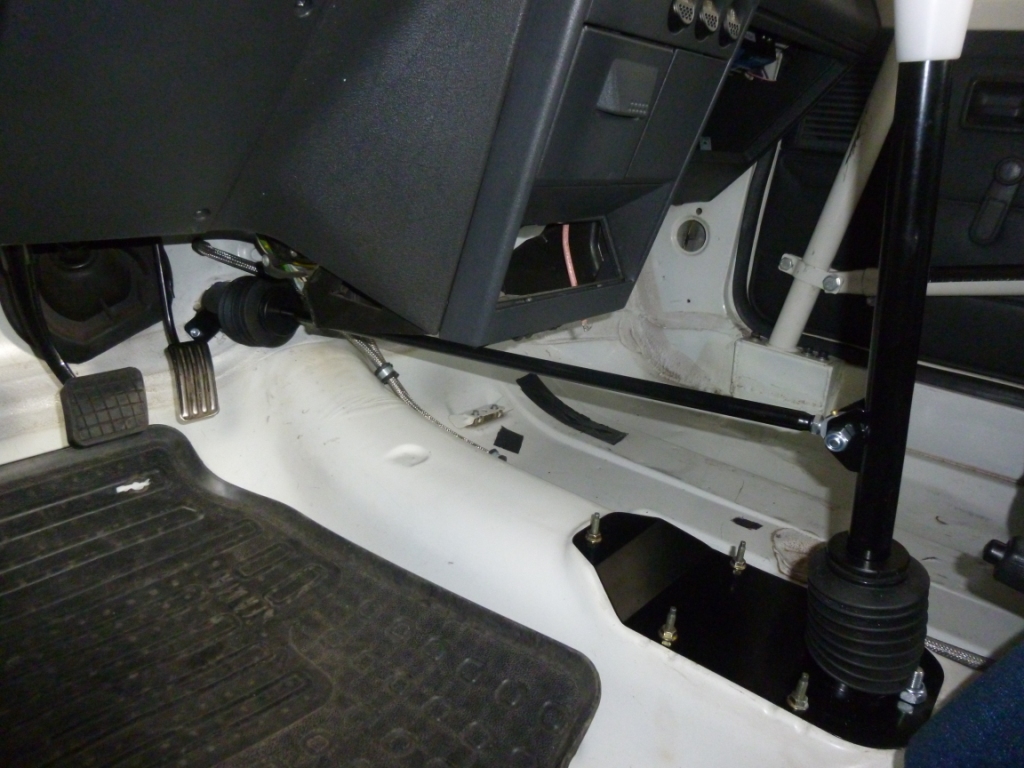

Hi Christopher, unfortunately my Rallye is stored 100km from my house, however if you can wait until later this week I should be able to get some photos. The hardest part was making the hole in the bulkhead for the upper rod to pass through and the next difficulty was adjusting the lengths of the rods, it took me days, however I think the kit has been modified since I bought mine. Search the following on the forum
Fitting The Satchshift Today :)
I posted up some photos on there.

205Rallee
Photo from inside the car.
