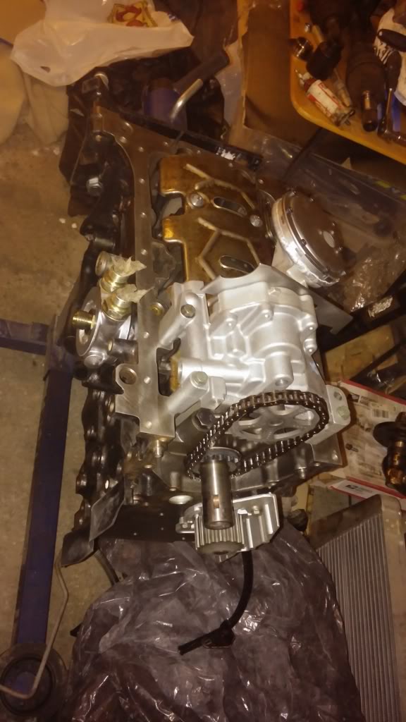

Started assembling the engine now
Got a oil pump spacer from petert

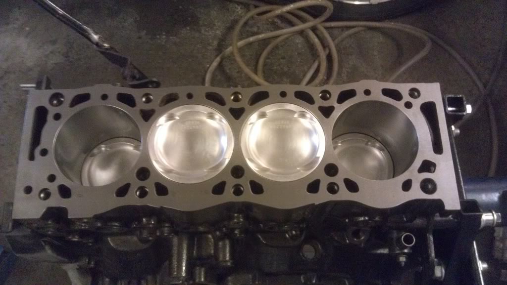

Pistons in

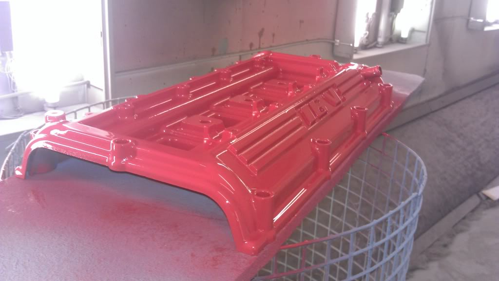

Painted the camcover
And engine compartment
Camcover after sanding down the ribs and one more layer of clear coat

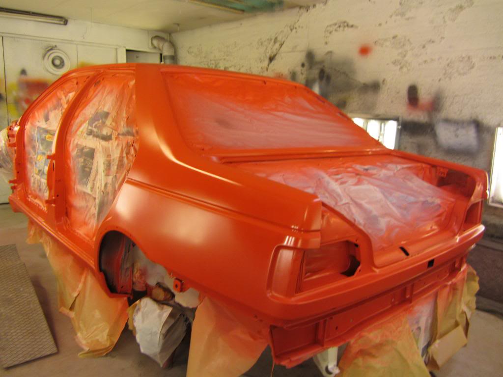

B1ack_Mi16

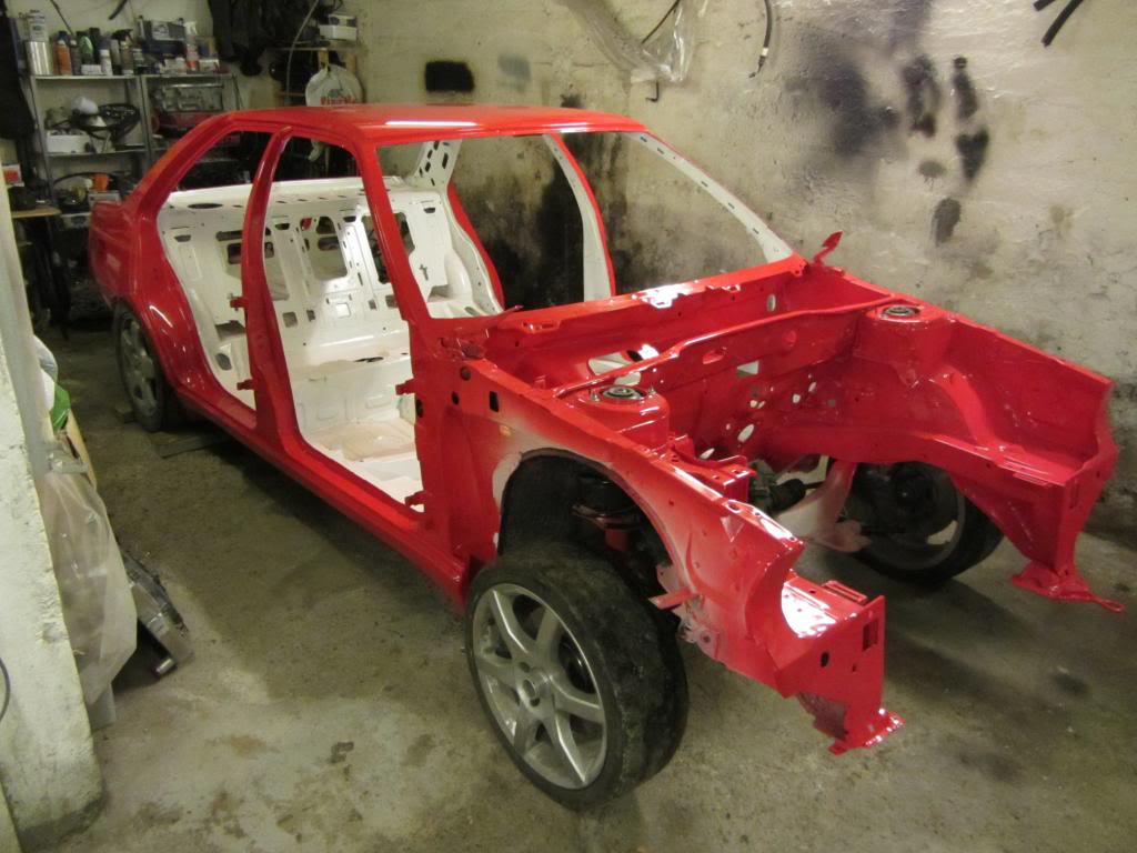

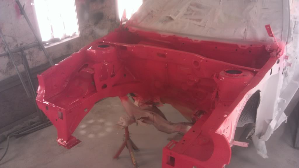

Sprayed base coat
Then clearcoat was shot and car taken out of spray booth. I'm pleased enough with the paint job considering I did everything myself.

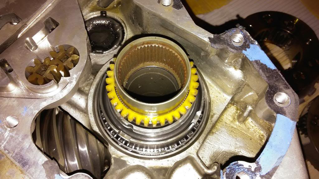

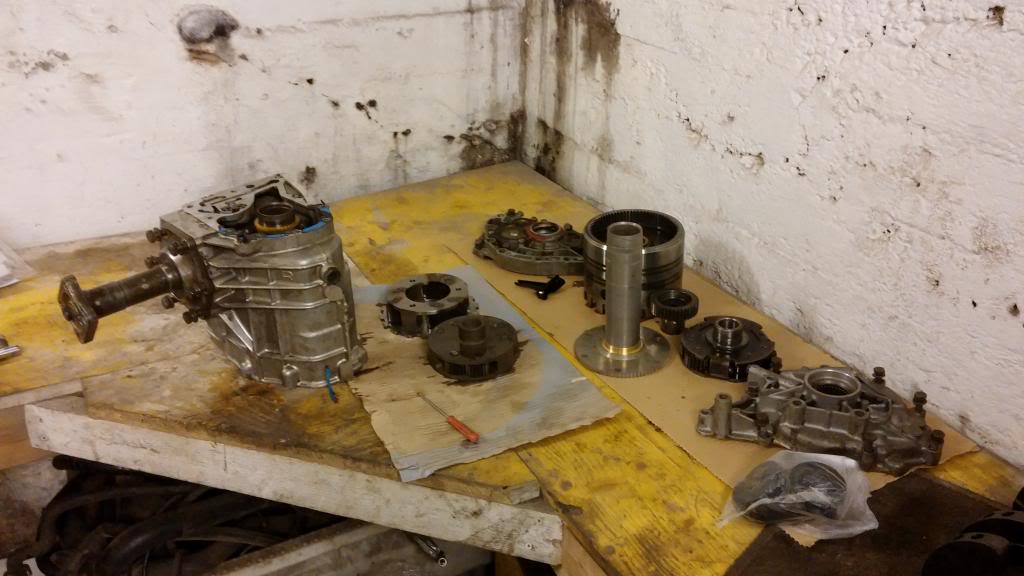

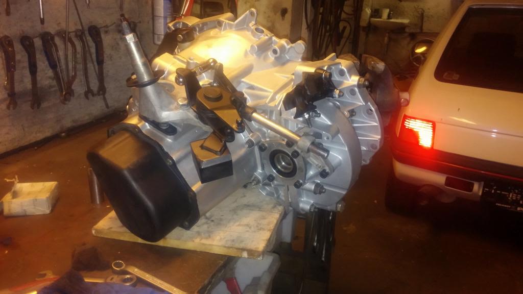

Now I've started on the drivetrain. Transferbox first thing to be attacked.
Going to install uprated differentials and input shaft from ATD Performane.
Also starting to look at the gearbox output shaft. I need to have some machining done to install 2 shear pins in addition to the 10 bolts.
This shaft is also new and improved from ATD Performance. It shall handle about engine torque of 800Nm in 2n'd gear upwards. 1st gear will probably not be a problem as I guess the boost pressure never gets the time to build up before one would need to change gear.
B1ack_Mi16

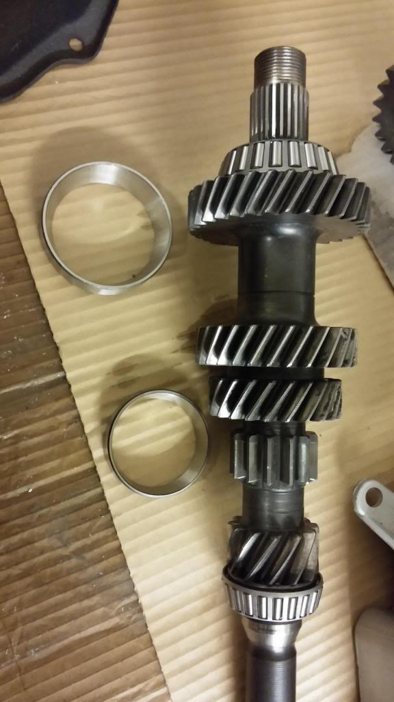

I finished up the transferbox, and started to find the gearbox parts I had lying around.
Installed new bearings on input shaft
More assembly
Now box is assembled and ready apart from the output shaft that needs machining first...
Also changed the input shaft seal

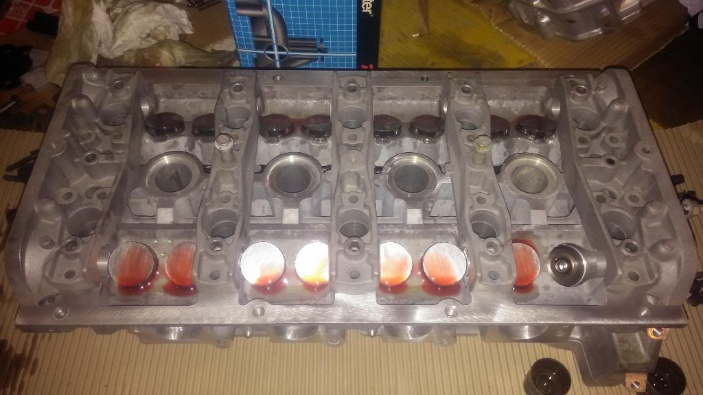

A little update. Long time since last now :)
Engine is now assembled:
CAM00143_zps2ee360c6.jpg​
CAM00262_zpsk3pztkxh.jpg​
CAM00356_zps683da9c6.jpg​

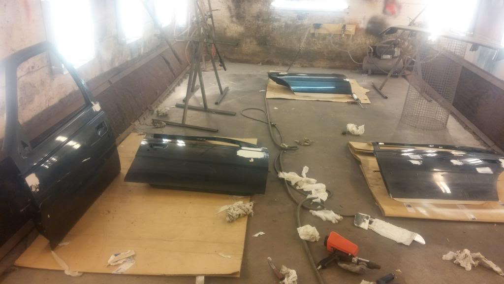

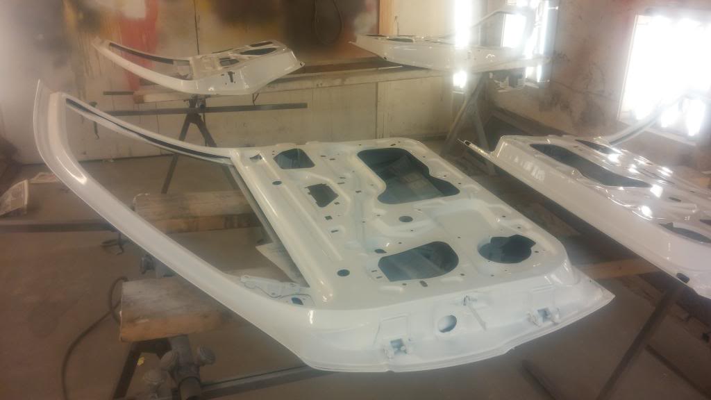

And I've started to do bodywork on the doors. Was actually quite a lot of job and I'm still not entirely finished, missing a layer of sanding primer still and the paint itself.
CAM00343_zps63f4d01a.jpg​
Inside done with primer
CAM00374_zps08d79206.jpg​

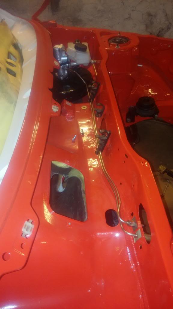

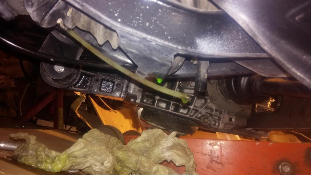

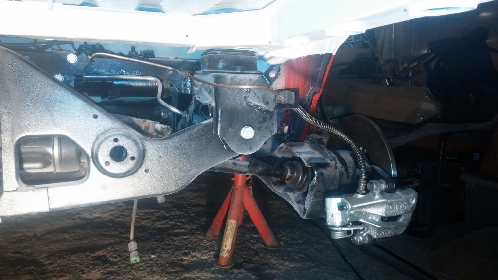

I've also put brake servo and master cylinder into place, and I'm at this point finished making up ned brake lines for the car. Took some time and effort that too.
CAM00228_zpse3c5a633.jpg​
First one made.. and notice all the sanding dust on my freshly black painted parts :(
CAM00227_zps78aa49c7.jpg​
Also added the hydraulic fluid return hoses while I was working under the rear subframe.
CAM00245_zps107fd1a8.jpg​
Rear brakelines in place
CAM00242_zpsf914a01c.jpg​
And also the fronts
CAM00290_zps697dc558.jpg​

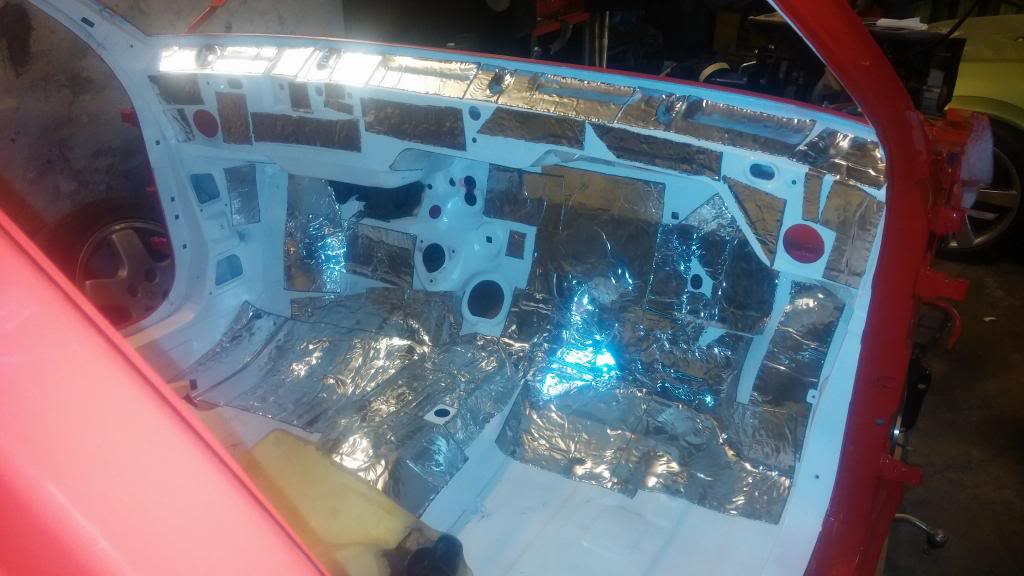

And some resonance mats for the cabin
CAM00331_zps4460c6a2.jpg​
Foam on top before orginal mat goes into place
CAM00335_zps3d667d35.jpg​

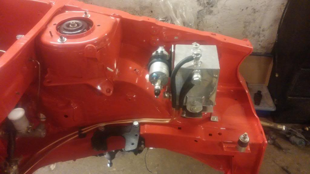

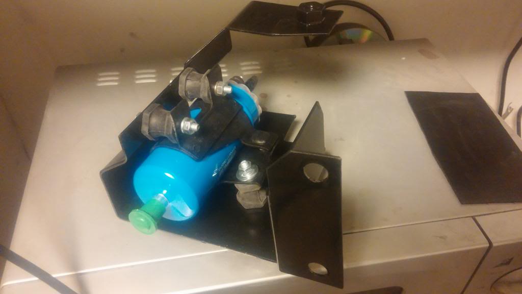

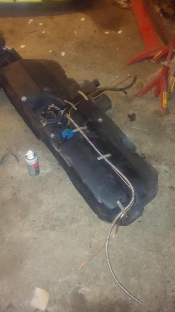

Also finishing the fuel lines and changing the broken fuel level sender in the tank
CAM00390_zpsc5305097.jpg​
Fuel tank with fuel lines
And new fuel pump in refurbed bracket (this is just the feed-pump)
CAM00360_zpsa0555227.jpg​

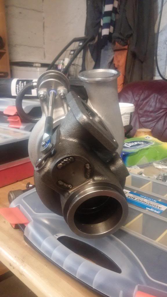

Also got hold of a Holset HY35W turbo which should be able to pump around 450bhp.
CAM00353_zps41f865eb.jpg​
CAM00355_zpsfd8aa7d6.jpg​

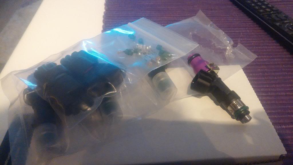

Also had some Injector Dynamic 1000cc injectors delivered, so that should make it possible to max out everything else and still run E85 without fuelling problems.
CAM00372_zpsmuzq46pj.jpg​

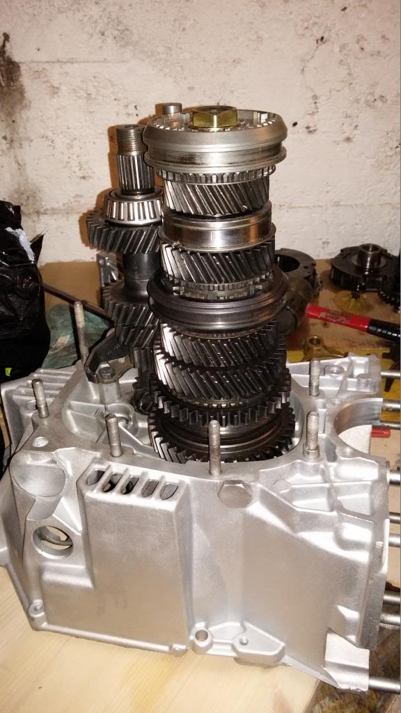

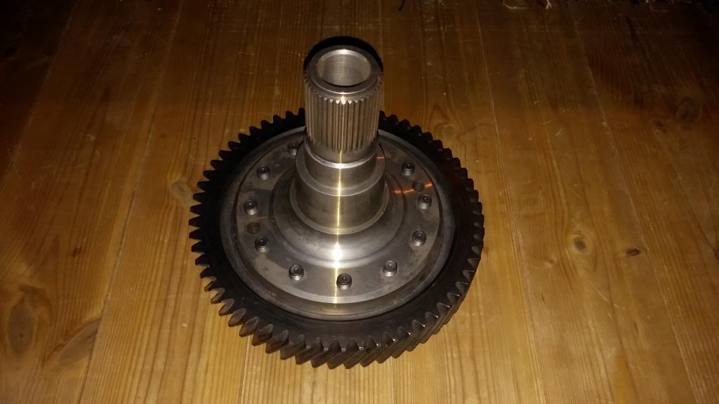

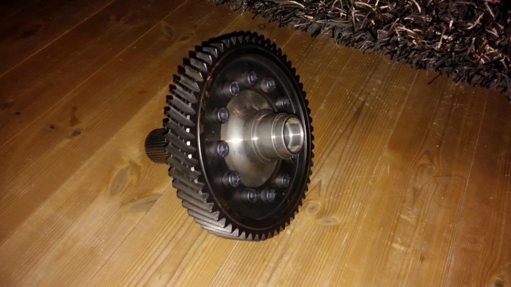

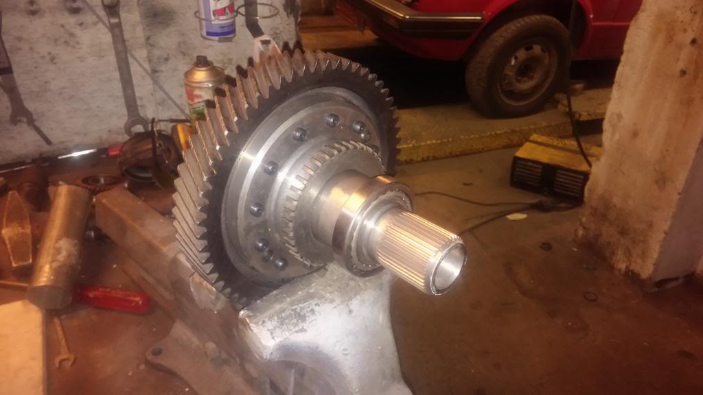

Also got my ATD Performancec output shaft back from machining (press fit pins between shaft and crownwheel should help keep it all fixed).
CAM00256_zps50e9af54.jpg​
So then it was time for final assembly of the gearbox
CAM00257_zps1f946547.jpg​
CAM00258_zpseaf19f17.jpg​

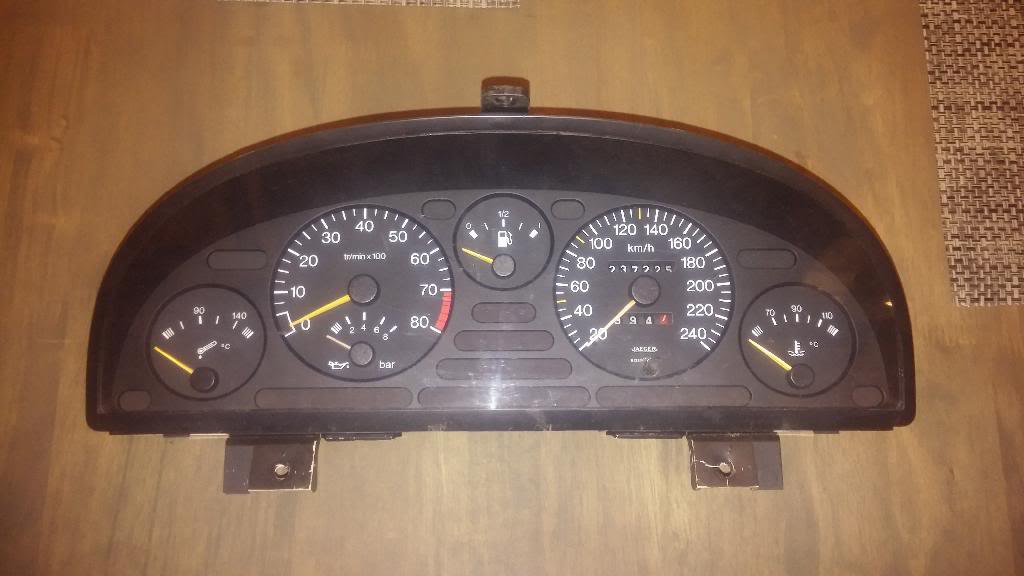

B1ack_Mi16

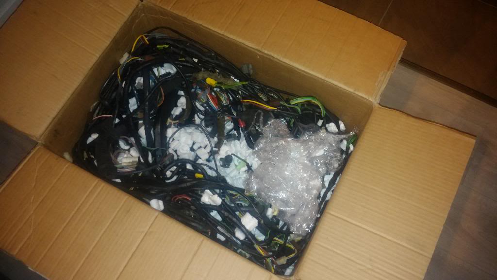

I also magically managed to hold of a complete car loom and electronic speedometer (these are T16 specific) from Edgar Hadicke in NL. He's been to great help!
Complete loom
CAM00260_zpsmiezkory.jpg​
Instrument (only T16 shows to 240km/t I believe)
CAM00261_zpsgb3auirf.jpg​

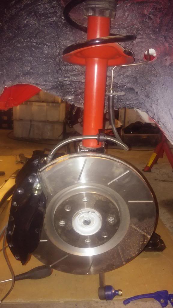

Brembos at front now with brake hoses connected
CAM00277_zpsda4c916a.jpg​

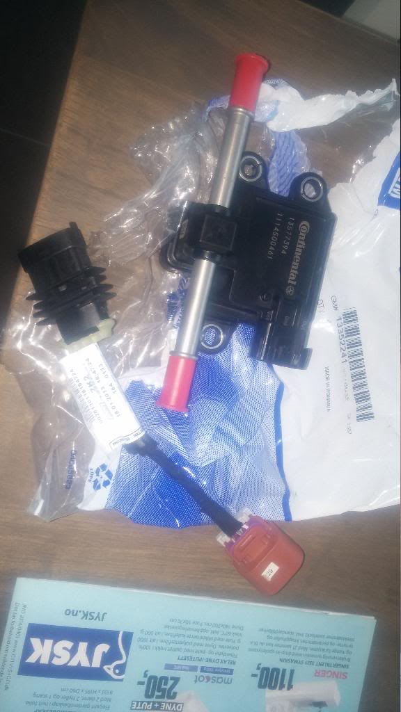

Flex fuel sensor arrived, will tell ECU the ethanol content of the fuel, hence beeing able to blend between 98 oct and E85 at whatever ratio possible.
20140401_180004_zpsxrhaook2.jpg​

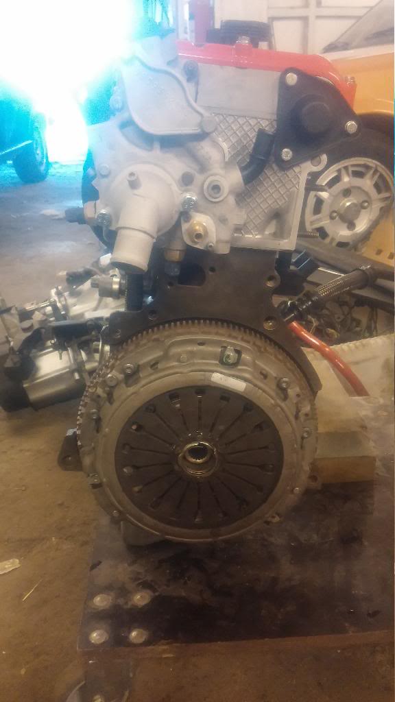

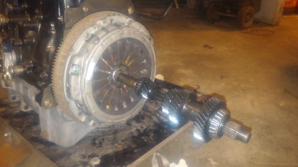

Trialfitting clutch plate
20140408_204611_zpsfe0a490e.jpg​

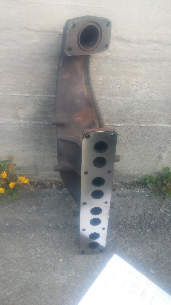

And had to get the exhaust manifold flange machined as it was really warped like a banana

Finally decided to start off with the standard clutch, mainly because I didn't find any better alternative. Hopefully it'll hold enough torque for a while :)
20140424_204852_zpsovp6c1p6.jpg​
