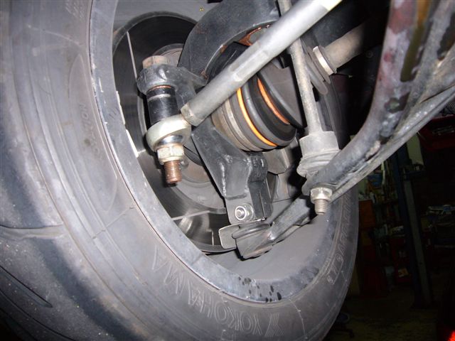

My car is now back on the road again with Roll Centre and Bump Steer correction kits on, with a new camber caster adjuster.
The Roll Centre Correction kit works fine and it gives a tad more -ve camber too. I have to agree that the camber compensation shouldn't be any serious issue since a lowered car may only have about 2-3 inches (or may be less) compression travel. But putting the theory in practice is more fun than experiencing the outcome sometimes :D
Probably the extra caster given really gives a good sensation when cornering. About 16mm extra caster has now been dialled in with about -1.2 degree of camber.

Fixing the bump steer is much easier, get a pair of male M14x1.5 rod end joint and drill out the hole to 14mm. get some nuts and washers ready to try will do the trick.
Correcting the wishbone angles can be a nightmare if starting from the wrong angle.
