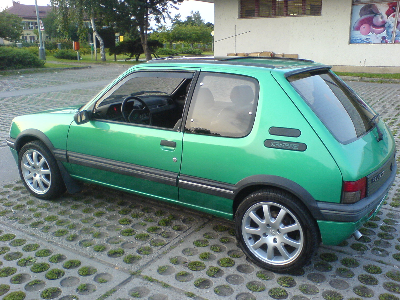

I want to introduce my car. Last year, I bought a gti and it was a limited edition Griffe. It was made 3000 cars (1000 for france without cat and sunroof, 1000 for holland and 1000 for germany, both with xu9jaz 88kw)
some facts: ABS, sunroof, central locking doors, power steering, full leather black seats.

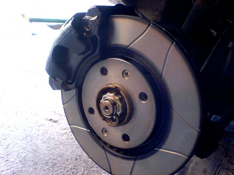

upgrades: front brakes from pug 206 2.0 Hdi 266mm Brembo max with Textar pads, MC 23.8mm from pug 406 3.0 V6, instrument panel from citroen bx gti16 with oil level gauge, pug 206 cc 16 inch wheels Ouragan fith 15mm spacers on front and 20mm on rear.
Next plans: mi16, paint job

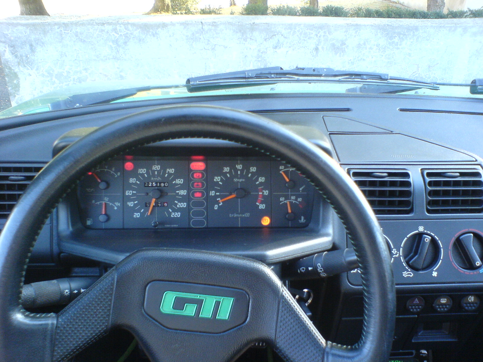

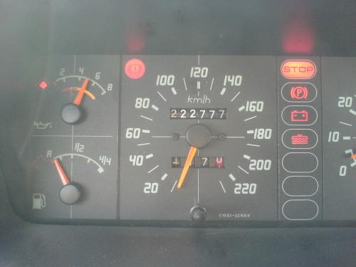

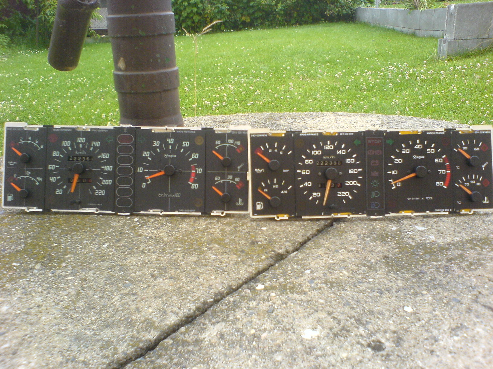

why would you swap the instruments over ?
what advantage is there ?
I've not heard of this being done before
any info

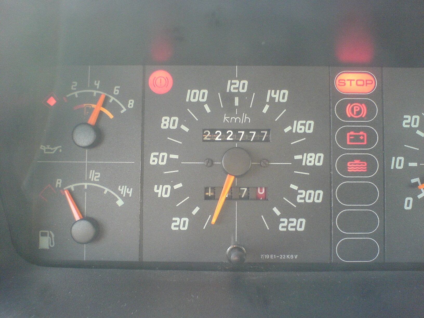

Is that the bx instrument panel you have installed in the picture above? Looks very nice, i've heard a few people do this but never actually seen one.

it lights green :ph34r: but oil pressure gauge is 2 in 1, when i turn on the ignition it measures oil level, after ten seconds it starts to measure oil pressure :)

The oil level is similar to a 306 then, i didn't think you could get this to work on a 205? Have you adapted something to make this work?

on XU9(8v or 16v) there is a hole in block with level meter, it is under the exhaust, BX instruments has little additional ele. circuit, you need only + and two wires for level meter and job is done

Looks very nice indeed, curious as how to how you got the oil level to work?

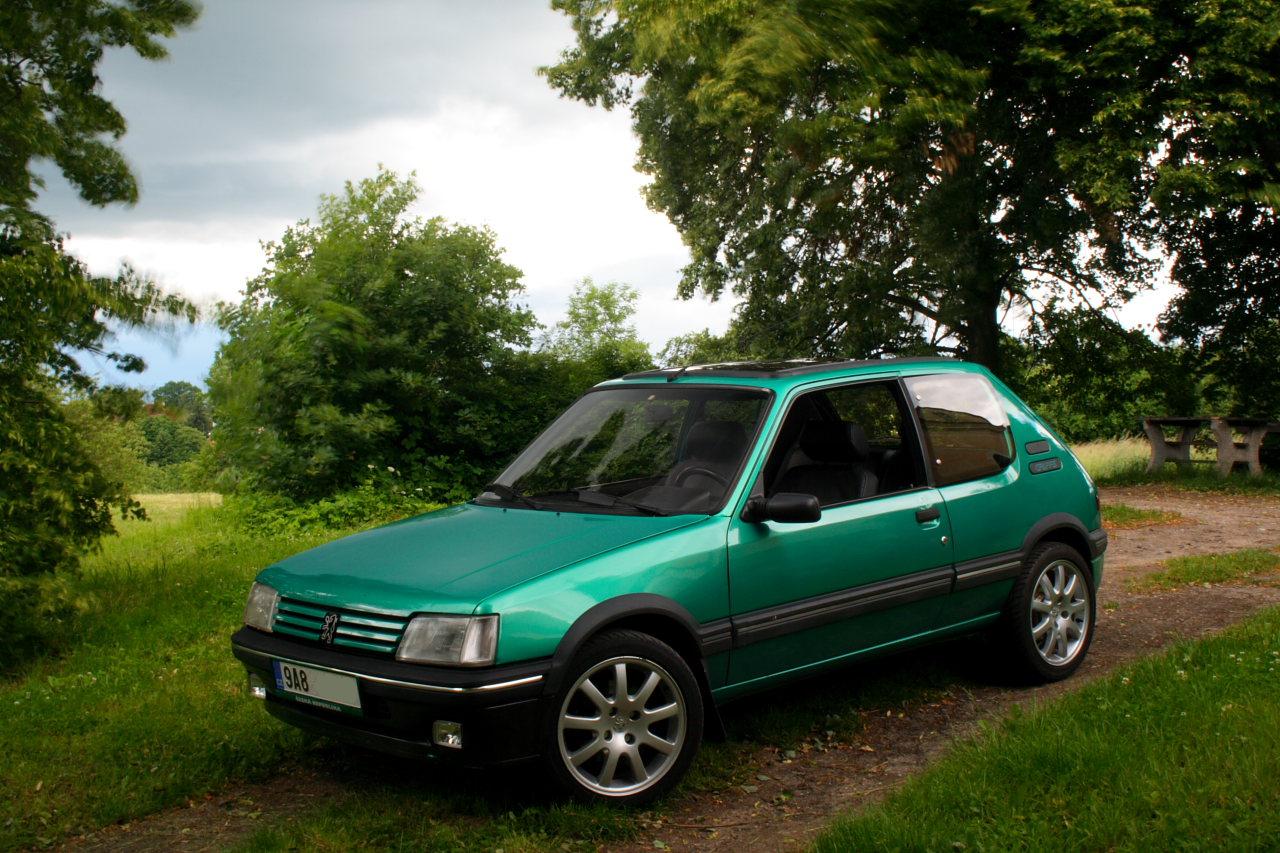

automatic hood after paintjob and wheels with new tires Avon ZV5 195/45 R16 :lol:

In the below pic it shows the car has had a bit of paint in the past, are you sure it's an original Griffe and not a black GTI sprayed green?
vinorak
car was crash in germany and repaired places are in black. Maybe it isnť griffe, but engine, abs and interior are from griffe :lol: In europe 90 percent of gti are puzzle...
